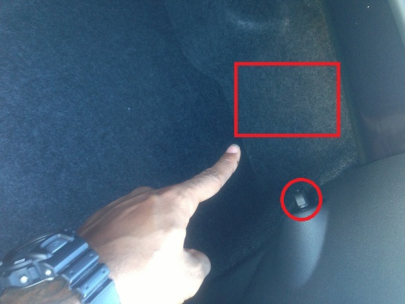

Location:
Fuse box is located in the trunk on the right side (passenger) behind the carpet panel. The fuse box is located behind the red square.

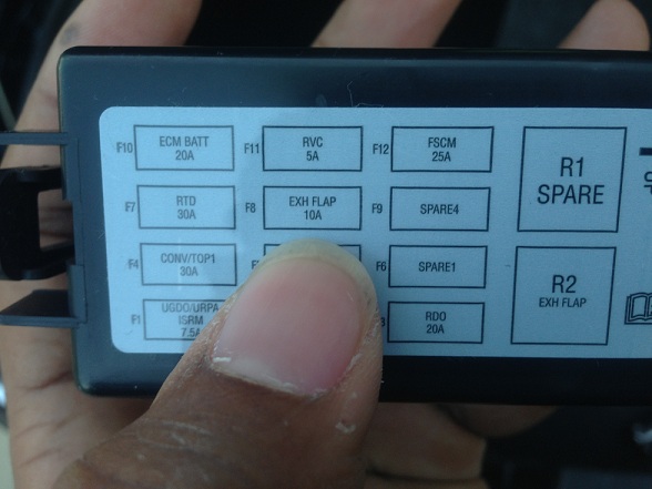

If needed there is a fuse puller located in the fuse box which is located underneath the hood. The fuse box is outlined in red.

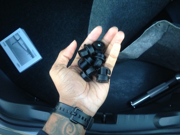

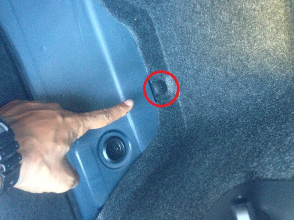

1. Unfasten (1) flat black plastic revit

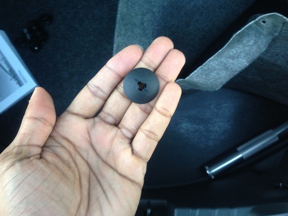

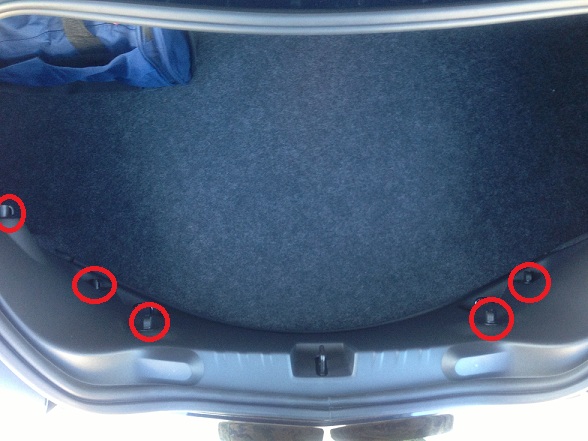

2. Unfasten (6) black plastic cargo net screws

4. Open the fuse box and locate F8. It should read "EXH FLAP" 10a. Pull the fuse with the fuse puller(located underneath the hood on the left side) if needed.
