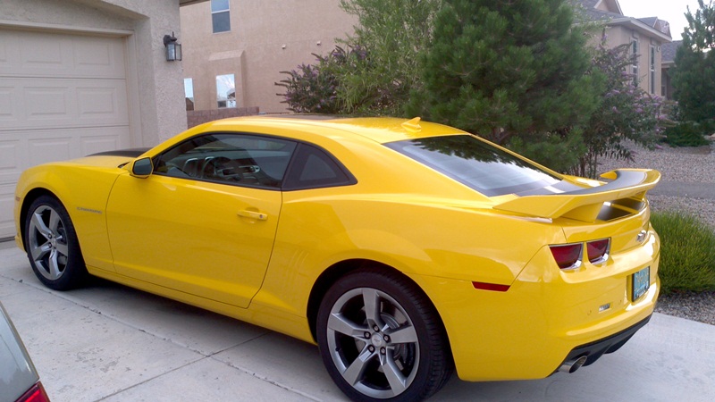

In with the "New"...
Here is my car a few days after I took delivery, outside the dealership, getting ready to receive its first modification.

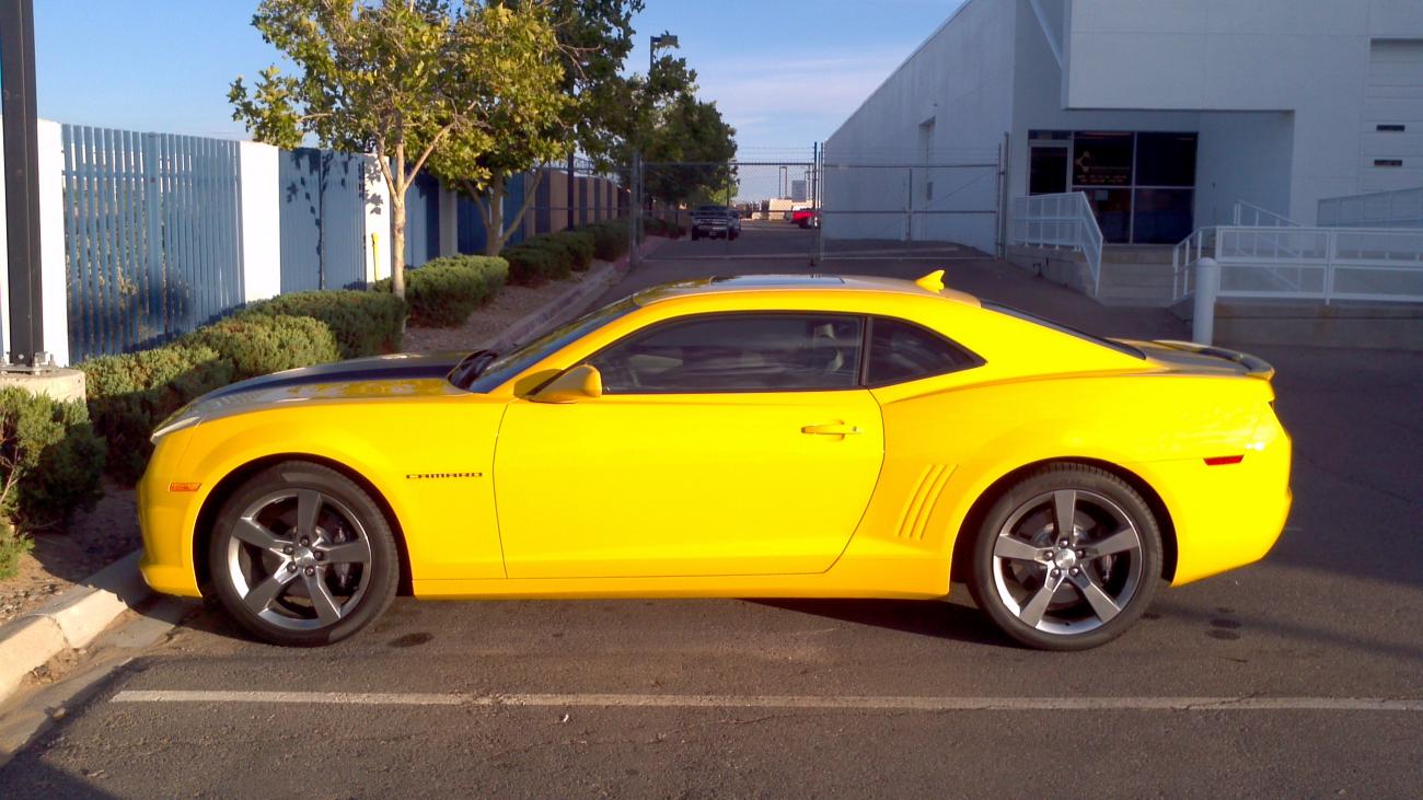

First of many mods...
The first modification is purely cosmetic. I just wasn't a fan of the tiny factory spoiler, so, off it came, and in place went a factory high wing, painted to match.

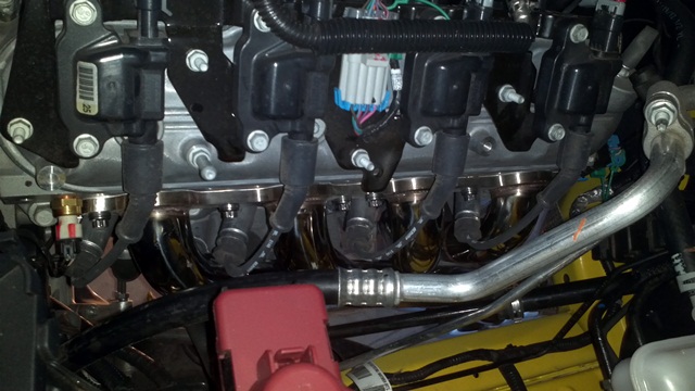

2nd Modification was in the aural department...
I thought the car was way to quiet for a muscle car, so I ordered a set of long tube headers. I had already performed the "cheap" muffler delete, but still wasn't happy with the lack of sound volume, and at this point all I had ordered was the long tubes, so I broke out the sawzall and cut the factory catalytic converters up. The headers came with some short extensions, so I spliced one of the factory cats into each side, then mated it all to the factory catback piping. Here are a couple of pics and a video clip.

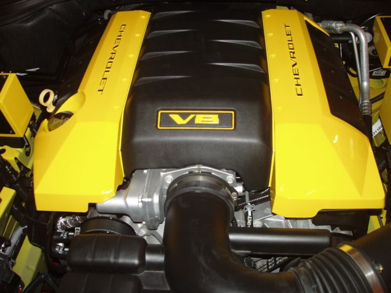

Mod 1.5ish
I forgot this mod...I painted the engine cover so it wouldn't look so dull underhood. It won't matter once the Whipple is in place

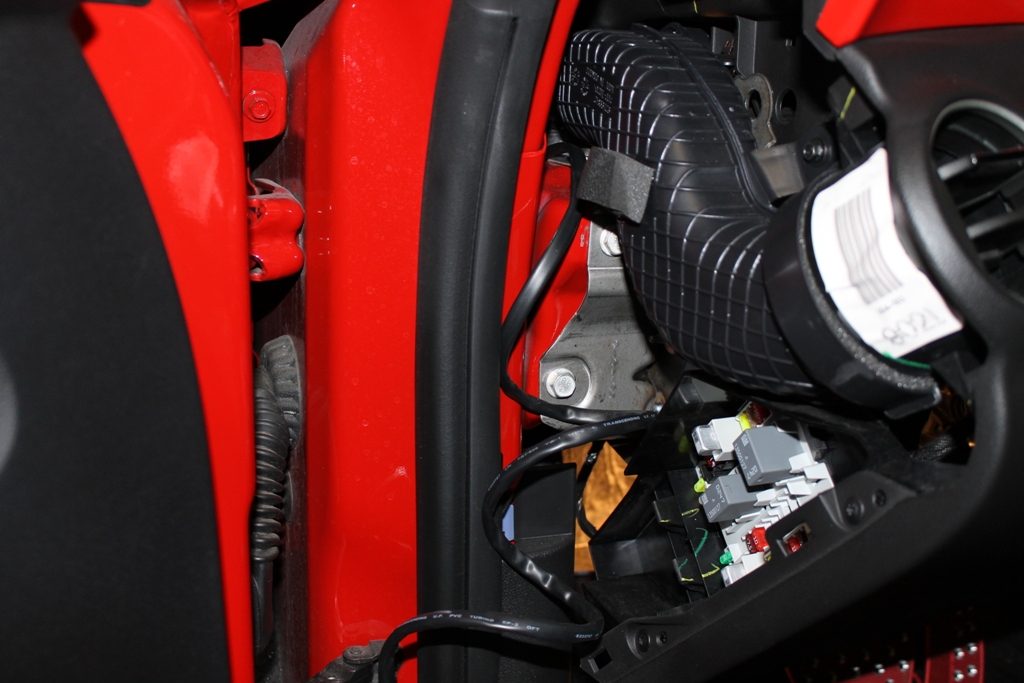

Originally Posted by AngelSpeedFreak View Post
Looks good man. Let me know if you need help with the install. I did my maggie over a weekend by myself and it really wasn't difficult at all.
Thanks for the offer, I will keep definitely keep you in mind. I think the hardest part will be pulling off the front fascia assy, and actually setting the SC/Intake/IC assembly in place. The rest should be rather easy. I figure it will also be a PITA to route the wires for the A-pillar gauges. What do you think?

A pillar wire for you Gauges is simple, here is a photo of the hole in the firewall next to the brake reservoir, then run it up the pillar when it's removed, also route the wire inside the fuse box in the drivers side dash cover!
