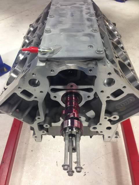

Move on to the engine
Now that we have somone on the car ,Its time for me to build the engine.
Out with the old:
While the original is getting disassembled I moved forward :
