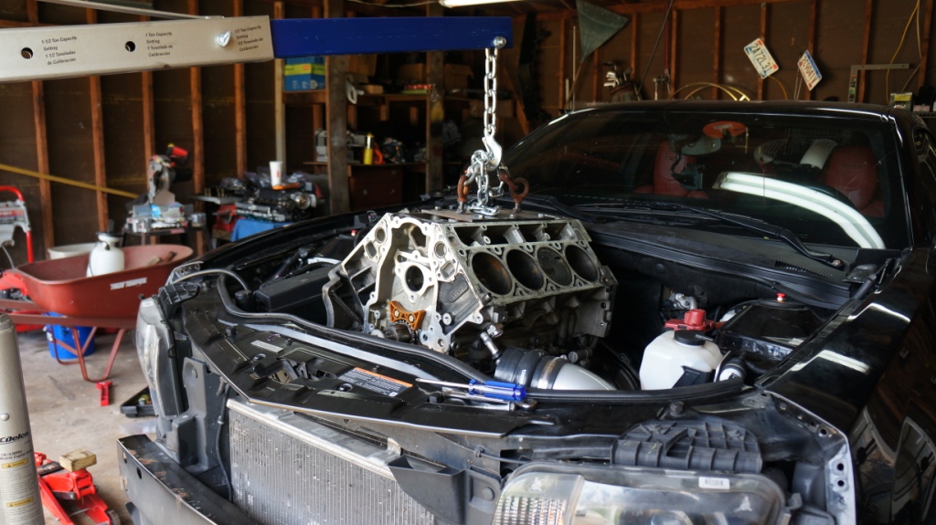

Ok, so some of you have followed my situation.
For those who have not, I had an oil pressure drop. Had a sensor error code so changed the sensor and put a Mechanical gauge on it too. No dice, still low oil pressure.
Did an oil change first to completely rule out a clogged up oil filter.
No dice, still low pressure.

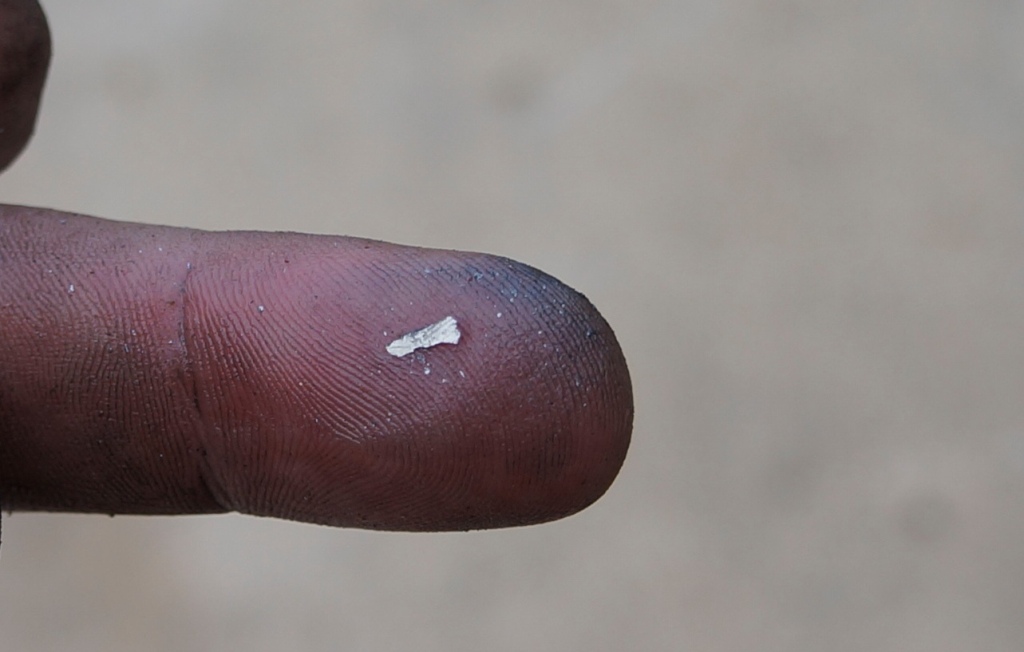

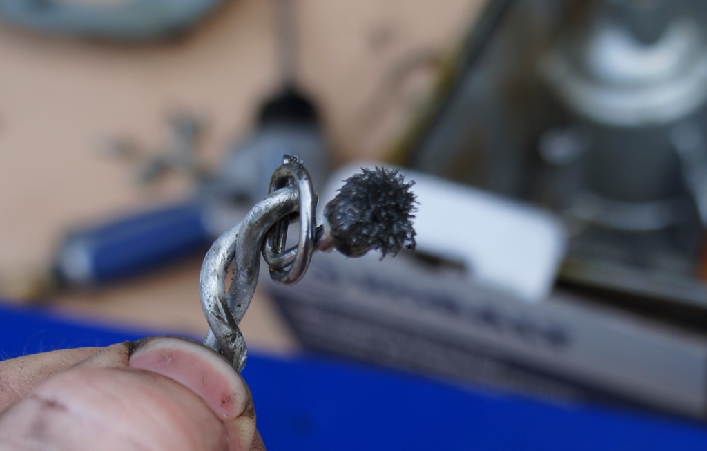

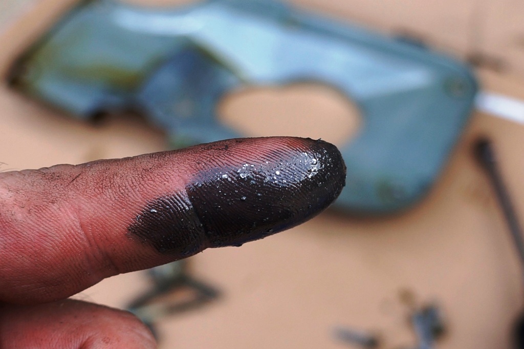

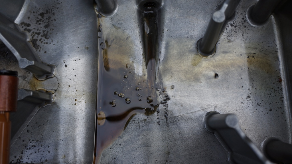

Cut the oil filter open and spread the paper filter and found these metal shavings pictured below.

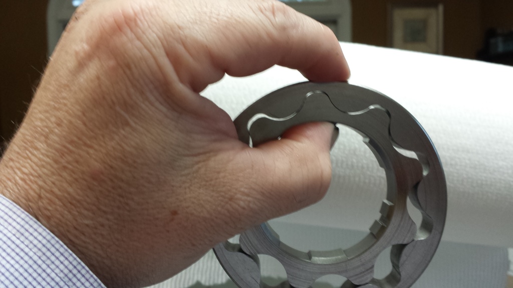

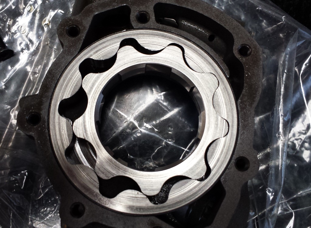

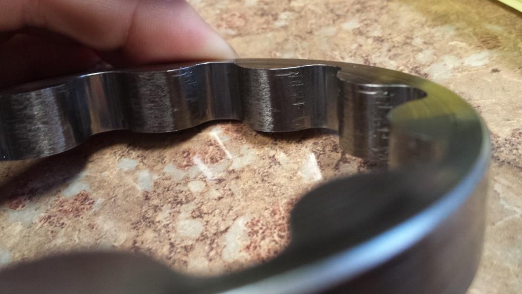

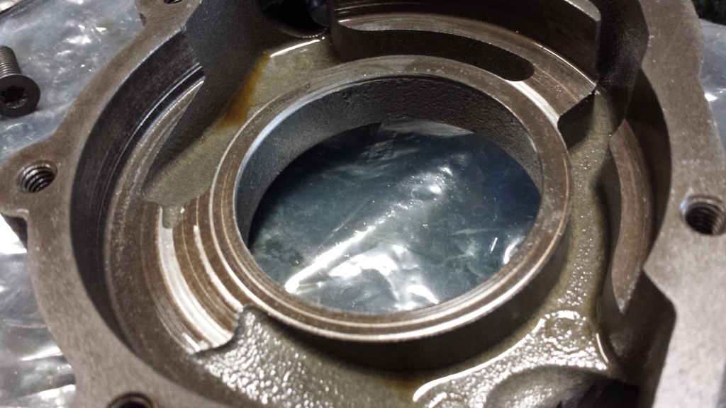

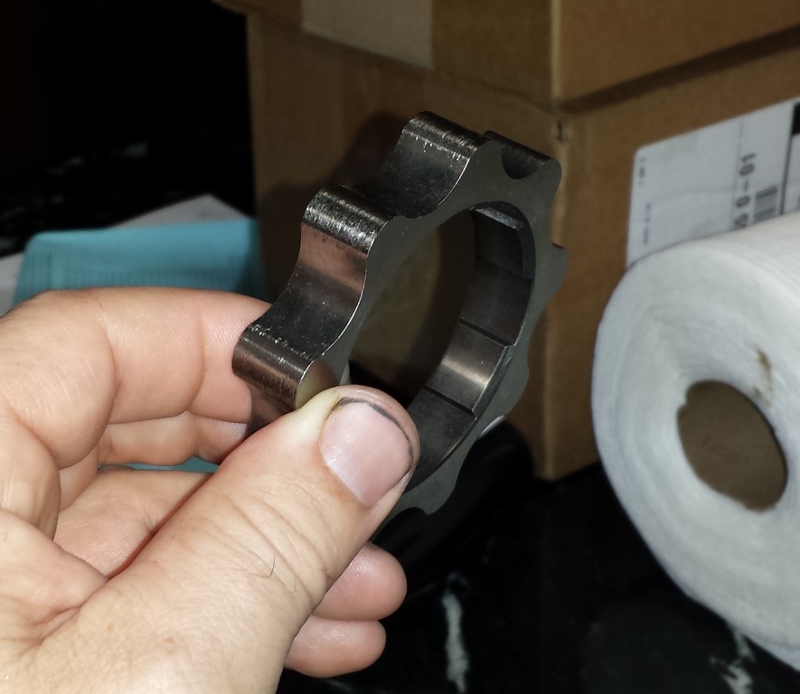

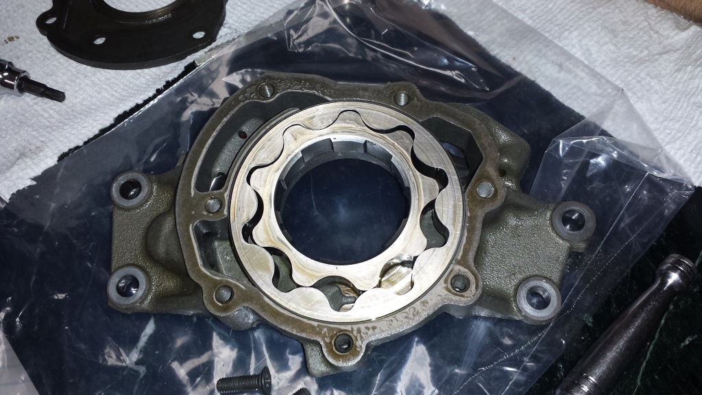

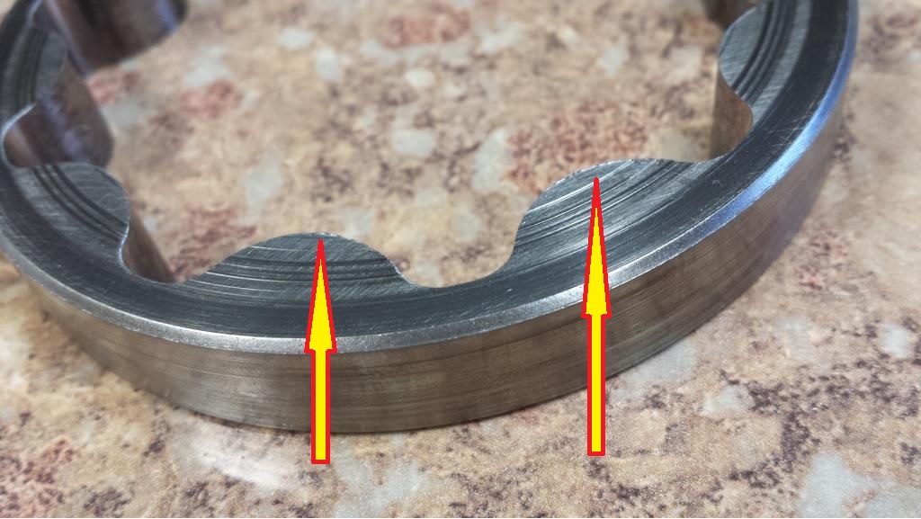

Thought maybe it was the oil pump chewing it's self apart. Either way the next step was to remove the pump. Got the pump off and saw that it was scraped up a bit but still was in fine shape to pump oil.
So I had to dig deeper to see where my oil was going.

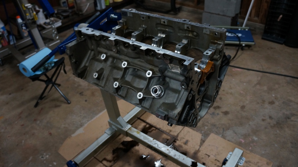

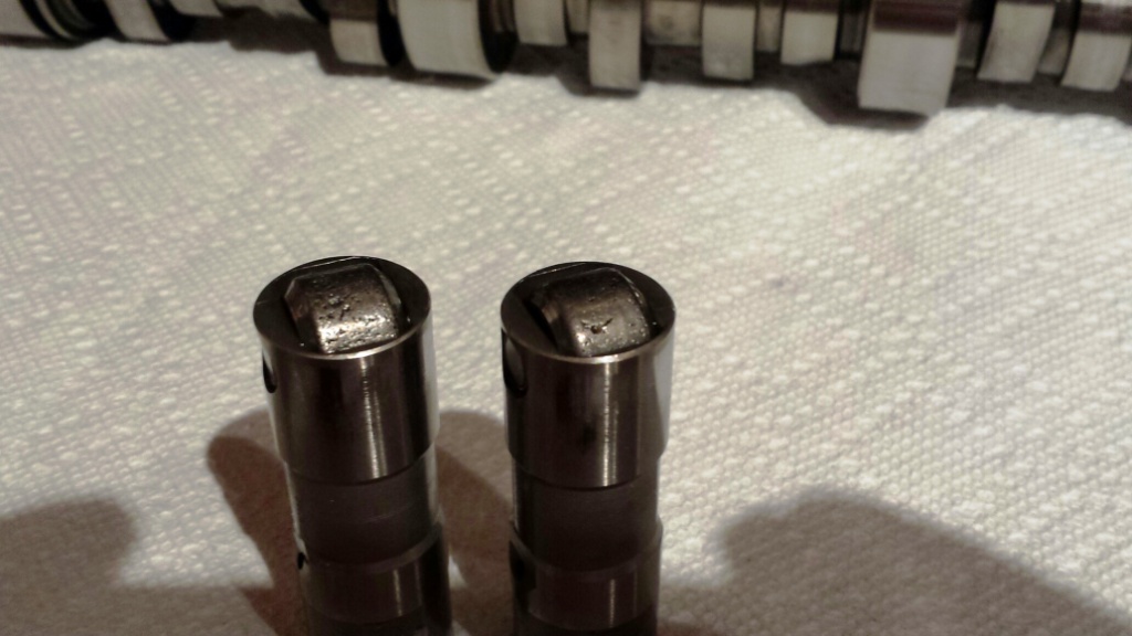

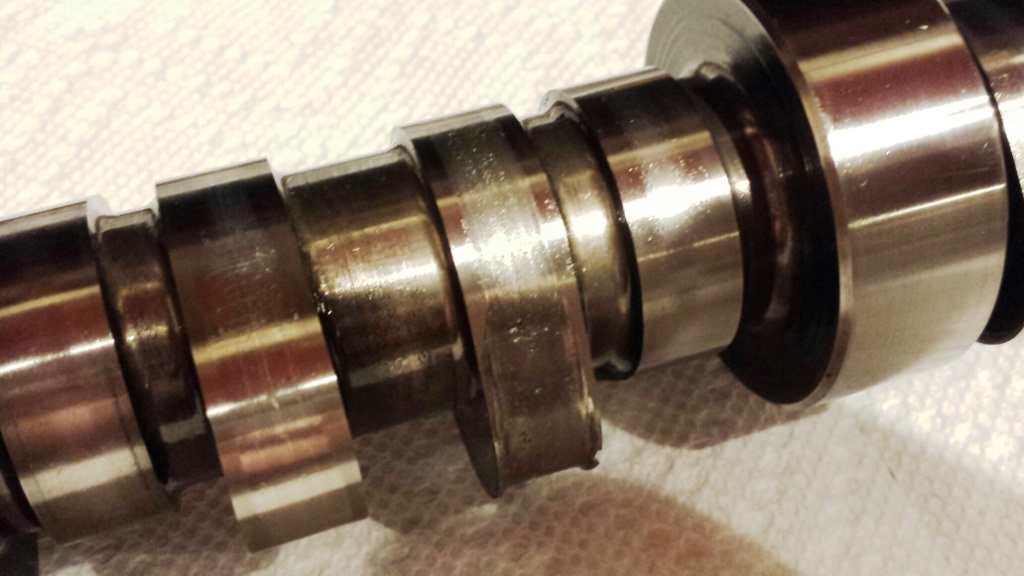

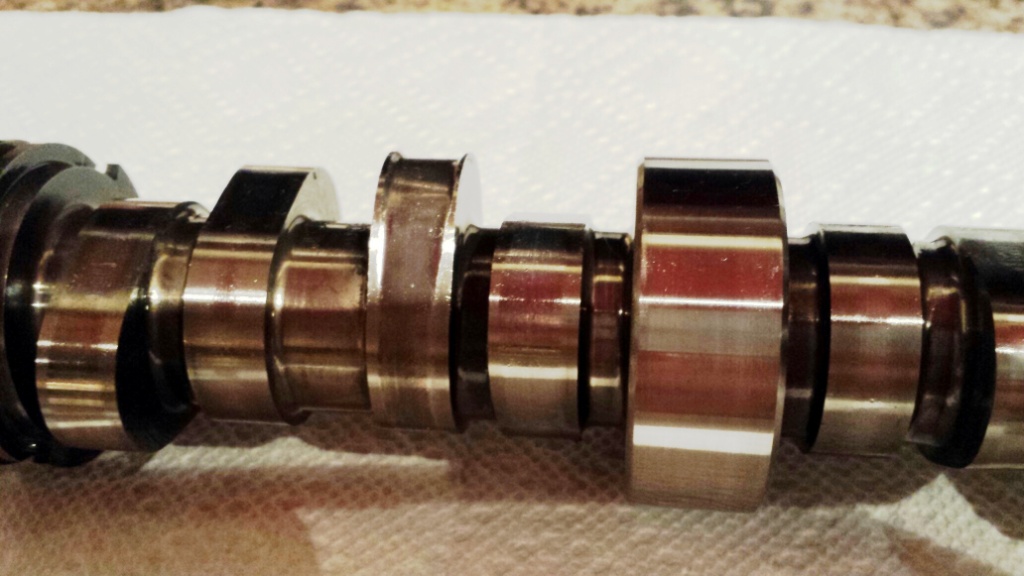

Well, I got the heads off and the cam and lifter out and discovered two lifters pitted and the lobes smashed. (pics below)

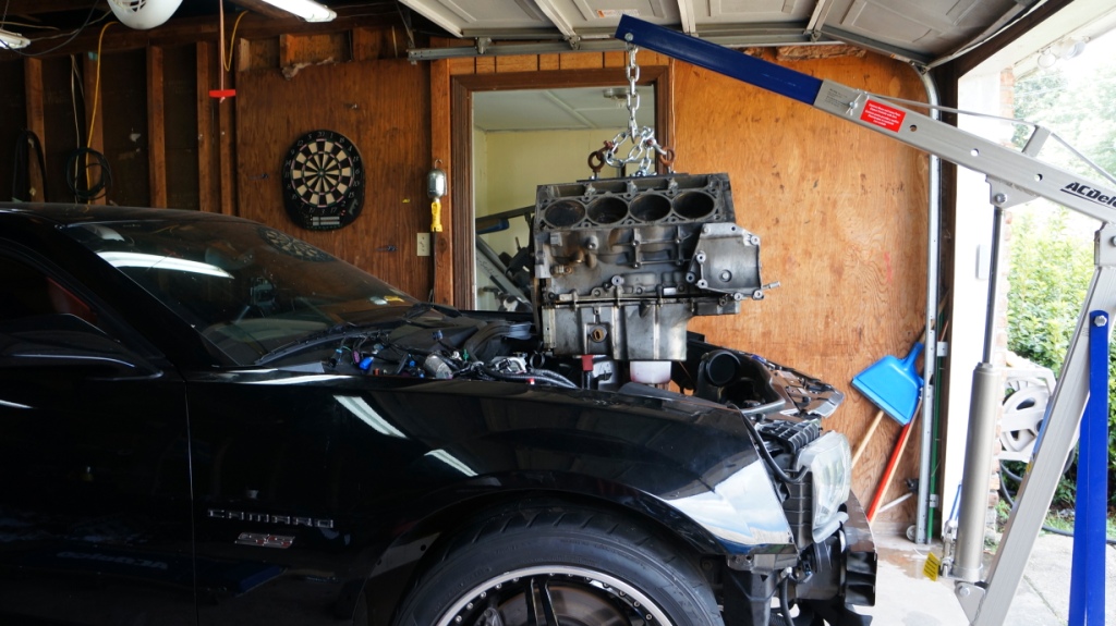

Still have to pull the engine to confirm or at least check to see if there was any damage to the rotating assembly in any way. No way to be sure where the chain of events started. And at this point where it stopped in the engine.
But with 90k miles on the engine and it broken down this far I know where it will end. NEW BUILD. Bottom up. I'll need new springs, lifters and a cam. Maybe some new valves while I'm there. Might go ahead and port the heads with Bo White.
But this is where you guys come in. Advice, tips, thoughts, etc........
Ideally I'd like to get this done for 5k or less. But I want to build it better than it was before so that is unrealistic. Especially having to buy the new valvetrain parts.
I could go to a salvage yard for a short block....
Anyway .........

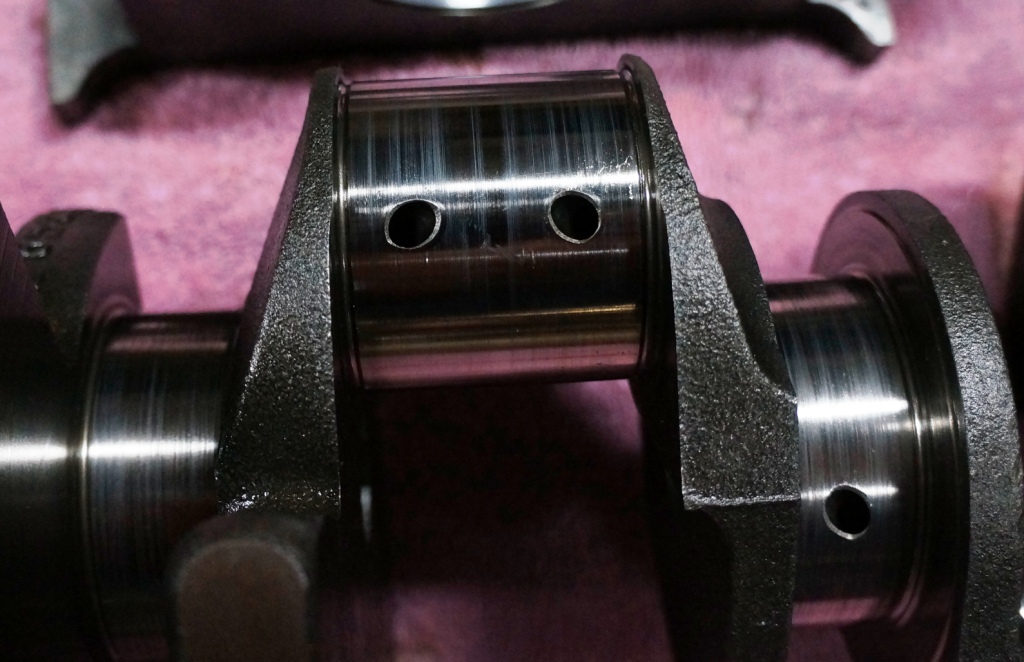

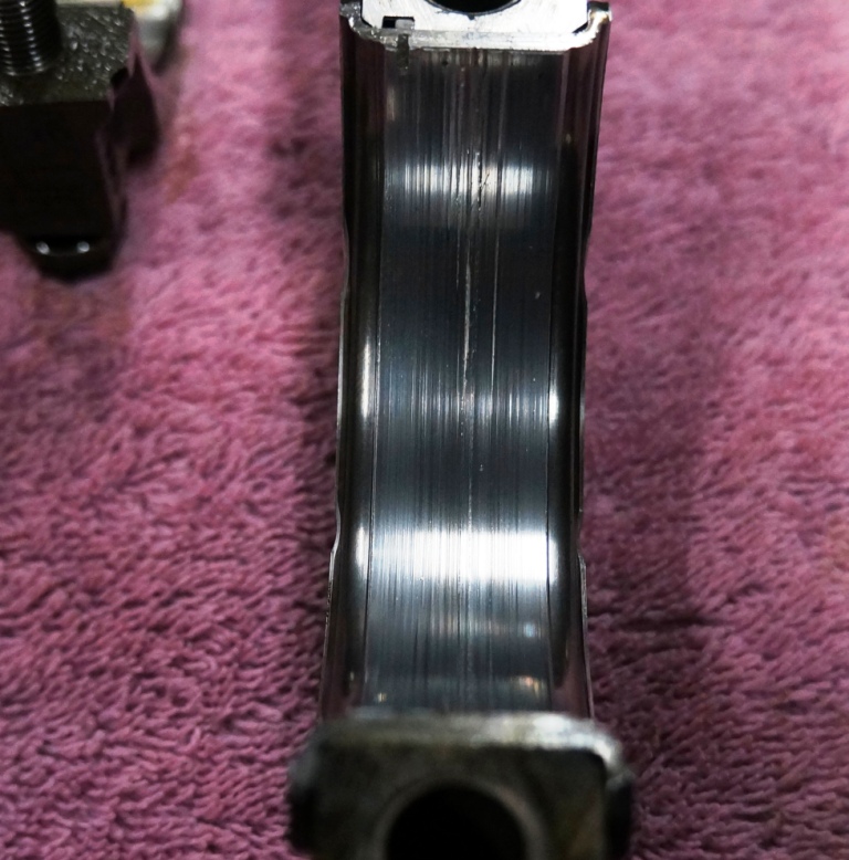

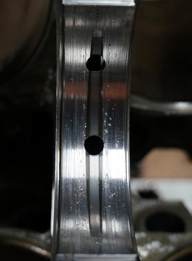

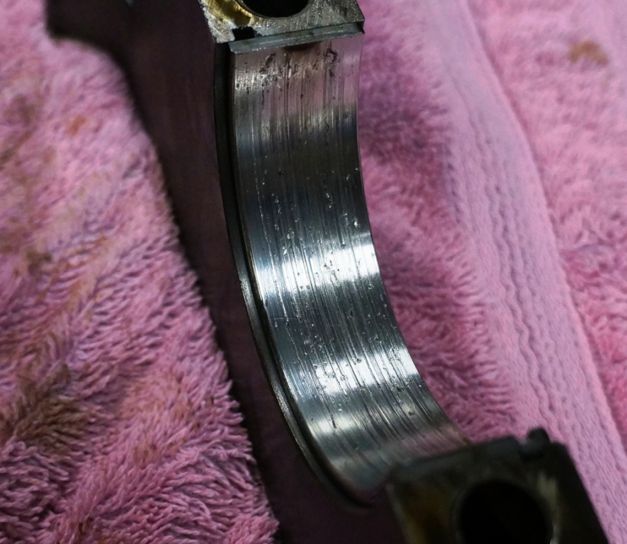

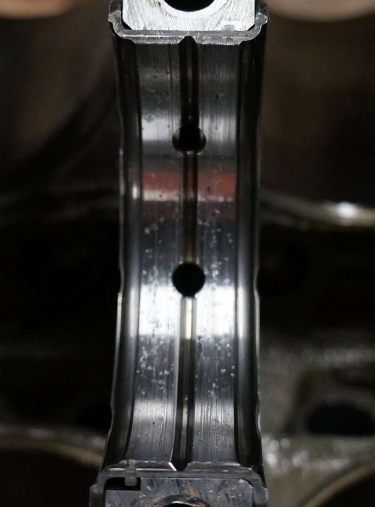

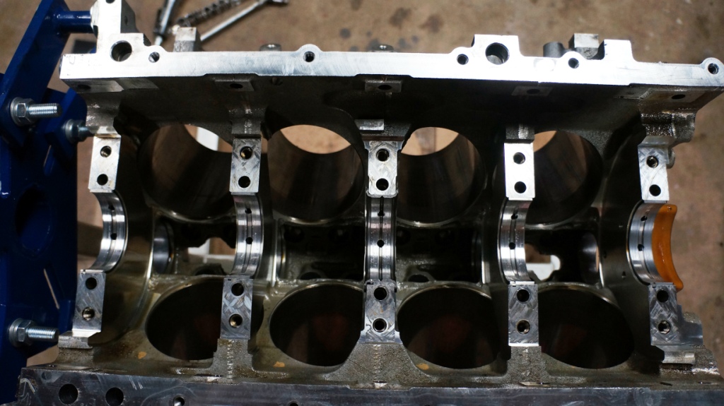

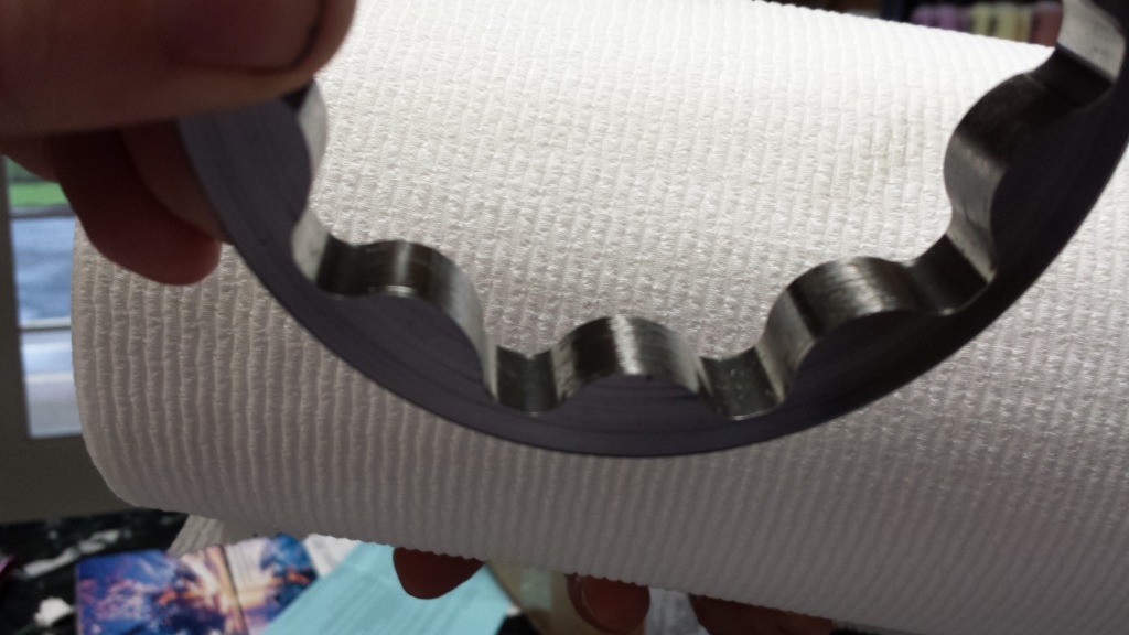

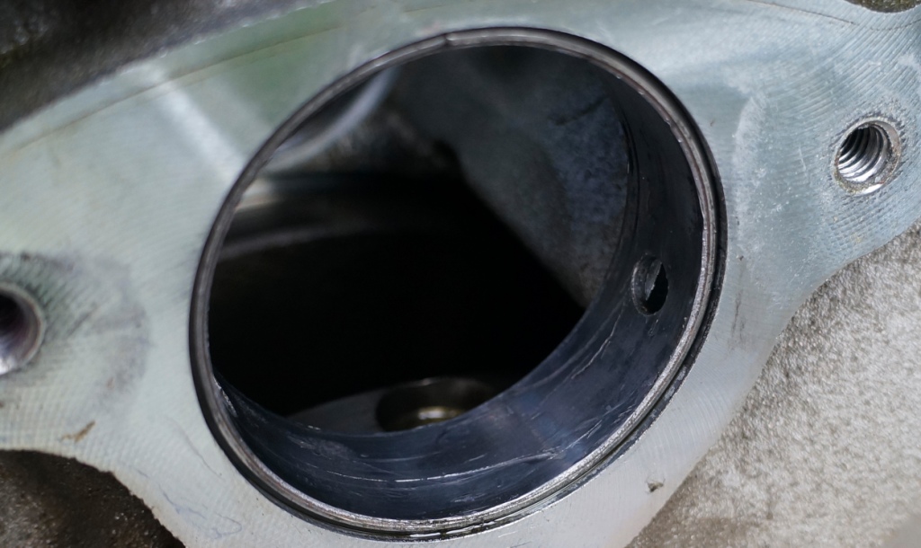

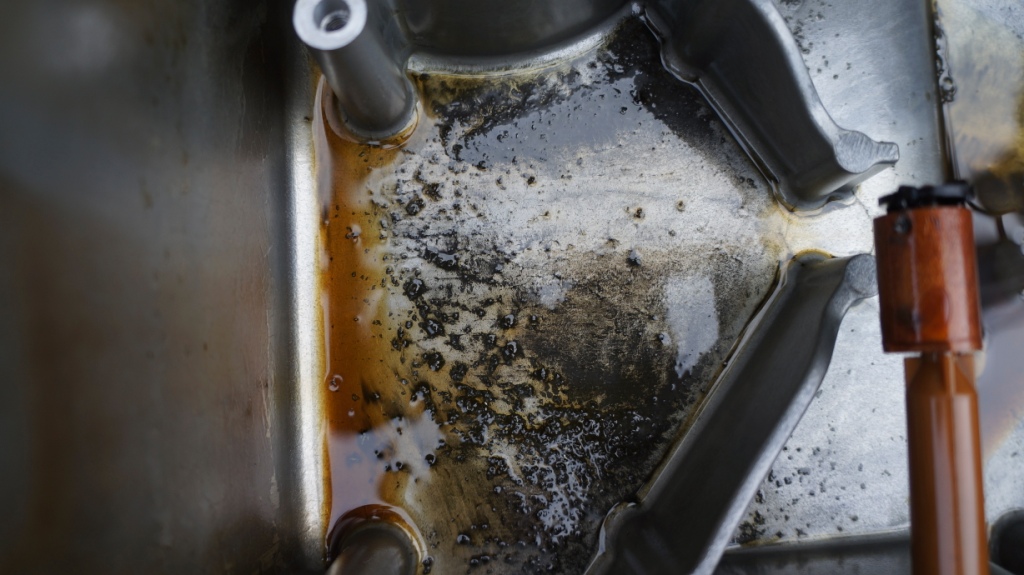

I could not find any place that showed evidence of the kind of oil pressure loss that I had.

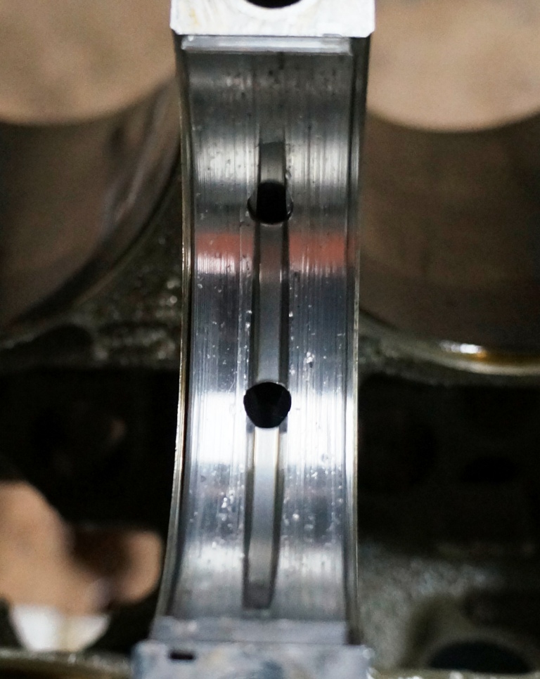

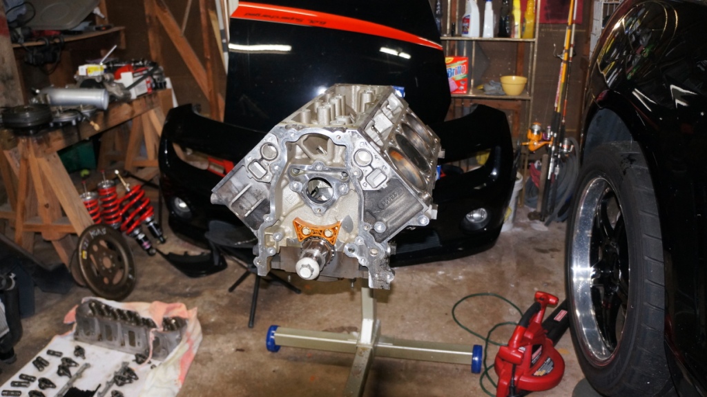

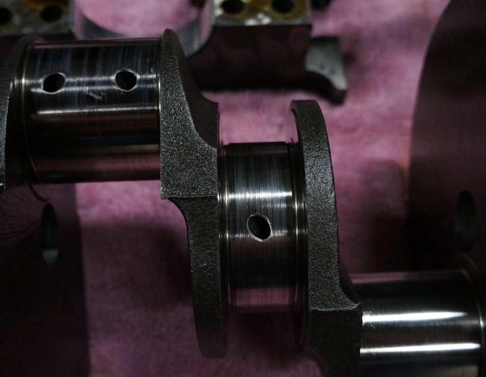

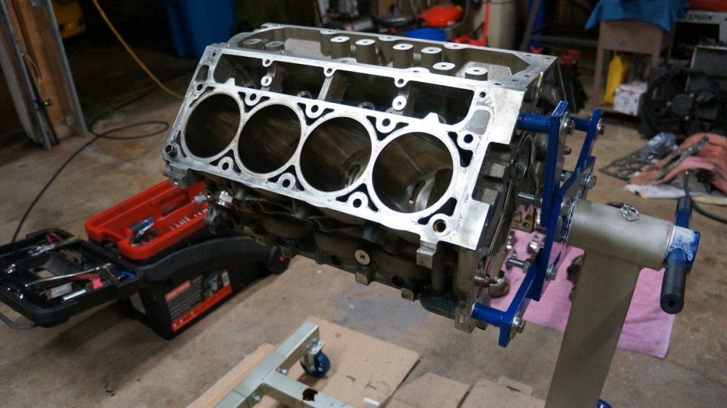

Rotating assembly looks fine but I'm not sure what to look for unless I disassemble it.

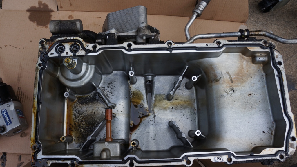

Anyway, here are some pics from today.
Keep in mind the engine had 95k miles on it.

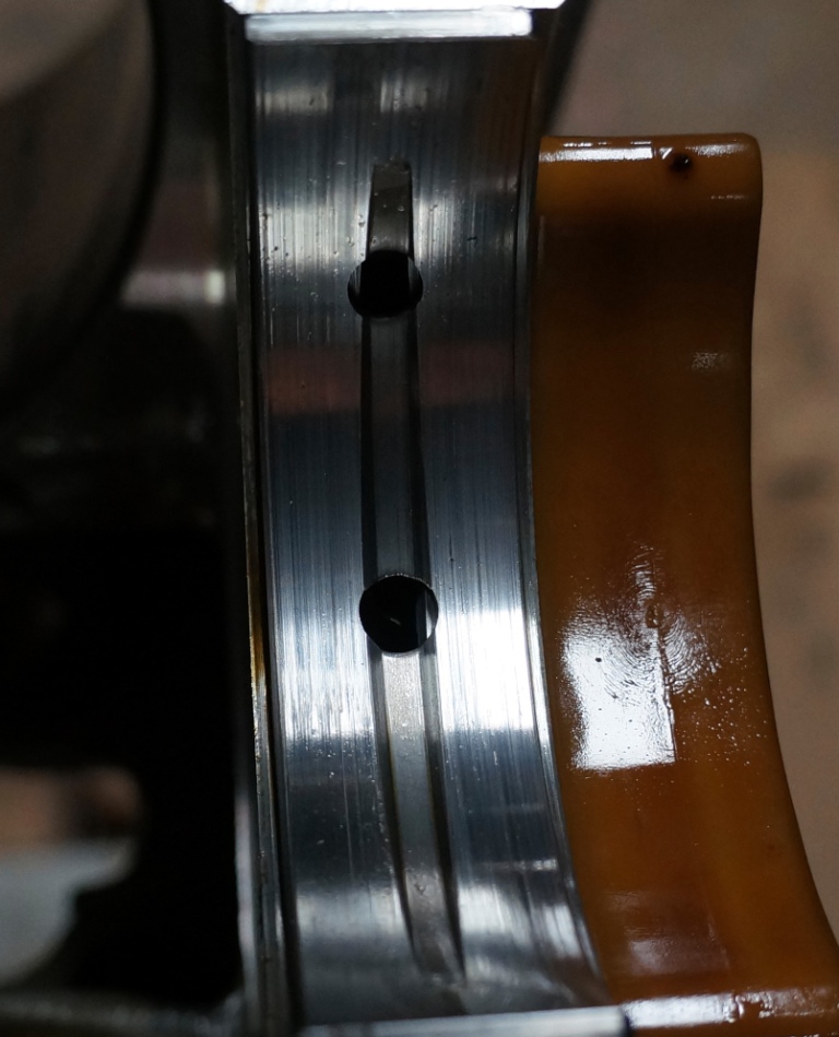

Only three of the main cap bearings came up not blurry.
All 5 bearings came up on the block.
Few pics of what the typical wear seems to be on all of it.
I'm still not sure I found where the oil pressure was lost.
What say you guys?
