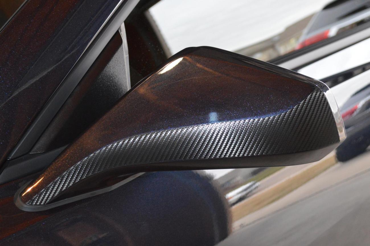

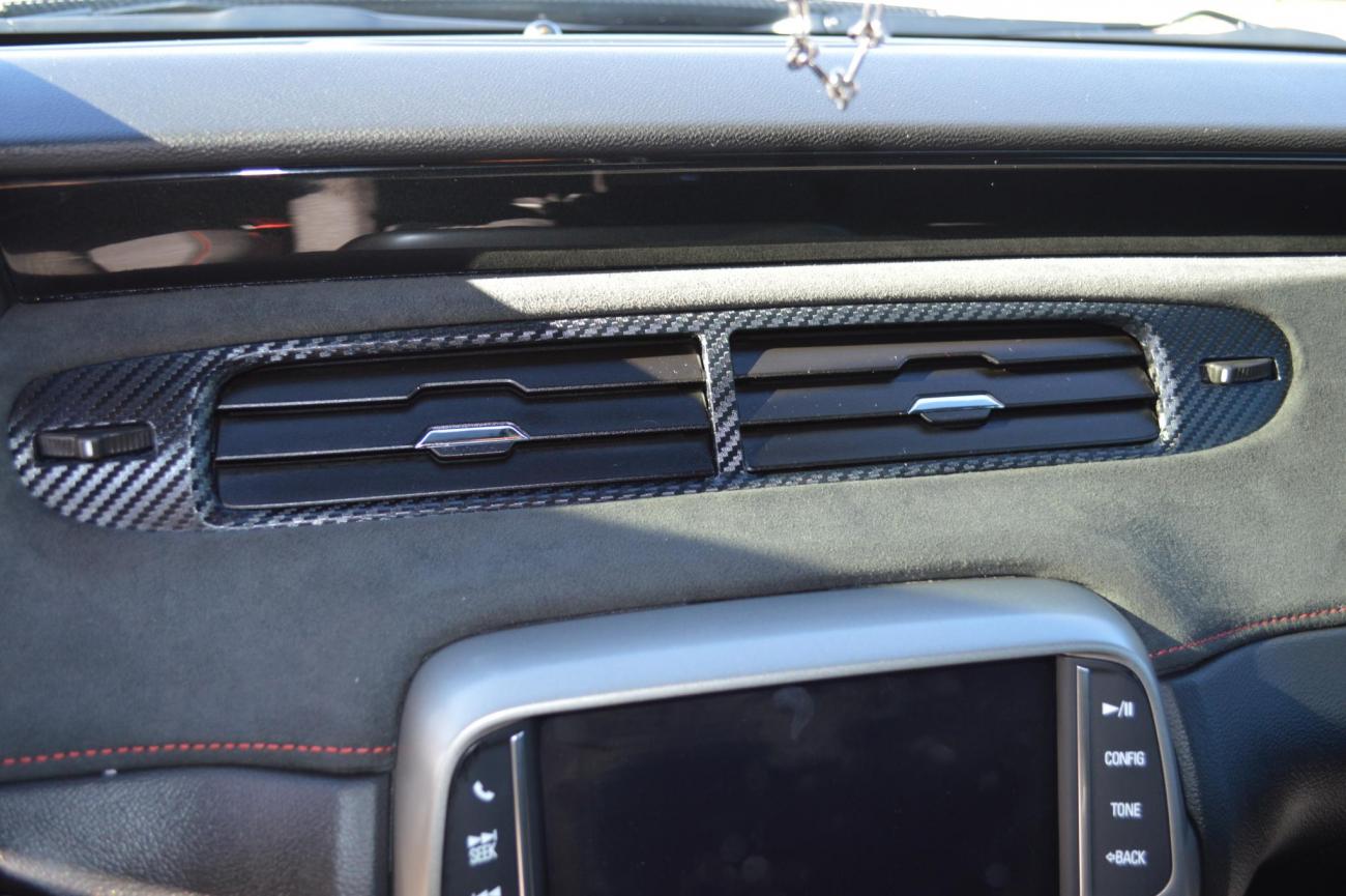

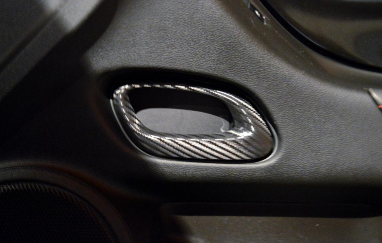

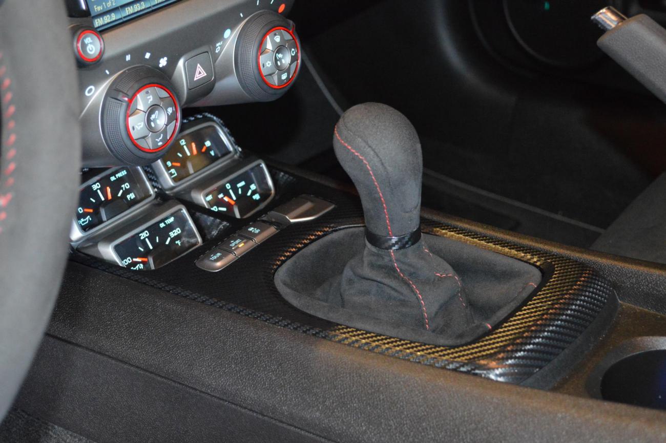

Since I told my wife I wasn't going to mod the car for a while I decided to do some vinyl work using carbon fiber 1080 scotch-print to give it a different look than anyone else, as well as tinted taillights & side marker lamps.

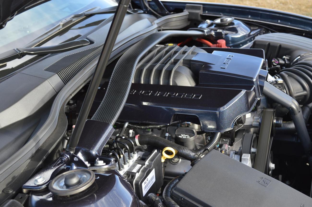

After the vinyl work was finished I went on to do some paint work! I paint matched the Engine cover, strut brace ends, & the GFX. Needles to say she was beginning to look like a totally different car IMO.

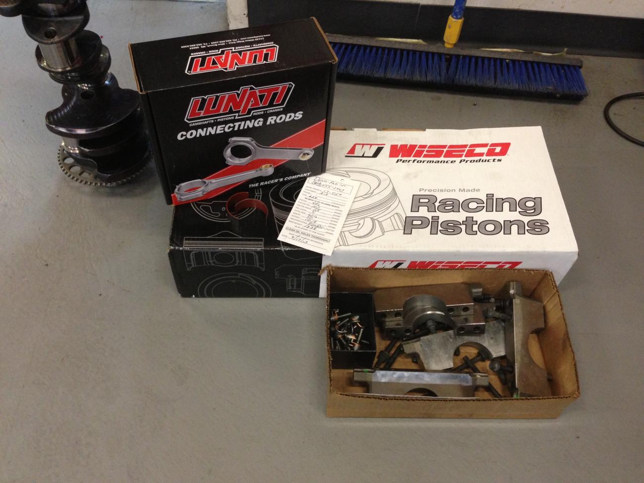

Well i was only content with the cosmetic work and the STOCK HP for about 6 months..... I then decided to jump deep into the modding after saving up a decent amount of mod money! So I then went down to American Intense Racing in Arvada, Co to talk to the owner Clint Baxstrom and see what we could do with the money I had saved. Needless to say we came of with a plan that was a little scary to me at first considering the car only had 3500 miles on the clock. But after some thought I decided it would be worth while and dove right in.
We decided to build a complete forged motor!! With a few extra goodies to set it up for some big boost later down the road! Here is the mod list to date and a few pics for Candy!
1. METCO PULLEYS: 2.5 UPPER, 100MM IDLER, EXTREME DOUBLE BEARING TENSIONER, & SOLID ISOLATOR COUPLING
2. HEADERS: STAINLESS POWER 1 7/8 PRIMARIES & HIGH FLOW CATS W/ 1700* MATTE BLACK COATING
3. CAMSHAFT: AIR CUSTOM GRIND COMP CAM E-MAX, 3 BOLT CAM SPROCKET, W/ UPGRADED TIMING CHAIN
4. VALVE SPRING KIT: COMP CAMS DUAL VALVE SPRING KIT W/ TITANIUM RETAINERS, COMP CAMS CHROMOLY PUSH RODS
5. HEADS: PORT & POLISHED W/ 5 ANGLE VALVE JOB & ARP HEAD STUDS
ORIGINAL CFM WAS 308 NEW CFM IS 340
6. INJECTORS: FAST 90LB/HR INJECTORS
7. COOLING: 160* THERMOSTAT
8. BELT: GATES K080653HD GREENBACK
9. OIL PUMP: MELLING HIGH VOLUME OIL PUMP
10. RX CATCH CAN
11. PISTONS: WISECO FORGED RACE PISTONS
12. RODS: LUNATTI FORGED RACE RODS
13. CRANKSHAFT: STOCK GM FORGED CRANK
14. COMPRESSION: 10.2:1
15. COLD AIR INDUCTIONS CAI ON ORDER
It is being tuned on 91 Octane for now until I get the Squash fuel system then will be tuned for E-85 as well!
Numbers will be posted soon!

Very much appreciated! I have put in over 30 hrs of meticulous labor getting every detail right with the Carbon fiber vinyl!

How easy was that Carbon Fiber install? That looks amazing!! Also, how is holding up with time?
King Leonidas is offline   Reply With Quote
Old 08-15-2013, 11:16 PM   #11
PWRHSEZL1
PWRHSEZL1's Avatar
Drives: 2013 Camaro ZL1 #2419
Join Date: Jan 2013
Location: Weatherford, Tx
Posts: 289
It's fairly simple, it just takes patience and and lots of time! I run a Vinyl wrapping & plastidipping business and like I tell all my customers vinyl will last as long as you want to take care of it properly! On average though you're looking at about 5-7 years for exterior and 7-10 for interior!
