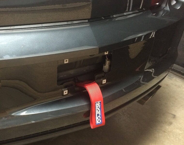

For the rear I plan on using a soft strap from Safe Quip. I might use the a hole behind the lic plate area to access it while on track (leave the plate off and hide it while on the street)...I will have to modify the high density foam behind it to access it.

He did it that way cause he uses that belt like strap in post #6 to be towed.

The belt strap is actually mounted to the rear bumper. Exposed on track days and hidden behind the plate when not in use.
