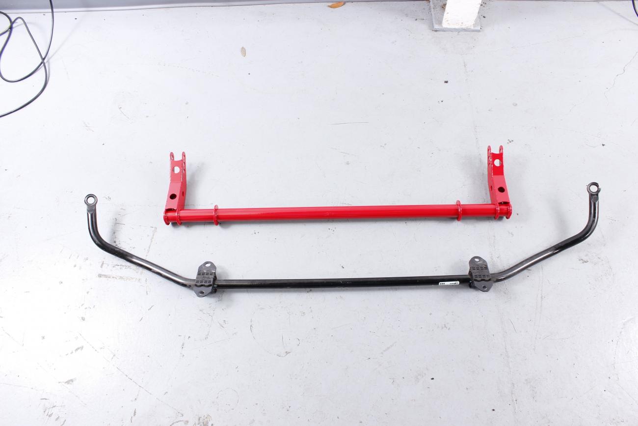

Here's a couple nice comparison shots of our Drag Race components compared to their OEM equivalents.....
