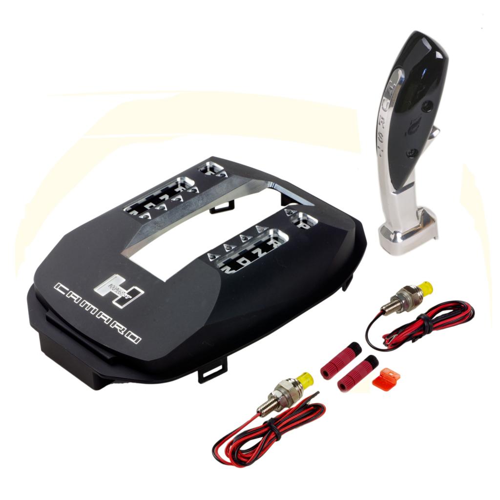

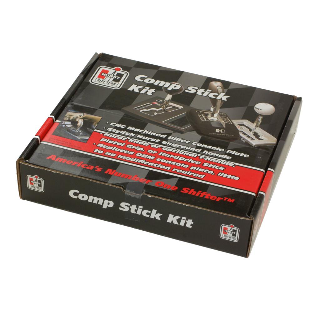

This is pretty much how the box came:
And the contents:

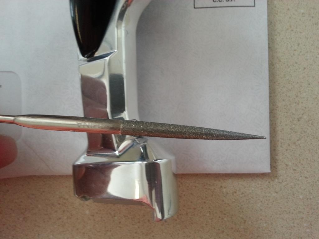

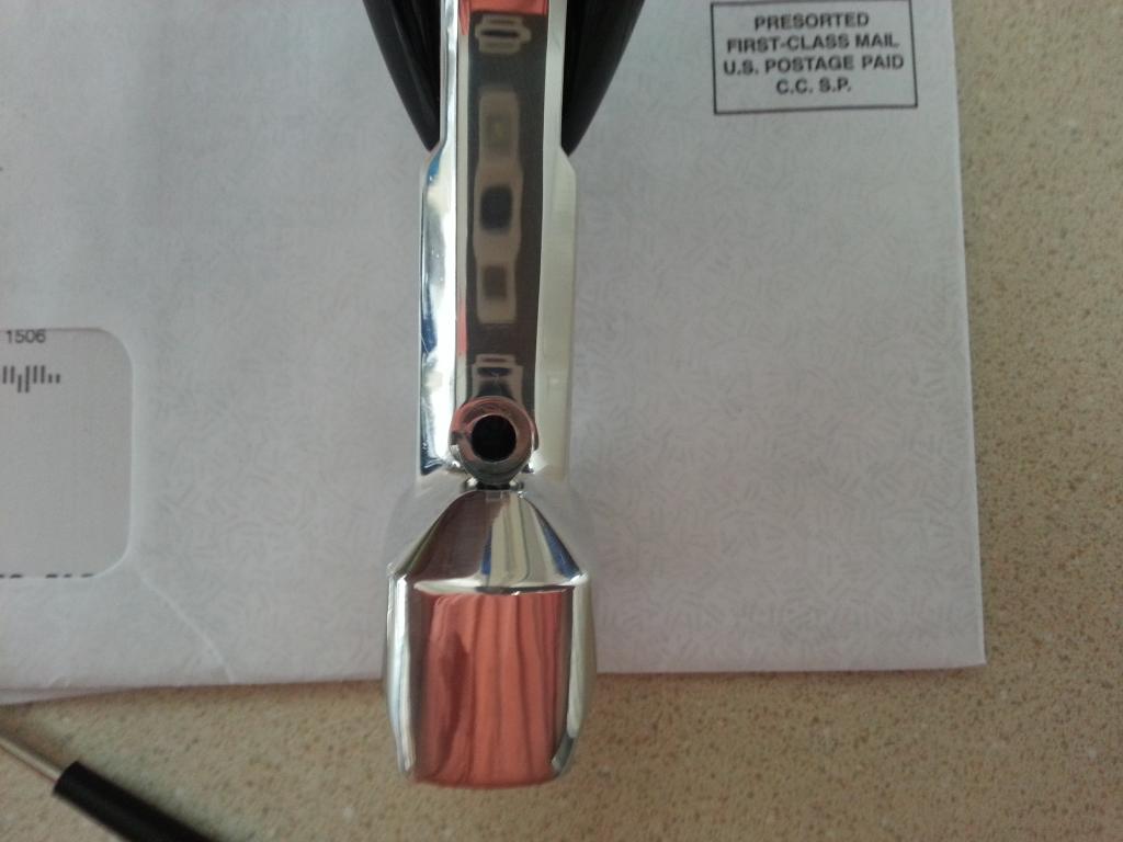

Once I finshed the Plate, I started to put on the HardDrive knob. That's where the issues began. What I found is the hole in the Knob was about .002 off. I could NOT get the screw in. What I also found was the bolt relief machined in was not big enough to allow the screw to account for the difference. What I had to do was use a fine 'file' and open the hole up a bit and then file out the relief -- this took trial and error until I was able to get the bolt to fit (snug for sure, this won't back out!).
So, here is the front of the knob/handle:
And the file I used:

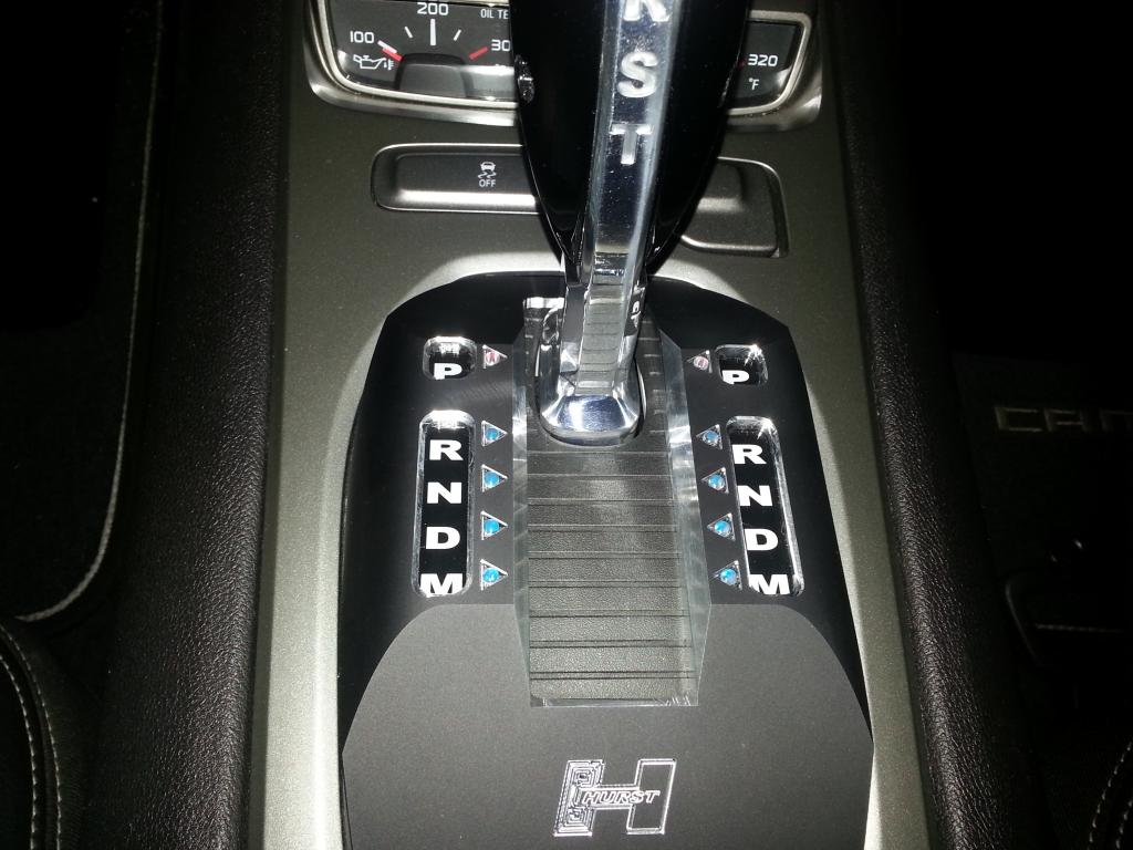

Now, here is the finished product!
Woo hoo:
Love the difference and the feel. The ABL's look awesome and I'll get a pic of that tonight and post it here later...
Do note I need to clean the plate and handle -- those are not scratches ;o)
