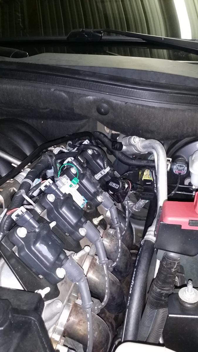

Thanks for the how to. Helped things go quicker.
I just got done installing mine. I did not have to trim anything and mounted it in a little different spot. Very quick and easy mod.

That's a good spot! I couldn't with the strut bar and now going SC so I had to go to the right side. Glad it worked out for you! Where did the oil wind up on your stick? Do you have a pic of that?
