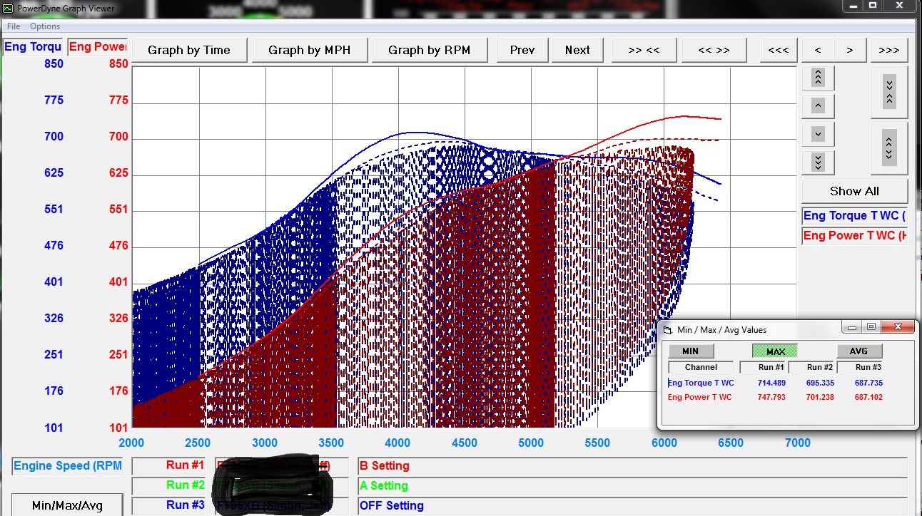

Here is a before and after photograph of the car, along with the dyno sheets. Don't mind the dent in the drivers side quarter panel, it was fixed months ago.
AGP TT kit, 54/57 Forged rotating assembly, Custom grind cam... Dual nozzle meth, ID850's, Livernois dual fuel pumps, ECS BAP, 25% UDP, 3 inch Magnaflow catback with X pipe, Mantic 9000 clutch, DSS 1000hp axles, DSS aluminum driveshaft, ZL1 rear end, solid subframe bushings, HE differential offset bushings, BMR Trailing arm, BMR toe rods, Lingenfelter LNC-2000,SJM Line Lock. 747 whp 714wtq

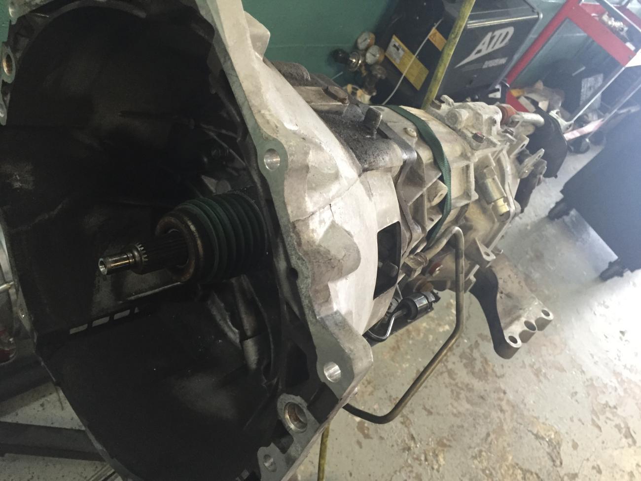

yesterday they took out the axles, Drive shaft and transmission along with tearing the valve covers off for the new dual valve springs.
Today the car was all tore down ready for the rest of the build, they finished the dual valve springs but tomorrow starts the rest!. Here are the pictures of the day.

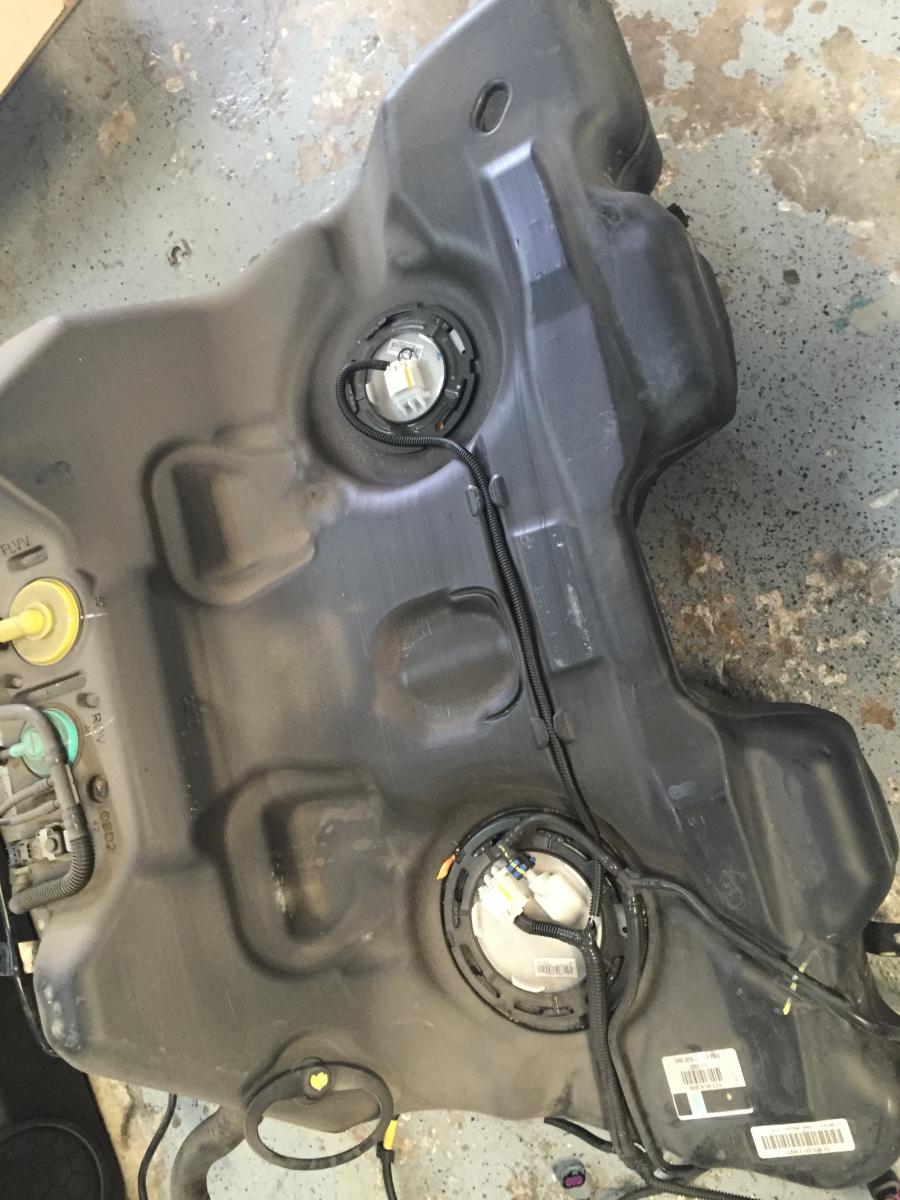

So yesterday when they were putting the cam, one of the lifters dropped so they just pulled the engine. The transmission was already off of the car and the motor was just sitting there on a few motor mounts.
So cam is in, valve springs are done motor is finished and Livernois dual Fuel pumps will be done by the end of the day. Not sure when they will put the engine back or what else they will finish or get started onto today, but its only 2pm and as we all can see there moving fast. Here are the pictures of today, more updates later!

Mantic 9000 Clutch is installed!
Livernois Fuel system installed!
Fuel tank and transmission will be back in the car tomorrow, first thing in the morning.

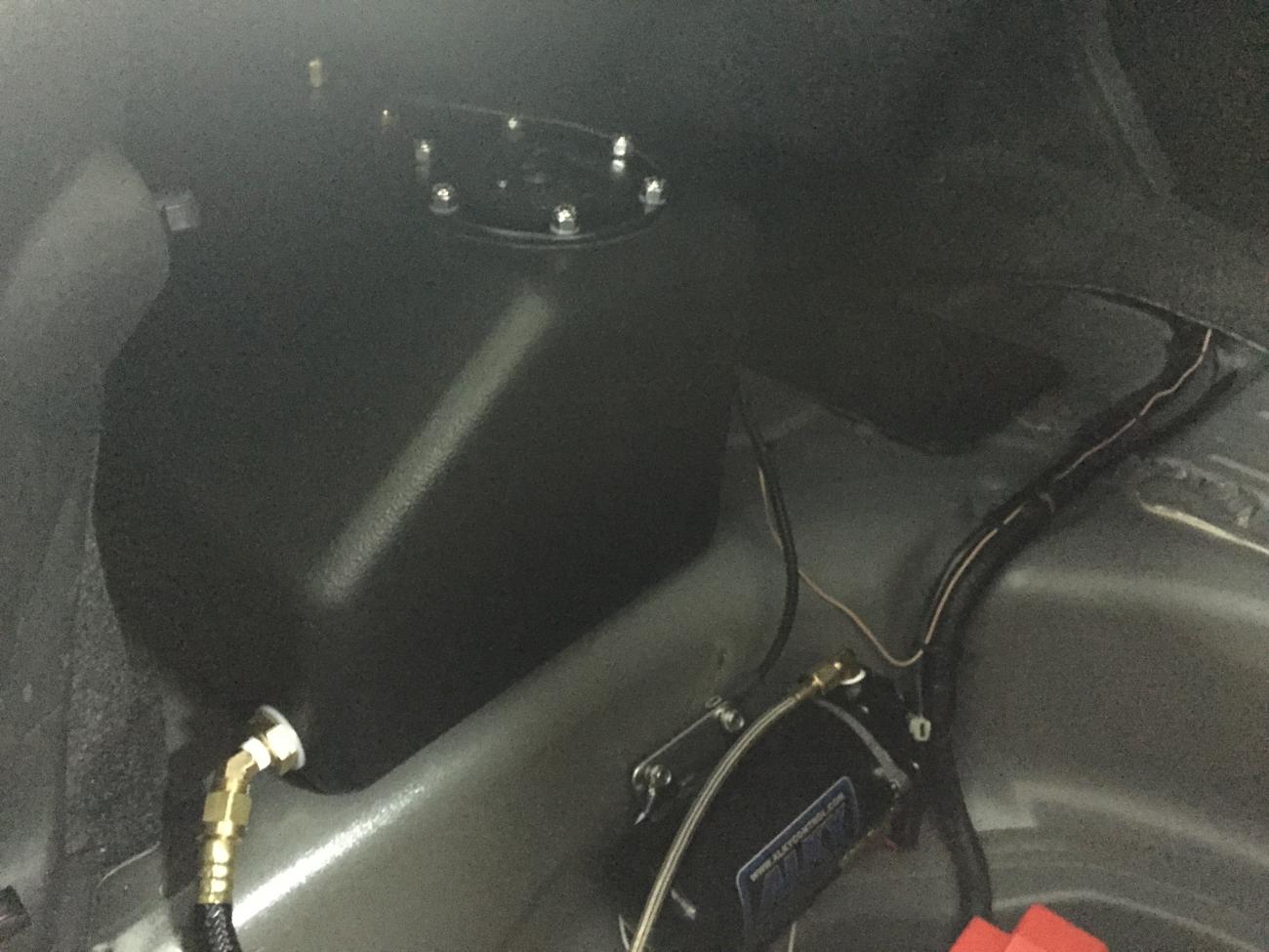

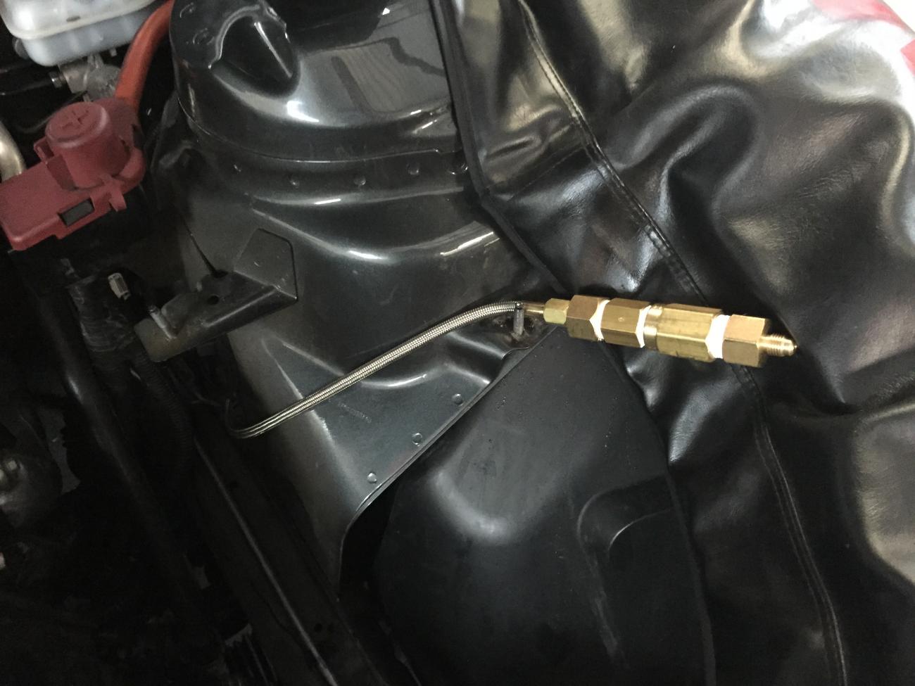

Well today was Alky control. As you can see by the picts they rocked it out.
So were waiting on the turbo kit from AGP, it will arrive Wednesday, which is a real bummer for FSP. I had bought a plane ticket and hotel reservations in December for the 15th of Jan. That was based on me and Matts discussion. We both felt it was plenty of time. Not much he can do when parts are not in his hands. Yet Matt is assuring me that hell have the car ready by the end of the week. I hate to put them under the gun, the cost of the tickets is nothing compared to the cost of the build. So we will just see how it goes. I want the guys to have fun and enjoy the build, not want to kick it out of the shop.
