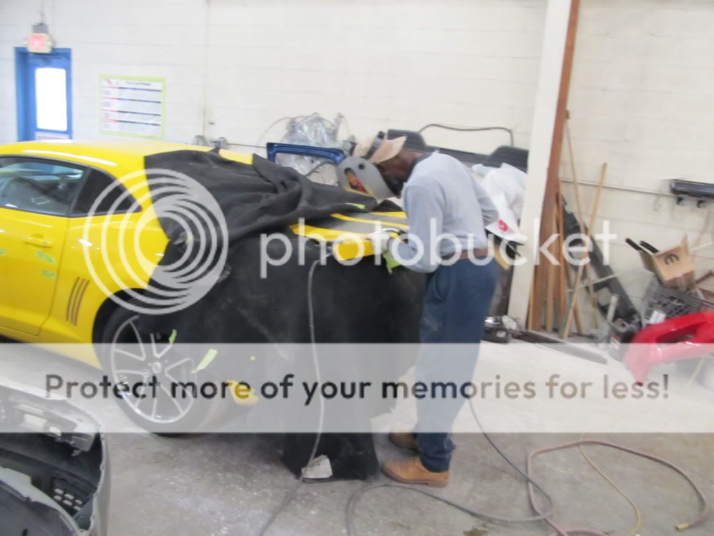

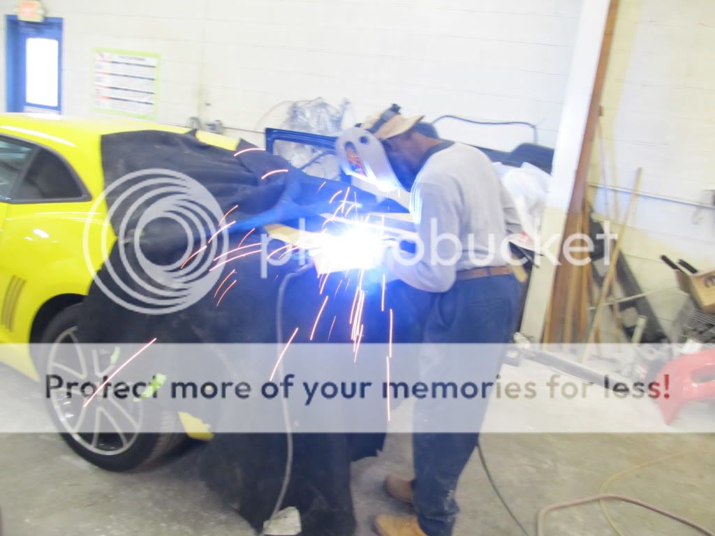

What about the holes left over in the trunk. Anything to cover them with?

To cover up the holes do this
