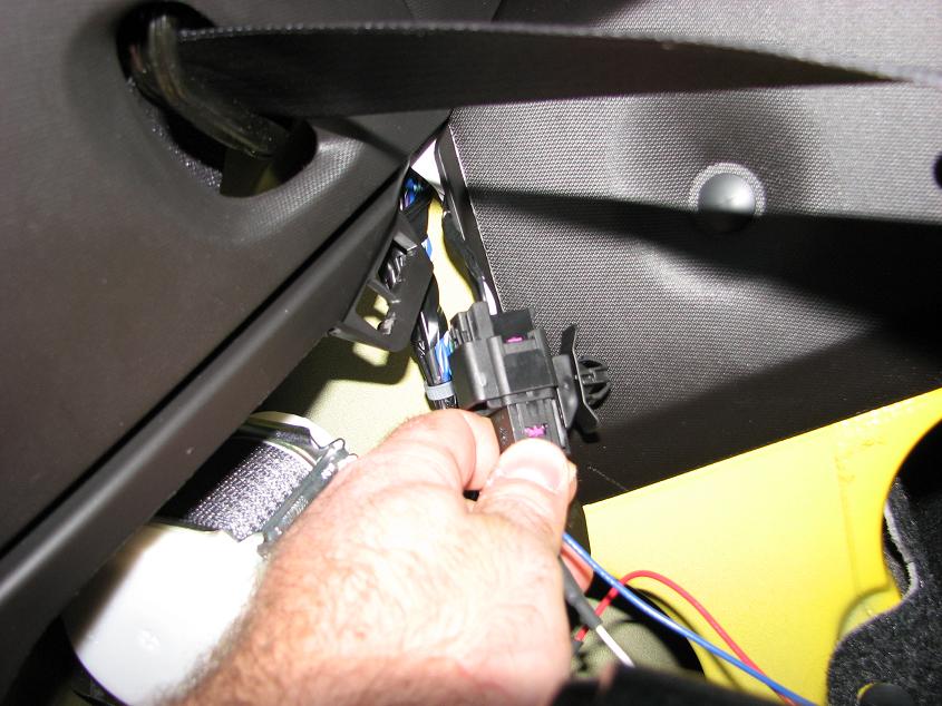

Installed the kits from WebElectric Products. Taillights are easy, had them in in about 10 mins. I applied dielectric grease in the sockets to prevent corrosion from setting in. The 3rd brake pulser was more of a challenge. Looking at the back seat and how it folds down and access to the trunk I knew there had to be an easier way to install this other than to rip out the rear seats and those panels. AAC claimed there is a way to get to the 3rd brake light wiring from the trunk, but I didn't see how. So, I was able to install the pulser with out removing the rear seat or completely removing the side panel. I folded both front seats down. I had the passenger seat all the way forward. Fold the back seat down and pull about 1/2 the right rear interior panel out to expose the wiring harness running to the trunk area under the rear seat belt spool. It is a bit of P.I.T.A. but this is actually do-able in only 20-30 mins! Open the trunk and at the back towards the right you will see where the connector for the 3rd brake light clips to the body. You can squeeze the plastic clips from the trunk side to free the connector. I am pointing to the hole it clips to in the one of the pictures. Once the connector is free you can carefully cut, or unwrap the electrical tape around the harness to get some more working length and disconnect the connector. Leave the harness from the connector to the brake light alone. Take the other end and cut the harness a couple of inches from the connector body. Make sure where ever you cut you still have enough wiring to work with and crimp your butt connectors to. With the connector cut out and in your hand, you can pre-wire half of it with out reaching behind that panel. The black wire is ground and white is power to the light. I would like to thank Bumble Bee and his post ;

It is kinda cramped trying to wire in the pulser with the panel half there. It is worth it for the time you save. With it half unsnapped you can hold it out far enough to get working room. Once the pulser is wired in, reconnect the factory connector and push it back and snap it back into the hole. Test your light before your reassemble and tie everything down.
