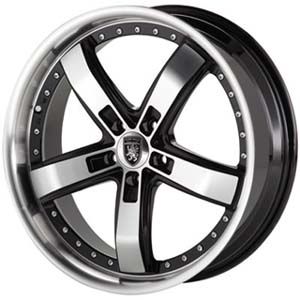

Question VonMax Wheels Fit?
will these wheels fit on the LS stock tires?
18x8.5 size
5x120 bolt pattern
35mm offset
the stock LS rims are:
18x7.5 size
5x120 bolt pattern
38mm offset

they would work just fine......you wouldn't even be able to notice the difference in the placement of the wheel. the difference would only be about 3/8"
