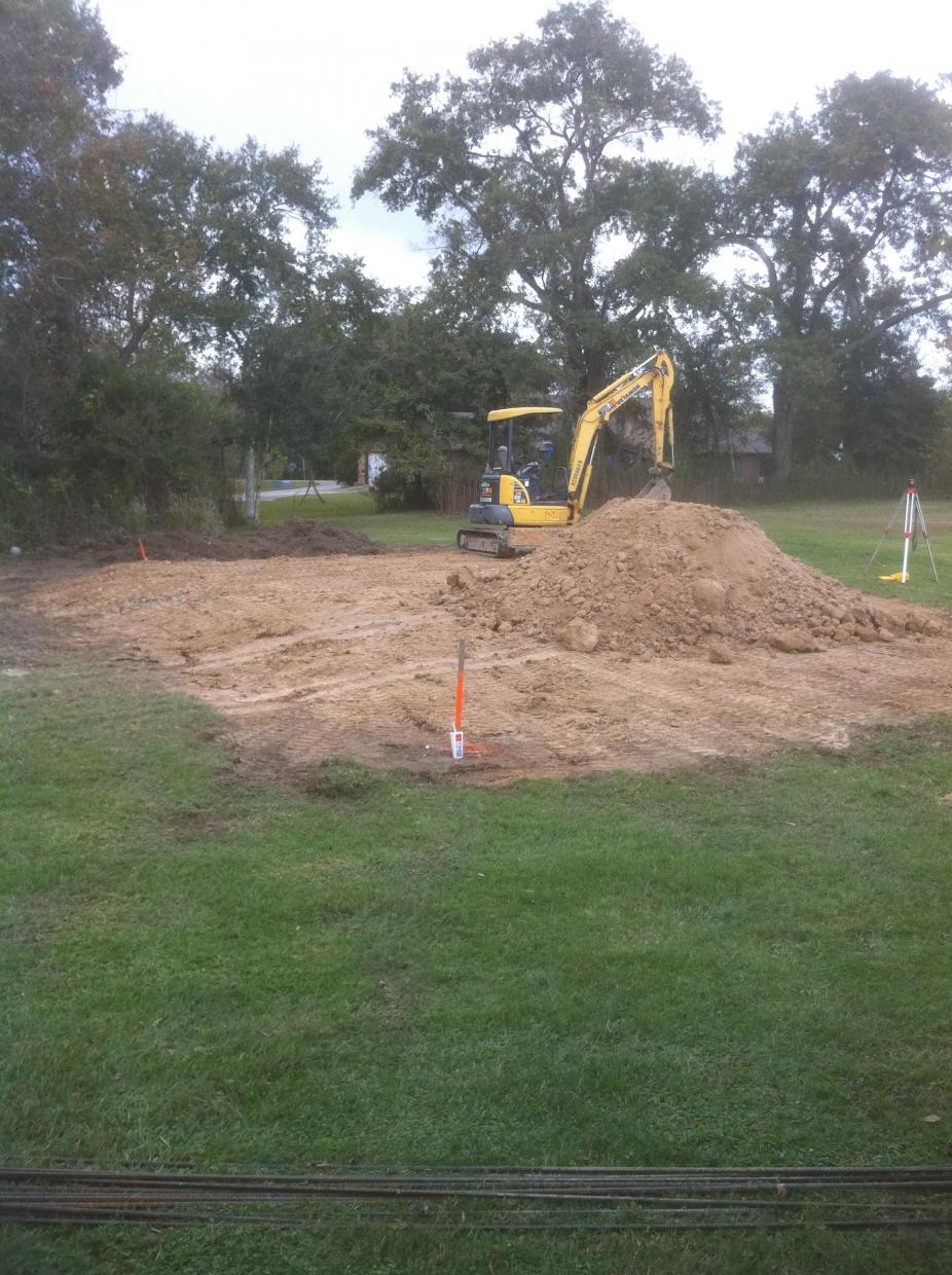

Good info!! I just started a 25x40 now and was wondering the same thing

I got a building permit then ordered the building the place that I got the building from got me a guy to do the slab and erect the building and that's as far as I got.
