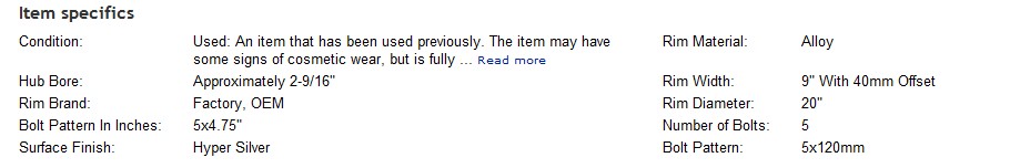

I just bought a slightly used 20" rear rim and here is the info from the tire dealer:
LOL at the wrong bolt pattern in inches.
I love how they put it in inches, but it is the right bolt pattern though.
