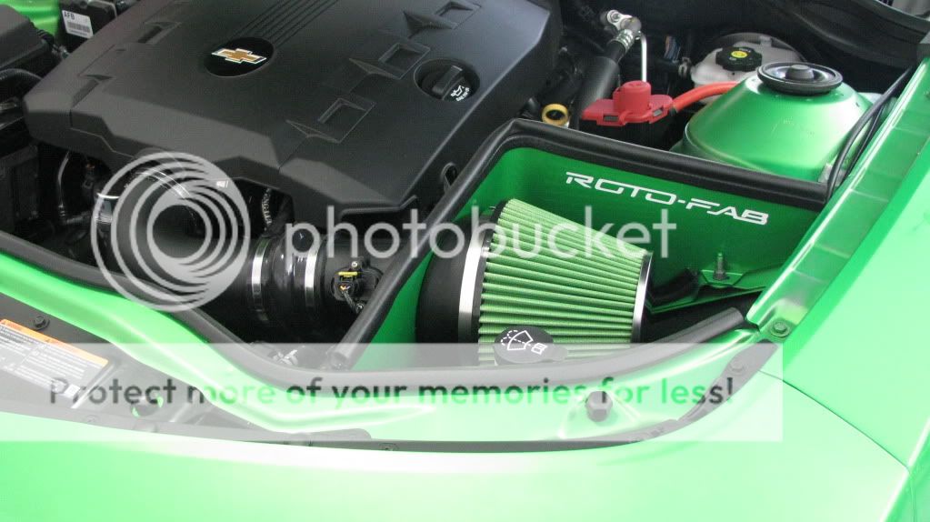

Air box

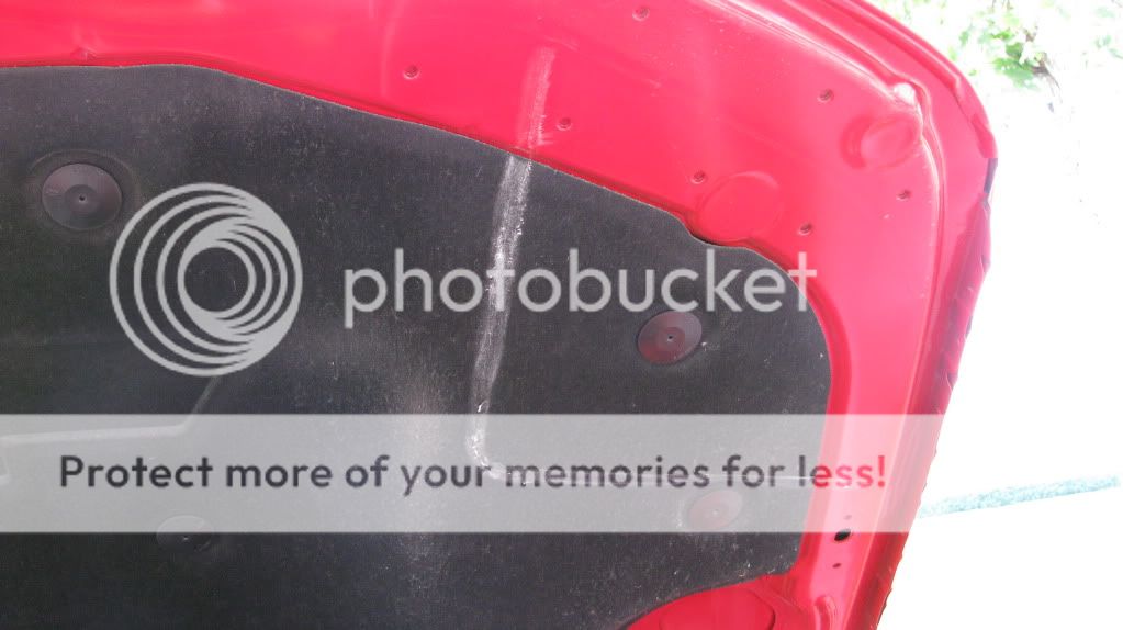

-Our air box makes the most of the available area by effectively shielding the engine hot compartment air from reaching the filter. By effectively sealing to the hood, you get all of the advantages of a closed air box while maximizing the area around the filter. We've done extensive testing on air box configurations and we have found that "crowding" the filter results in less power. Besides, the exposed filter looks really cool with the hood open! In the first pic, we applied a small amount of powder to the air box seal and closed the hood. You will see a less pronounced line on your hood after running our intake.
This picture shows how the lower part of the box fits your car. In adddition, you can see that our air box actually steps inward which creates more space for a bigger filter while shortening the intake tract length. A longer intake length creates a restriction resulting in less power gains.
Filter- We offer the standard oil type filter as welll as a dry filter. All of our filters are USA made and will last the lifetime of your vehicle with periodic maintenance. Our filters have a 6" mounting flange to accomodate our custom molded MAF sensor housing!
MAF sensor housing-In addition to accepting your stock MAF sensor, our housing performs several other functions. First, we mold the part nearly 1/4" thick to reduce heat transfer to the inner wall/air stream. A velocity stack type of entry is created by incorporating a large radius in the transition down from the 6" filter mounting flange to the finished diameter of the sensor housing itself. (5) 10-32 brass inserts are molded into the housing for tight, secure mounting to the air box. This unique design allows the air duct to pass through the air box wall while maintaining a barrier against radiator/engine heat.

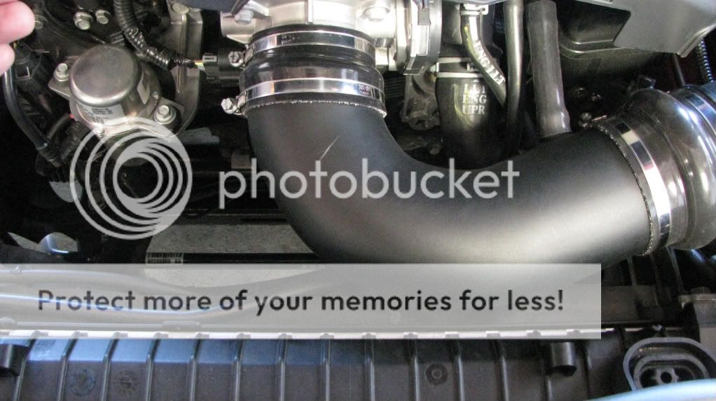

Inlet elbow-Like the MAF housing, our inlet elbow is molded nearly 1/4" thick. Plastic naturally transfers much less heat to the inner wall than aluminum. The additional thickness slows the heat transfer even more. We mold on a nipple and supply a straight silicone coupler for secure and clean mounting of the breather tube.
Hump hose and transition hose couplers
-With solid and sealed mounting to the air box, our system needs a dependable means of absorbing motor rock. We use top quality high gloss silicone couplers to achieve this. On the throttle body side we use a transition hose to step from the throttle body OD to our inlet elbow OD. FYI, the difference in size is what allows the inside diameter of our elbow to be the size of the OD of the throttle body. The other hose is referred to as a "hump hose" because of its shape. with movement the hump area expands or collapses to absorb movement. The hoses are secured with stainless steel non-perforated clamps which don't damage the hoses.

Love the Synergy Green with green filter, when will they be available?

Agreed. A breath of fresh air. Also liked the Synergy Green accents.

Sorry, that rubber seal that is supposed to seal against the hood just makes my shoulders raise against my neck and say why??? Its UGLY.....A BOX with an ugly rubber seal....where heat is....does it wrinkle or get compressed? Does it really supply a solid seal against the hood??? Really??? Oh well!!! Sorry.....I don't see it happenin and I don't like it. I have an Ingen and love the appearance and performance!
