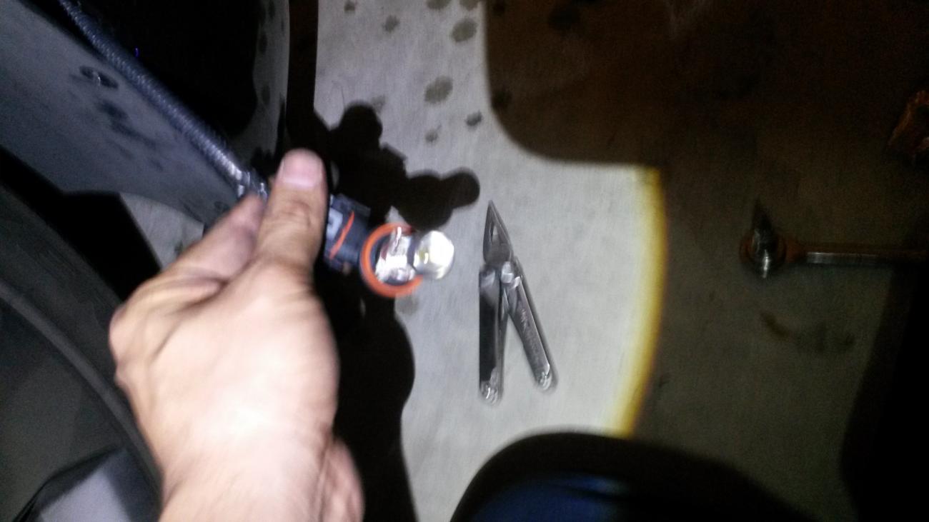

Hello Peoples. I coudn't find a tutorial on how to replace the fog lights on 2014 cars with the rs package.
First thing you should know is the replacement lamp size is h11.
UPDATE: I no longer have am using LED's
I replaced them with 35 watt 10,000k HID's by Xentec. These new lights look fantastic and are way brighter than the Halogen or LED's.
Install instructions for HID's are the same.
You will need a torx bit T20 and a socket wrench 7mm socket.
1. Turn the wheel of the side you are working on all the way towards the inside of the car. This will make it easy to get to the three torx screws that you must remove first.

2. Under the car there are two 7mm bolts you must remove. The are behind the air dam.

3. Pull plastic towards the wheel to expose the lamp fixture.
4. Twist the lamp fixture counterclockwise and pull straight out.
5. Pull the old lamp on and replace with new LED one.
6. Replace fixture into it's housing.
7. Test
8. Replace all screws and bolts and repeat on opposite side

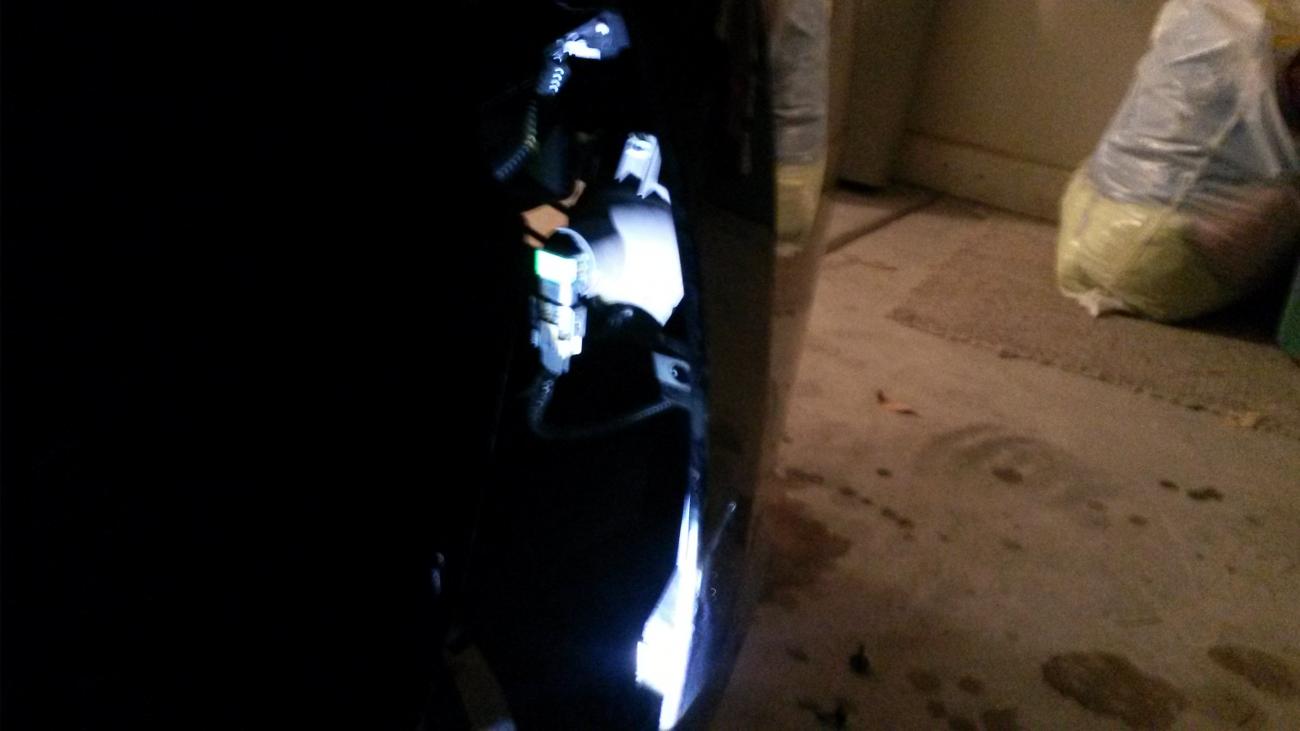

You're done!
Below is a picture of the old lamp and one of the new one installed.
If I would of changed anything I would have gone with an even brighter lamp.

Both lights
