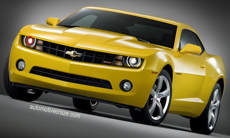

So I just noticed that my passenger side ligth is not working properly, the halo is turning on but the middle section is not.
Anyone got any ideas?

Headlight bulb is out, go to dealer and tell them to put you another bulb in under warranty. The Halo from the headlight.

i had the same problem, turns out it wasn't the bulb though, the headlight assembly went bad and they had to replace the whole thing.

I have an update I was washing my car today and I noticed moisture inside the headlight also the turn signal light next to it.
Guess I'll have to go the dealer I doubt they'll have them in stock though.

A little water can kill the HID ballast in the bottom of the lamp in no time. If the dealer can't get the lamp, he should be able to service the ballast (if he can figure out why it is leaking).

Thanks I guess I'll go to the dealer on monday and see what they say.
