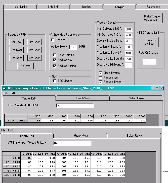

Functions like TM, TC, wheel hop, and launch control have been around for awhile
The PCM becomes a dyno in that it can calculate what the torque is under all conditions.
It uses several feedback sensors such as the MAF, MAP, throttle angle, YAW sensor and wheel sensors.
As shown here you can see the PCM can control these functions by control of throttle, fuel injectors, and timing.
These functions can be properly adjusted with a good tune, watch out for the lazy tuners that just turn the functions off as the sensors see what you cannot and also react faster so at times TM can reduce wheel spin and have better drag strip ETs.
Best is to tune TM that best suits your drive style
It also is important that you do not allow a tuner to just screw around with the MAF tables for the wrong reasons as this will then effect what the air mass / engine load is and cause the PCM to calculate the torque incorrectly.
TM will effect how much timing the PCM commands and can effect the torque converter if automatic trannie is used.
This is just part of the values and tables in the PCM that we tune as per the car's makeup, how the owner tends to drive and what mods they have added.
