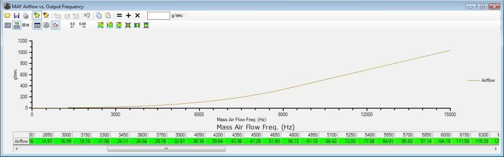

Injector slope? I hope that's slang for fixing the MAF curve via a Predator.

DStech - with diablo programmers for GM's, you adjust the part-throttle fueling by adjusting the injector slope, not the MAF curve... you can't adjust/tweak the MAF curve table via a handheld, so that's what they give ya to work with...
I'm sure tweaking the MAF curve via a handheld programmer would be a PITA for most end-users who aren't sure what they're doing to begin with, if it was even be possible via a handheld...
at least they give you a way to adjust the fueling and get it dialed in, unlike other handhelds... heh..

That blows. I'll stick to MAF curves.

Go with the custom tune. Raping the injector slope with your handheld tuner is not a good idea. With your setup the MAF sensors needs to be calibrated as well as the VE equations.
If you adjust the injector data to dial in the fueling because the MAF and VE is incorrect you will throw off every other table in the computer that is based on airmass.
