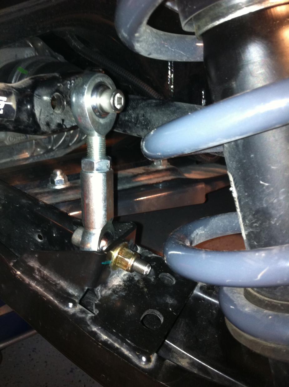

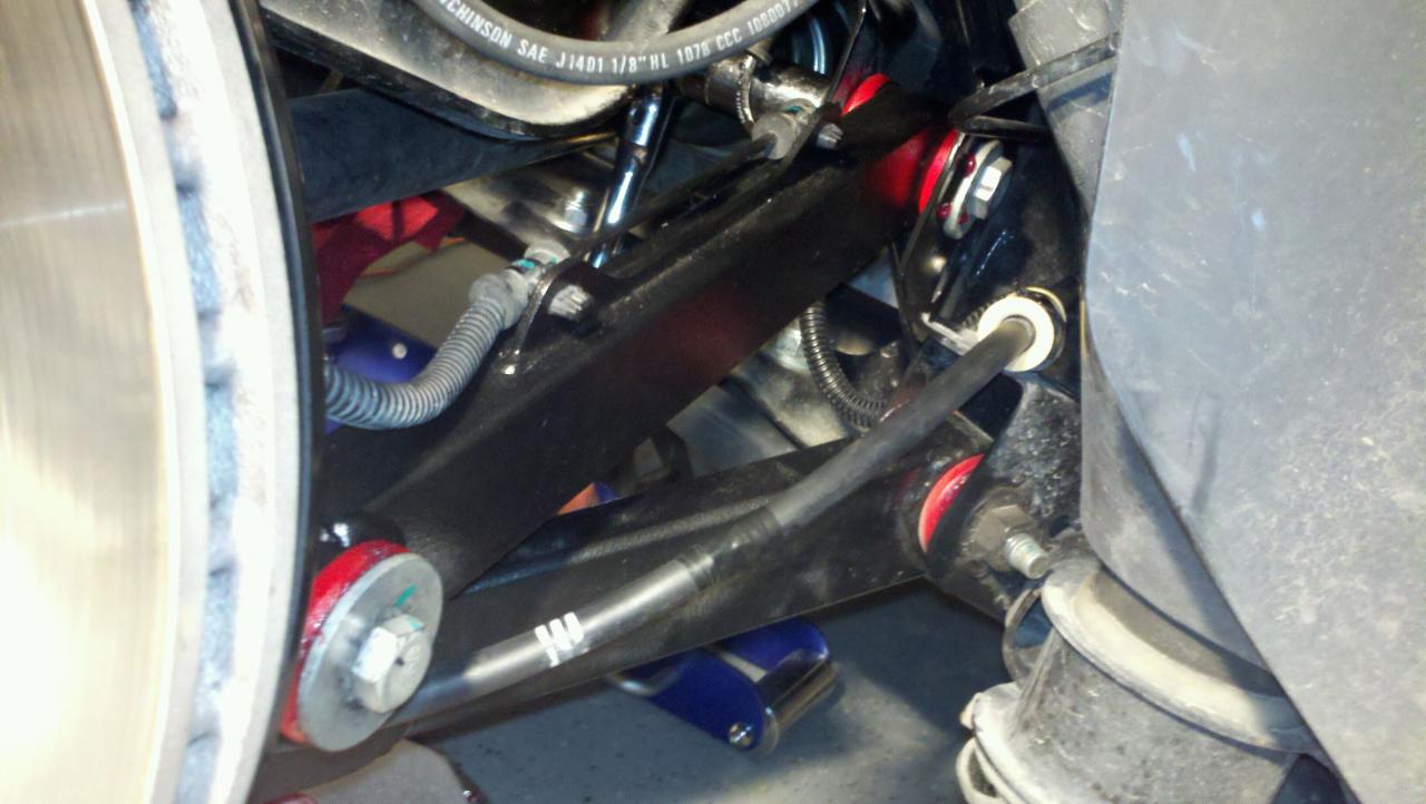

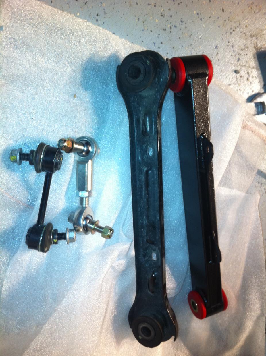

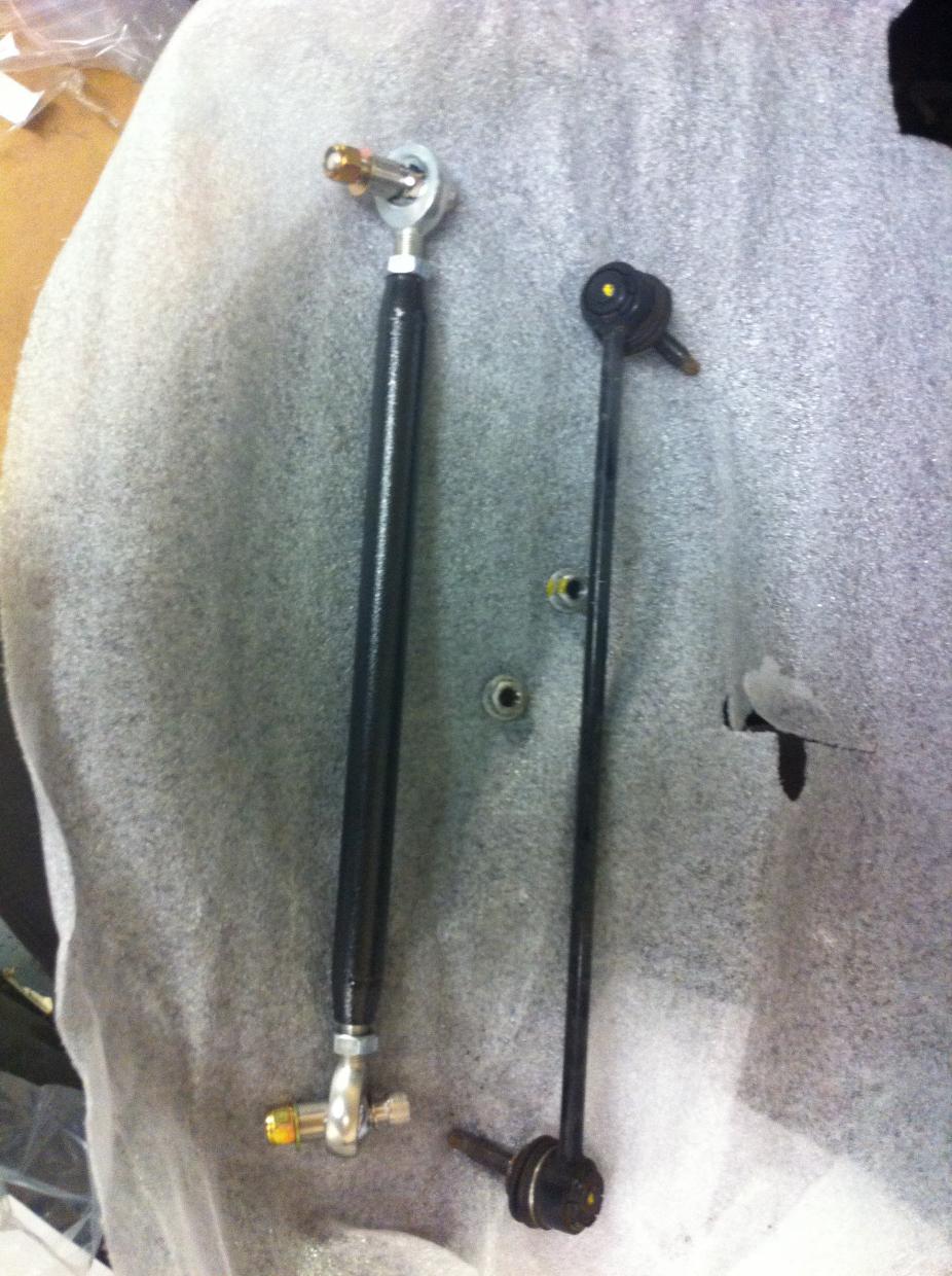

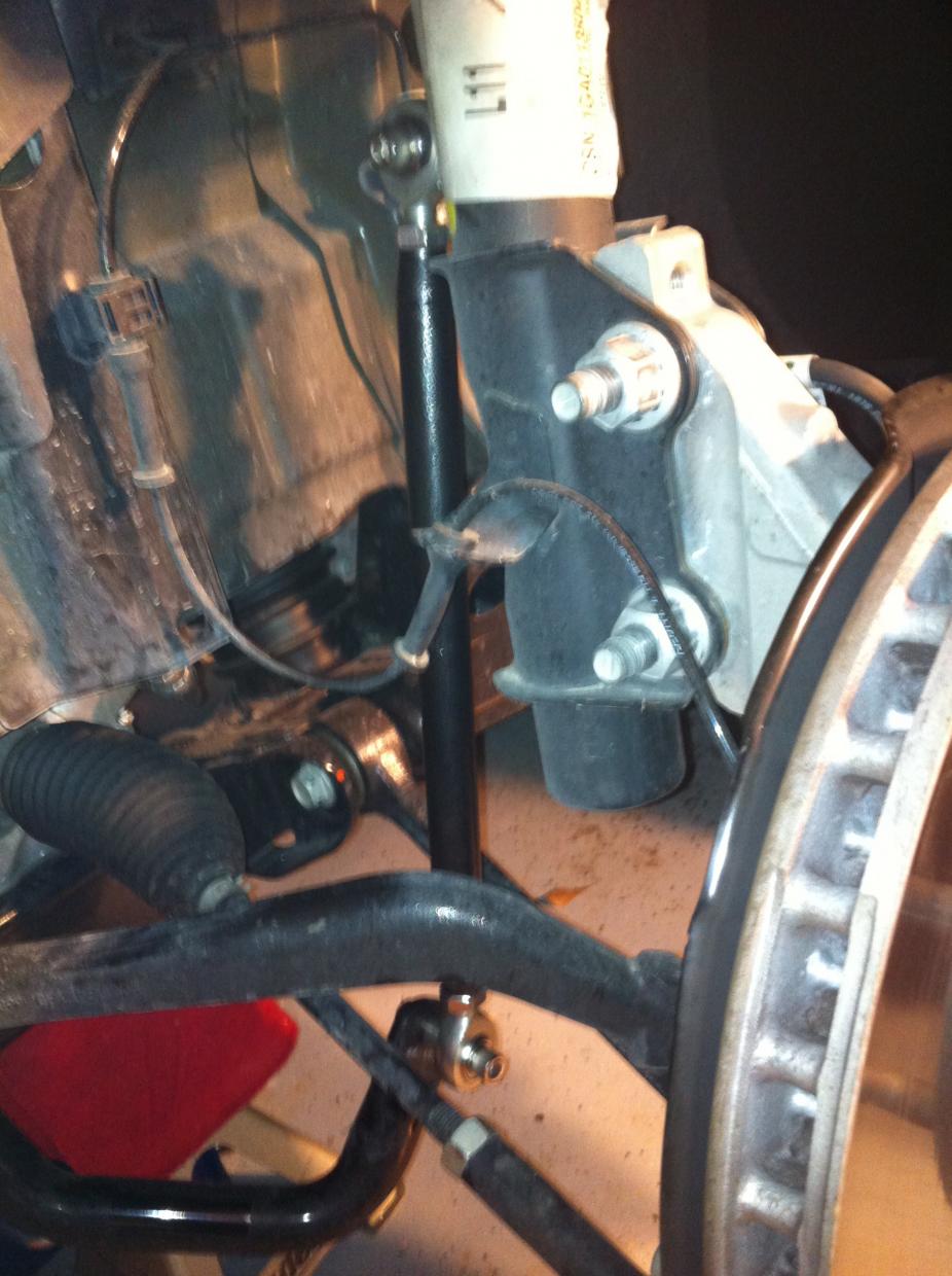

I did the install at my house this weekend and it was fun. The only part that sucked was having to drop the rear cradle to install the driver side toe rod... other than that it was cake!

Those end links are just a little bit beefier than stock, huh?

just a little!!
