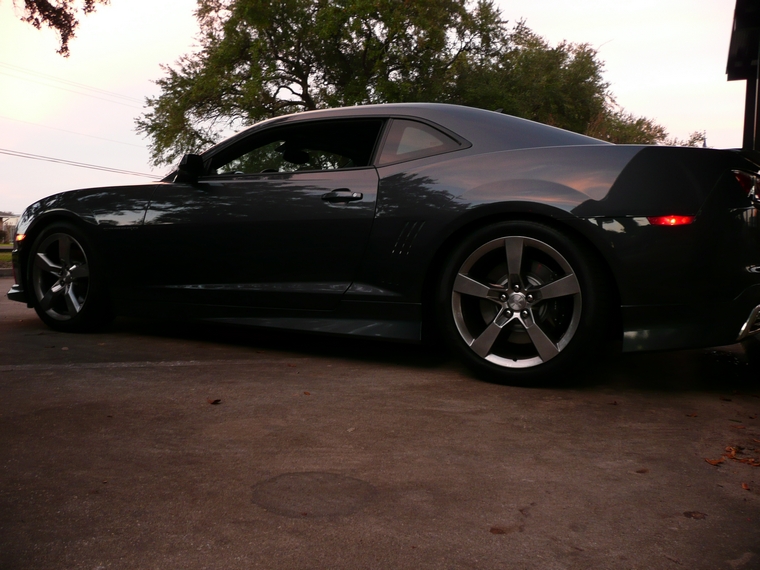

Gmag,
ive installed three sets of H&R springs(1 1/8-1/4" drop), but i can also install any setup you want to go with
Old 02-20-2010, 09:11 PM   #8
BLACK10
BLACK10's Avatar
Posts: 4,585
another drop installed, rides great
