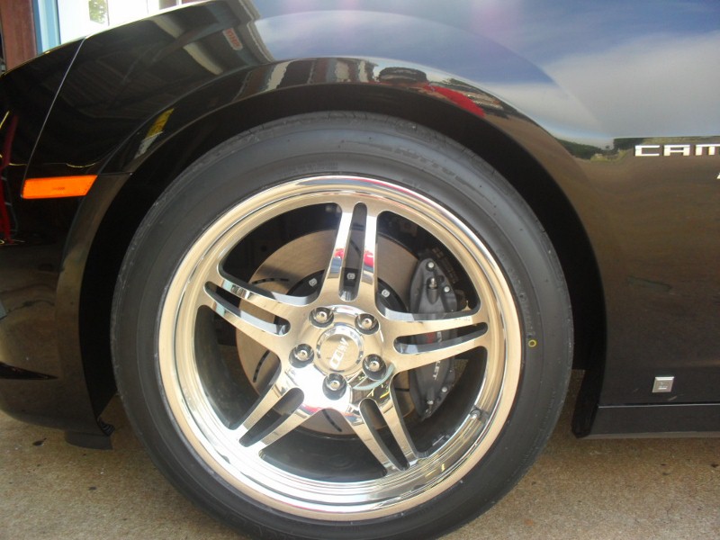

My Supercar Suspension Installed!
Well guys, I finally have it all installed and all I can say is WOW! From the way Pedders and Pfadt worked with me and each other to get the rights parts to Heath and Sam at American Muffler and Brake Fredricksberg TX who did a Top Notch installation. My car is now AWESOME!
Pedders US parts warehouse manager Dan aka PartsGedder was also there to greet me assist in the whole install. I dropped the car off at 8 am Sat. morning and wouldn’t you know it the only car rental place in town is closed on Sat. Heath came to my sons rescue and loaned me his truck for the day (like I said a top notch guy). We got back over to the shop about 3 pm and they had the front done and were on the left side of the back. We watched them work on the car for a few hours then headed back to the hotel to await the call. When I say these guys are hard core I mean it, they called about 12 am to verify the height then called back at 3am to say the car was done. When I got to the shop and during the check drive a slight thump could be heard at low speed upon acceleration, we messed with it for about an hour before crying uncle and picked it back at 9 am Sunday morn. After a few more drives and three trips back up on the rack and two complete bolt checks of every nut and bolt we finally concluded it is the play in the rear-end and with the HD bushings vs. soft rubber you can just hear it now. I will give LPE a call to check the spec on that one this week.
Well back to the Camaro and the results of all of these parts and professional installation. The difference is night and day, if when GM builds the Z28 they really need bring Pedders into the design. The super car coilovers are amazing, I haven’t even had a chance to play with adjustments yet but at 15 clicks it is nice. The ride is firm but not harsh at all, like when I had the 21’s on my car I hated the harsh ride. You will notice more road noise from the bushings, but I got the HD’s and they are very hard. The steering and road tracking is also vastly improved, no more fighting the wheel at 80 to hold a line on a rough road. In a corner the car is flat and it now feels like the only limits are tires and the intestinal fortitude to push it. In fact I would say it is beyond a Z06 corvette, and would love to have the chance to compare it with a ZR1.
Details of parts we added:

Here are some pics and as soon as I get a chance to clean her up will add some better after shots, these were taken at about 3am.

Mike, It was great to meet you. I have the 2AM pic of the car with the finished ride heights, 640mm front, 650mm rear. The picture is dark, but it shows the drop. The picture didn't look that fuzzy when it was taken...
