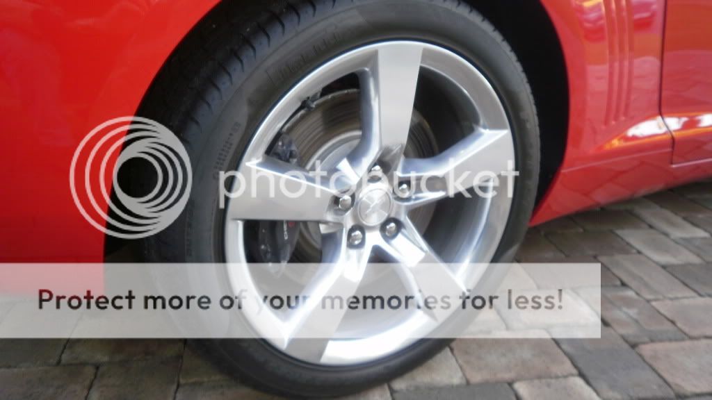

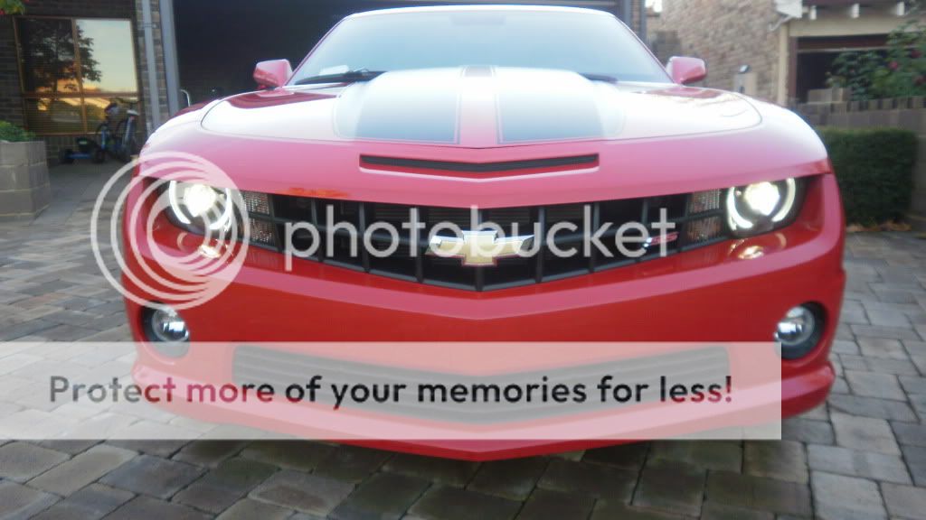

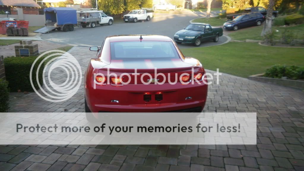

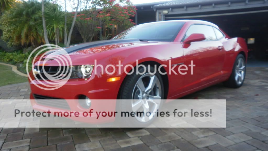

Just want some input into what other mods can or should be done. The car will be dyno tuned and afm and related features will be turned off. Also does anyone know how much the gearbox is good for before it blows and roughly what sort of figures people are getting out of theres? Anyway heres a couple pictures of my clubsport with an LS3 and a pick up with a v6.

Car looks good... you will love the extra power!
