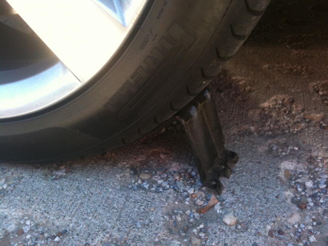

first wheel chocks

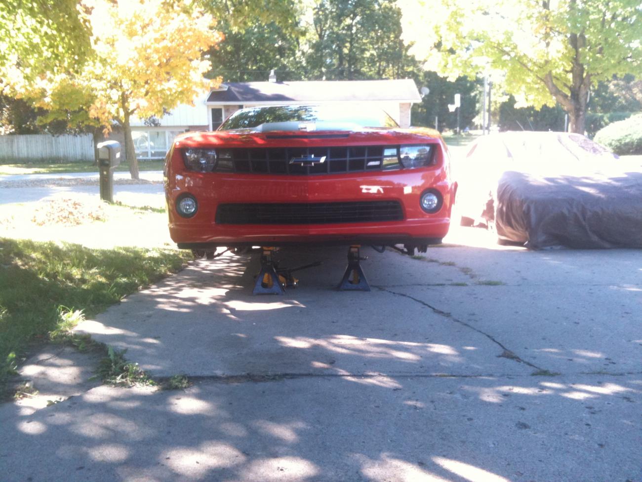

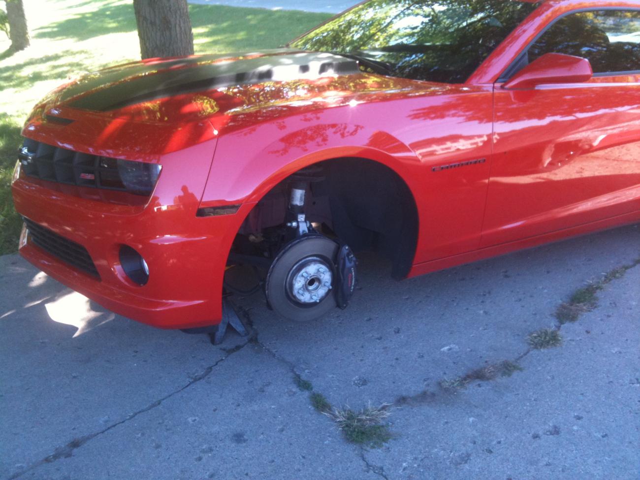

jack the car up from a safe point
take off tire

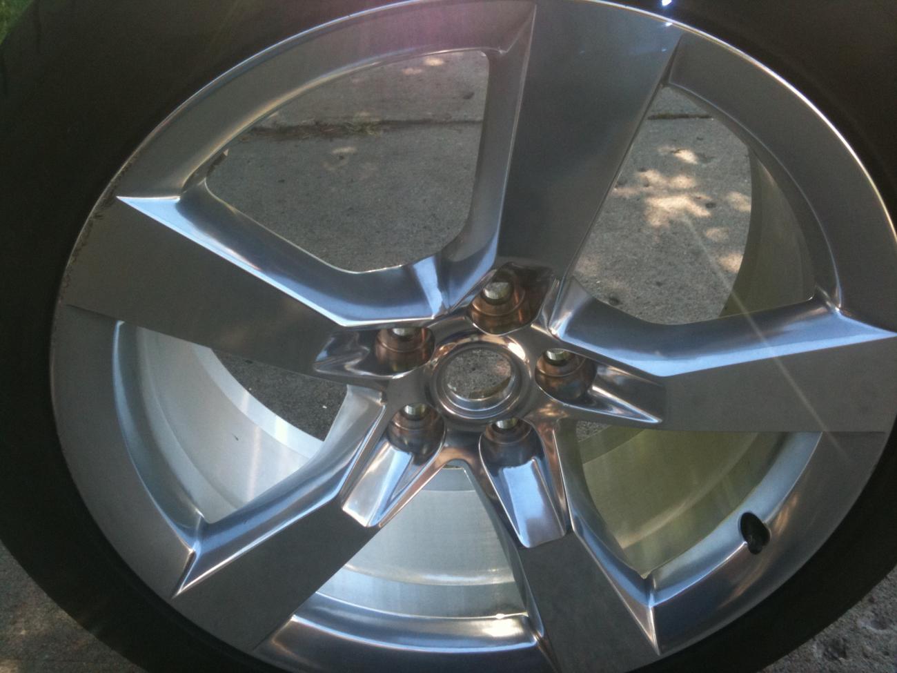

clean clean clean
i used brake cleaner and rim cleaner(found buy rim paint supplys at walmart)
i curbed this rim so i started with it.

clean, clean, make sure they are clean

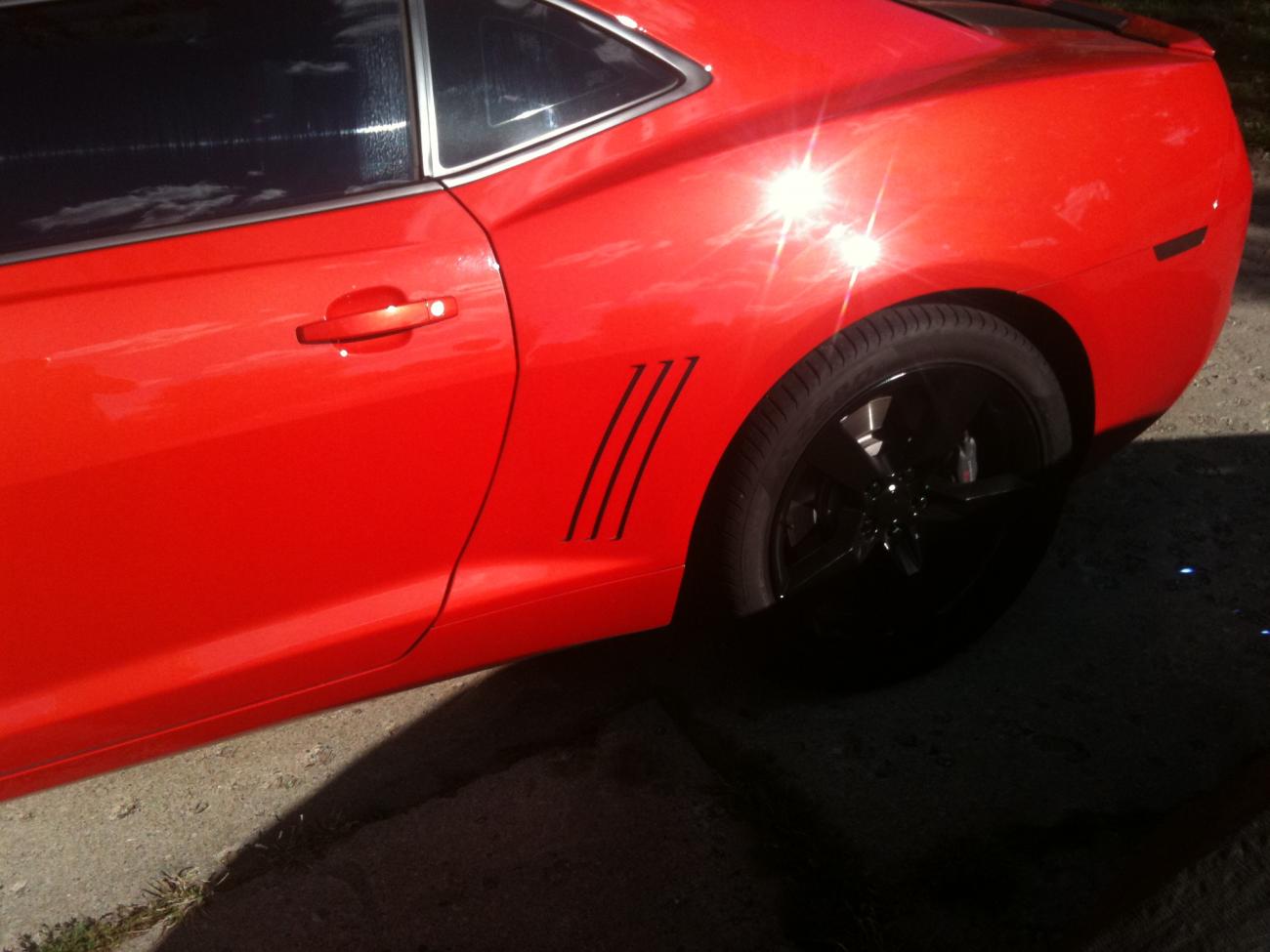

stand back and admire your work
then do other rear tire
clean, sand, primer, paint, paint, clear, clear, install

make sure you use good lift points and safety first

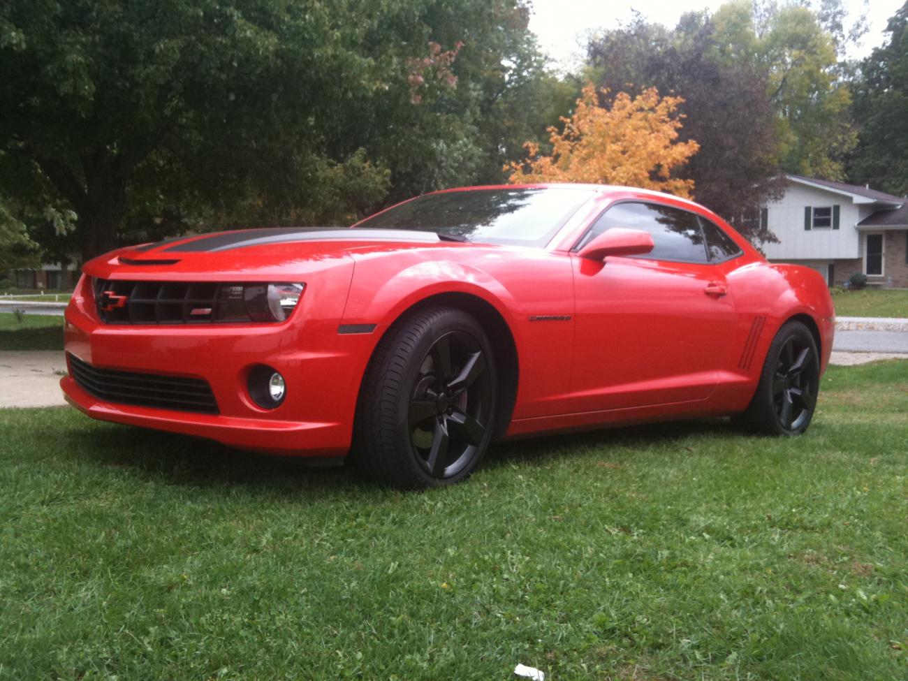

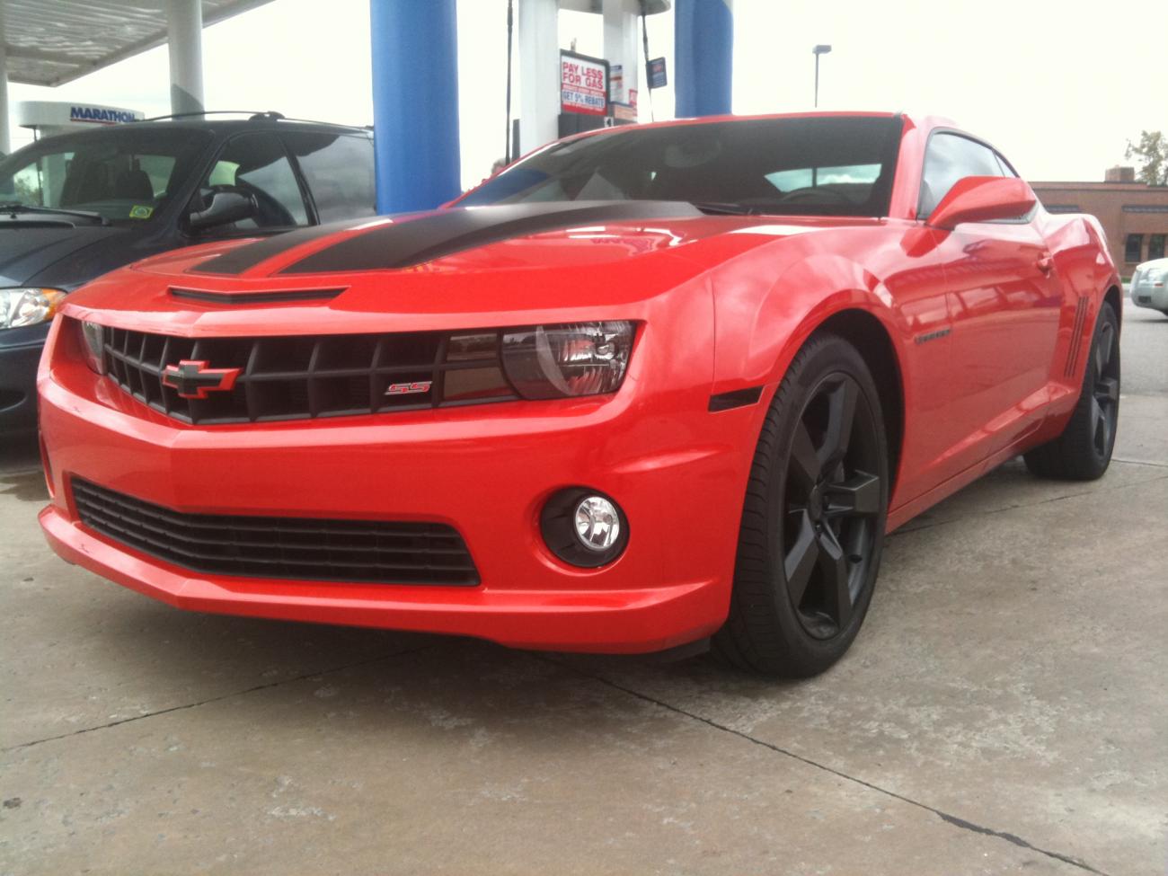

park in the light take some pictures and admire what you have just done

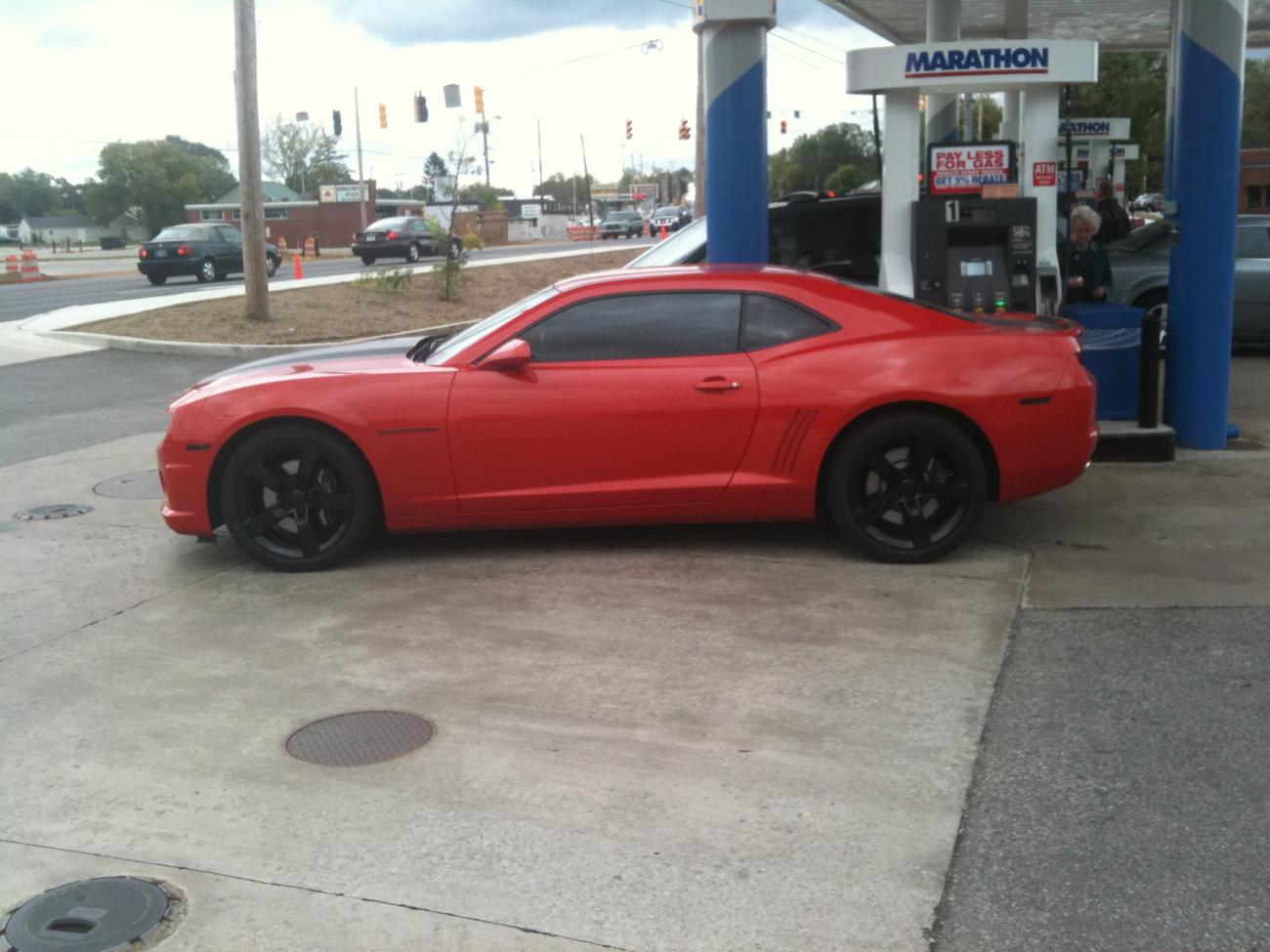

then drive around town and accept all the complements you get
i just got them done and drove to the gas station and first guy that walked out of the store told me that those rims looked bad a$$ on that car
all i could say was THANKS MAN!
hope this helps you guys out there that want to do this
it was relatively easy and inexpensive
just take your time or it will not look as good as you wanted
remember you want to be able to stand back and say LOOK WHAT I DID!
and not say OH MY GOD LOOK AT WHAT I DID TO MY CAR, WHY DID I DO THAT.
