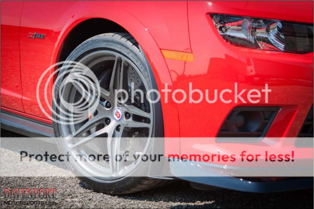

We did a set of Forged HRE P107's. The front's were 4lbs lighter each and the rears were the same weight as factory. These are the street wheels with Michelin Pilot Super Sports.

Sorry for the delay, I've been away for awhile.
We did 19" X 11" front and 19" X 11.5" rear, unfortunately I don't remember the offsets.
