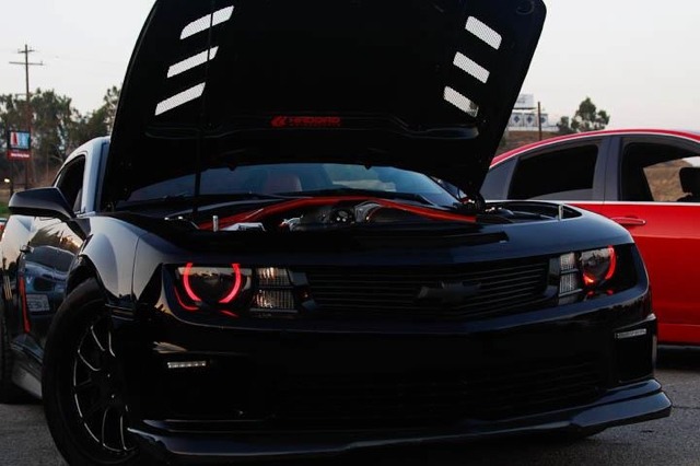

Heres a photo with the rainguards removed on the AMS. I personally run with them out all year long (in AZ). Either way they are quick to put on and take off!
A.K.A - Diarmadhi (old handle) - So much to do.. So little money
