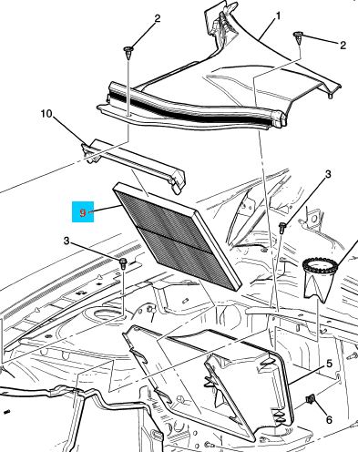

The HVAC blower fan is located behind the cabin air filter. Here is a link on how to remove the filter:
http://www.camaro5.com/forums/showth...BIN+AIR+FILTER

Diagram request
When I first asked about cleaning the HVAC blower fan, LimaCharlie wrote back with a link showing how to remove the filter
The link is no longer there. Can someone repost?
Thanks.

Diagram request
I found the diagram on another page within Camaro5 at
http://www.camaro5.com/forums/showpo...01&postcount=1
There's also a youtube video on replacing it at
"http://www.youtube.com/watch?v=ymul7T3hC5Y"
Here is the diagram plus an additional diagram I found elsewhere
