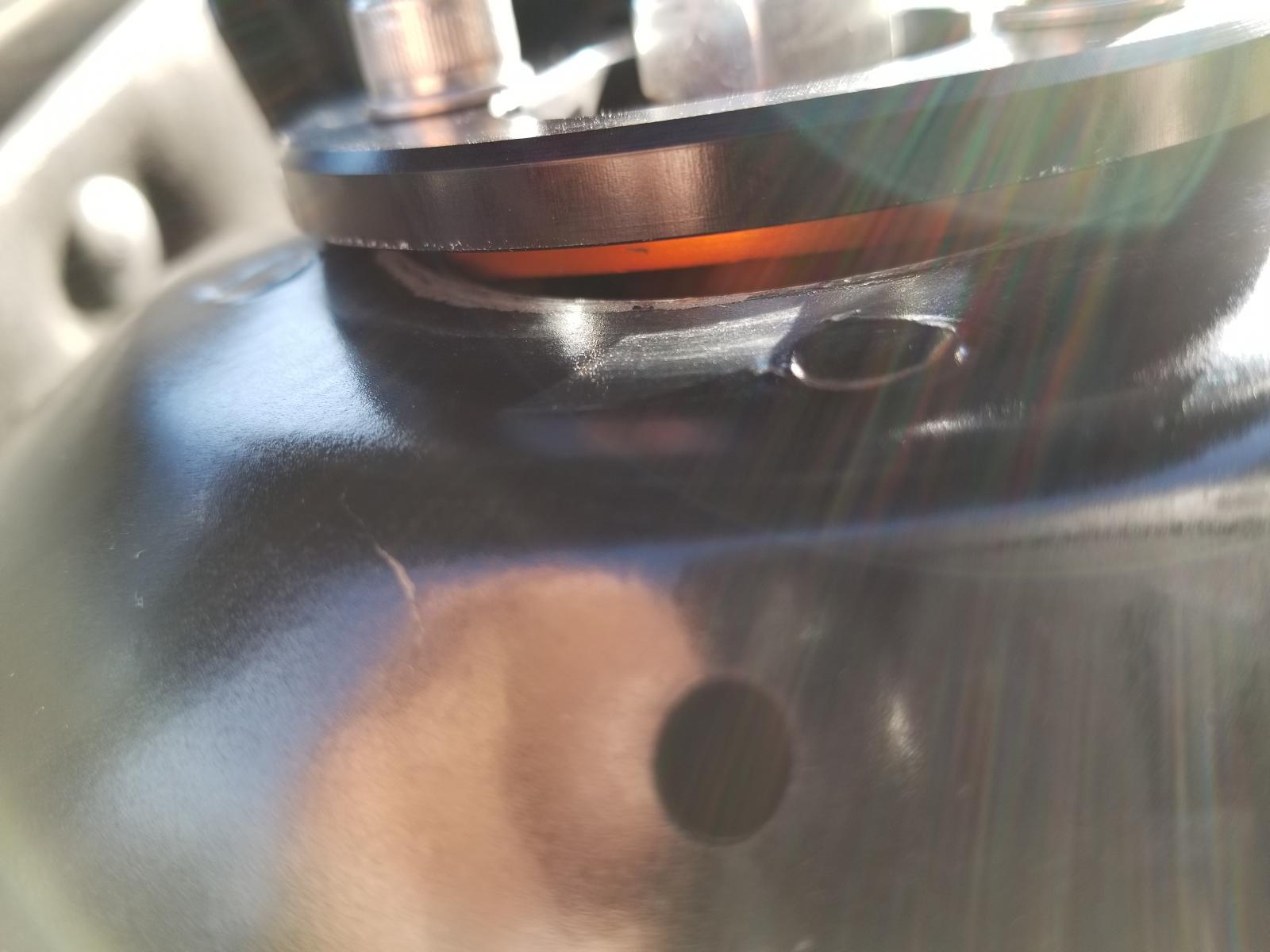

BENT upper front shock mount!!! Anyone seen this before???
Hi all,
I have original Pfadt coilovers on my SS and I was cleaning the engine bay and saw this! The shock tower mount is bent!!! Anyone else have this issue and can it be fixed/corrected???

Hit any big potholes and bottom out the suspension?

I was flying down a road and it had a nasty bump BUT I didn't think it would cause that !

Those are very thin plates that obviously did not like the bump you hit.
Is it a easy fix JP?

Literally pound the actual tower back in shape and see if they will replace your strut mount / camber plate.

Ouch that looks rough, since its thin metal I would just try to hammer it back into shape.

Gotta pound that back into shape

Cover it with a microfiber or two and hammer it back down.

Hammering will straighten the tower. There is no if about that. The camber plate has to be replaced.
The permanent fix is a thicker plate.
