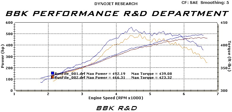

One of the SoCal guys put one on his car prior to picking it up from the dealership. Bone stock with less than 500 miles and the procharger put down pretty good numbers.
Name:  Jarrod Jacobs.jpg
