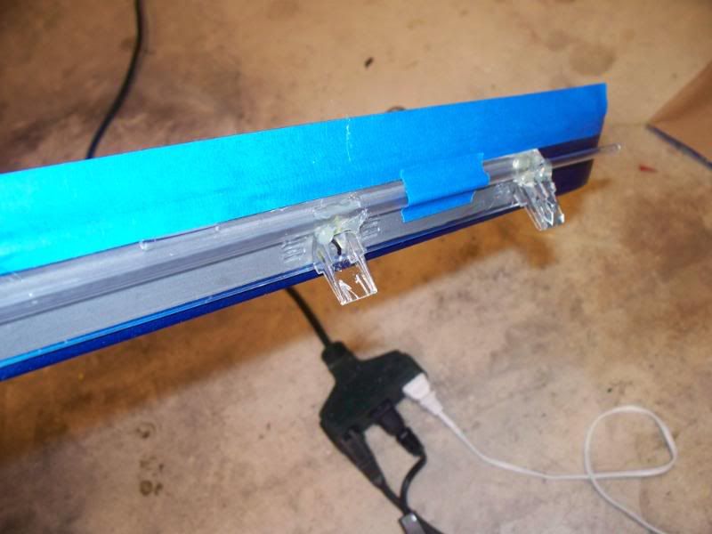

Old 08-16-2010, 02:14 PM   #328
TAG UR IT
www.Camaro5store.com
TAG UR IT's Avatar
Drives: 2014 ZL1 #705
Join Date: Jul 2006
Location: SA, Texas
Posts: 26,544
DO NOT USE SUPERGLUE!!!
The fumes from the superglue will DESTROY the outer plastic tubing. If you think it's splotchy now, just wait till AFTER using superglue.
I never had a problem with the hot glue melting while I had it in there.
Your best bet to get it to stick there is to do a drop or two UNDER the tube keeping it in place. Do NOT use the hot glue gun all around the tube as that makes it spotchy with the light coming through...only use it on the bottom to keep it in place. I wish I had all the pix on this computer....I'd be happy to show you how I did it. Just take off the dash panel and repair it. That is your best bet.
Old 08-16-2010, 02:19 PM   #329
TAG UR IT
TAG UR IT's Avatar
Join Date: Jul 2006
Location: SA, Texas
Posts: 26,544
OH! MAKE SURE that if you are doing this mod AND IF you pull off the backer, WHILE THE BACKER IS OFF, use a dremel or other tool to shave down the plastic tabs on the backer towards the top by where you sanded. Here's an example of what I mean.
Look to the left of the clip...the one inch plastic tab type thing...
Right where my pinkie finger is...you'll see that little tab. Once you pull it off, you'll see about 4 of those tabs ranging in different sizes. Shave them all down to be smooth. If not, you are going to get shadows from your El Wire.
Also, NO HOT GLUE ABOVE THE ACRYLIC TUBE!!!!
That will also create shadows. You want the blue to be PERFECT. I screwed this up (as you can see in the above picture) had to pull it off, and remove the top hot glue. I even had to shave off the ends of the acrylic tubes to make it better. But, all perfect now.
Yep...here's the post I was talking about!

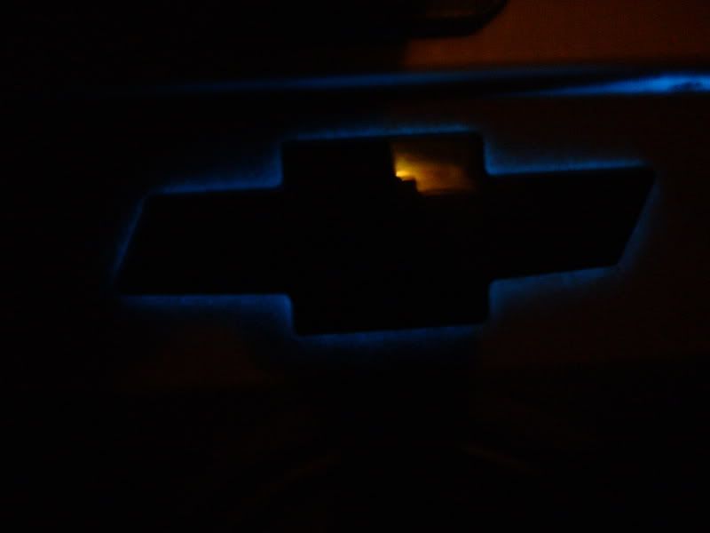

Noturday
[Not-your-day]
Noturday's Avatar
Drives: 2005 Avalanche
Location: Huntsville, TX
Posts: 223
this really does look great and the fact that it dims with the other interior lights is great
i have a question though, it may not be helpful to me since i dont have a camaro, but it may be helpful to the other guys here who are considering doing this...
i used EL wire in my truck to trace around a bowtie that is mounted on the front of my sub box (shown below), but the EL wire driver made a terrible high pitched noise every time it was on, and the EL wire actually quit working after about a month. it still made that high pitch noise so i had to take it out. is there any problem like that with this setup or did i just get a bad driver or what?
this was a mock-up pic, thats why there is renegade lighting off to the upper-right side there
Noturday is offline   Reply With Quote
Old 08-29-2010, 01:00 AM   #336
TAG UR IT
TAG UR IT's Avatar
Join Date: Jul 2006
Location: SA, Texas
Posts: 26,544
Nah...your unit was bad. I used mine and it worked fine. No problems...
