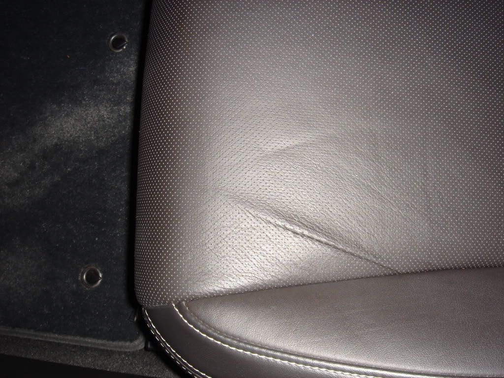

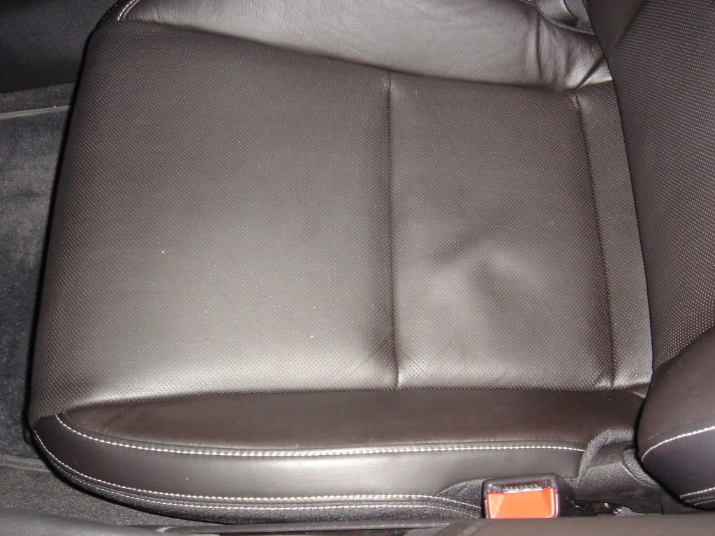

did you guys look @ the pics i posted? is mine much worse?

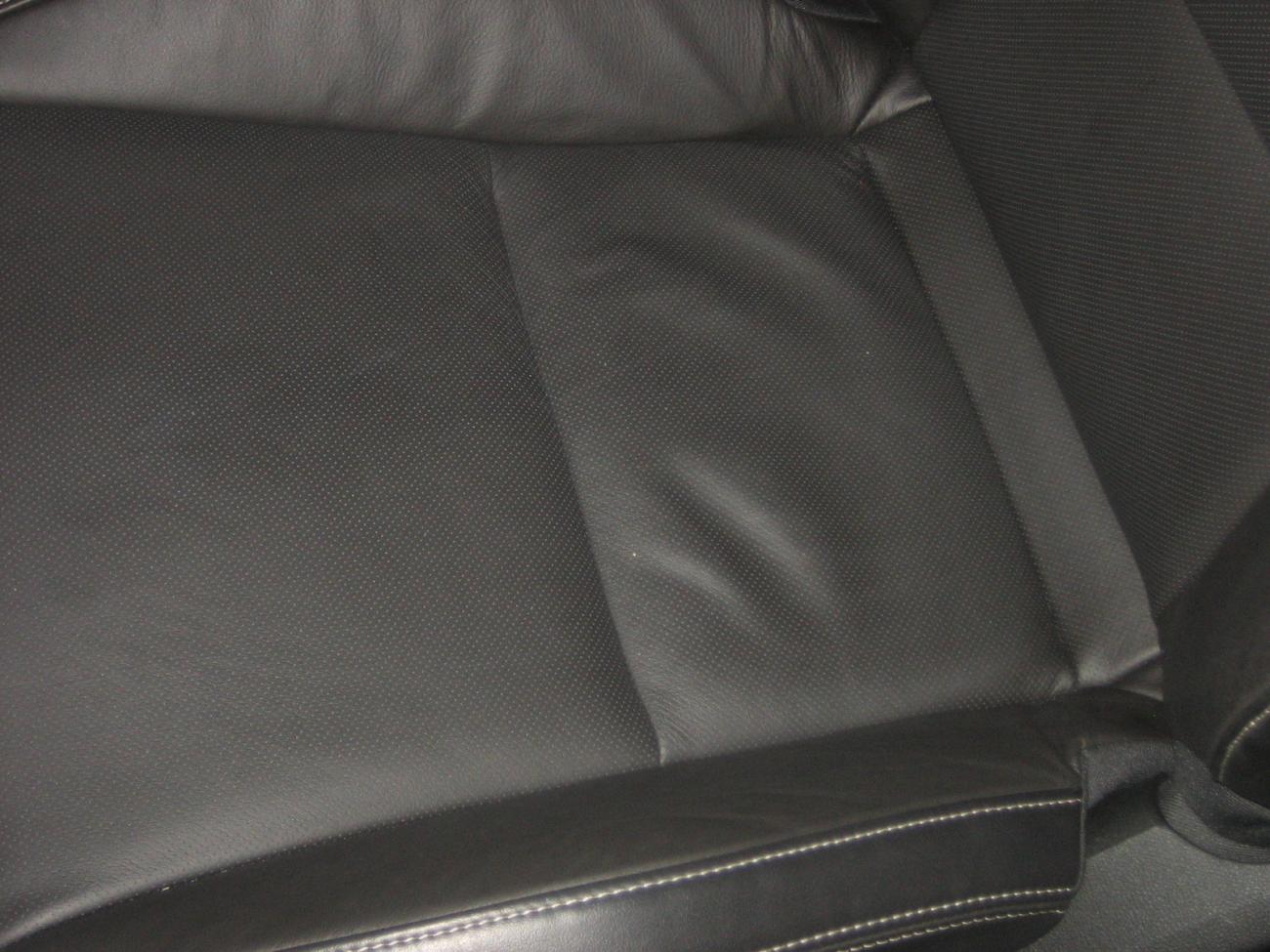

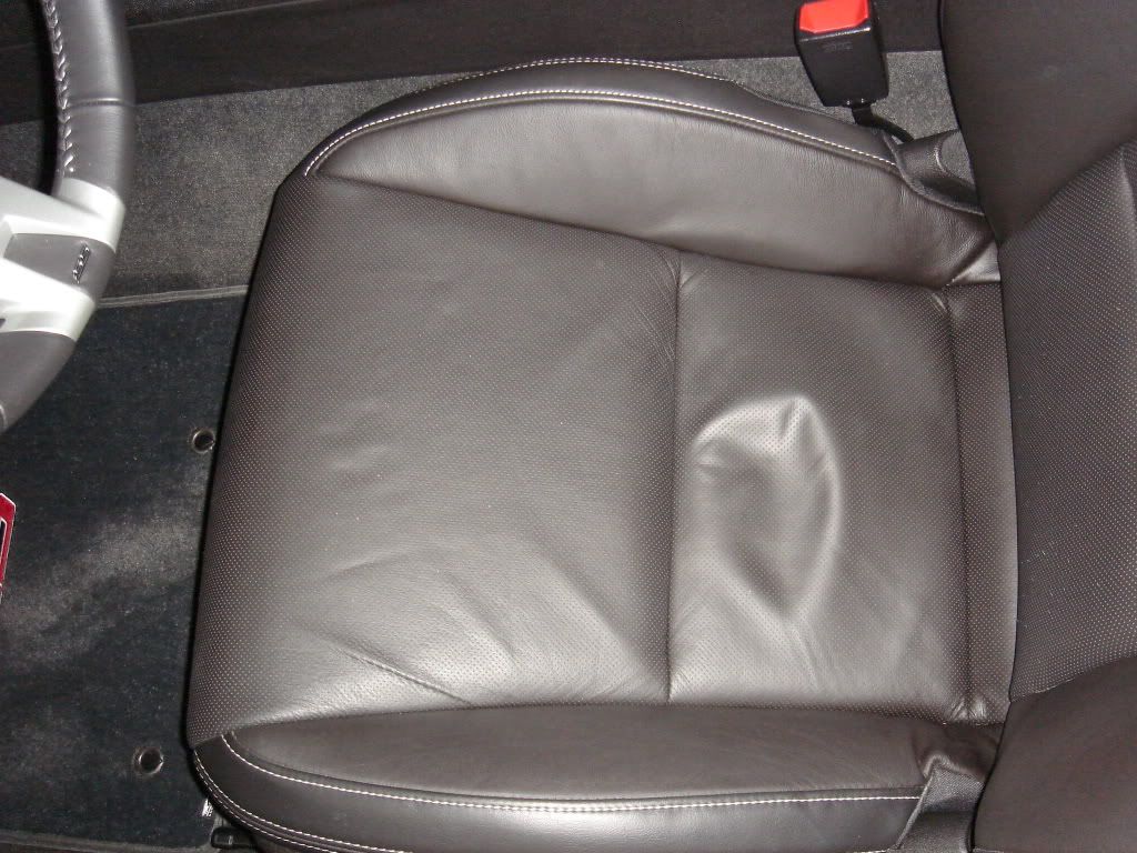

So glad i found this thread. I'm going to the dealer tomorrow and was preparing for a fight over my BADLY stretched and now creased seats. The driver is clearly worse but I'm sure the passenger side will look similar with enough use. Notice the bunched up portion at the forward part of the seat has now folded over and caused a crease. It must be caused by excessive bones protruding from my 170 lb. body.
I am more confident that I can get the dealer to respond now, hopefully with new leather. This started week 1 and I now have 5000 miles.
Here's my pics:
And the passenger side:
OBSSEST is offline   Reply With Quote

I would think that should be covered by the warranty.
Mine is the same way. It's been like that since it was practically new. There might be a recall on that. See bulletin # 09312. This # is what is printed on something I got from the dealer when the service guy ran my vin#. I've been meaning to ask them about it.
