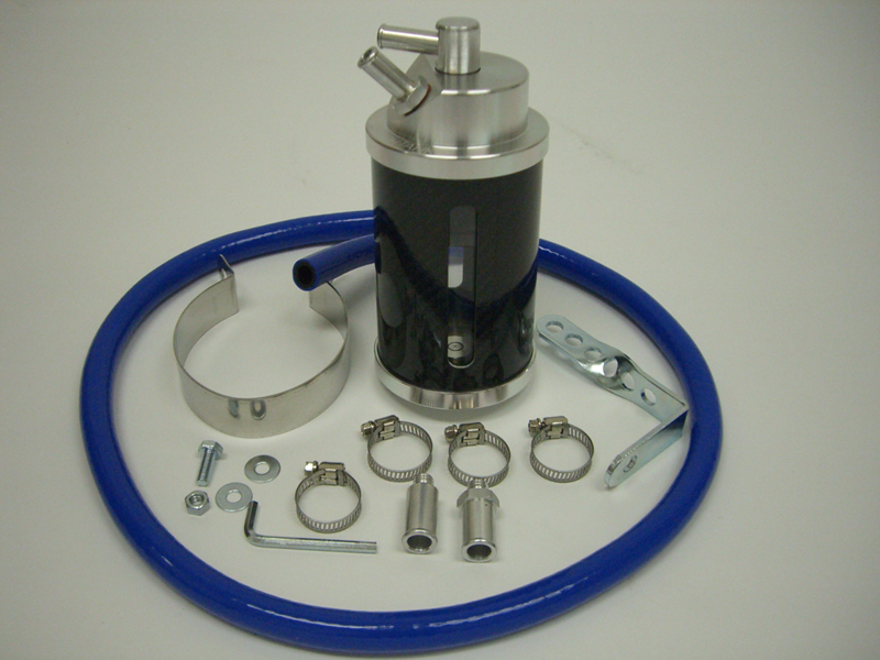

Here is one that works great, and looks better than the rest.
Made of carbon fiber, with a clear window so you can see how much oil is in it.
And only $75!!
http://prosportgauges.com/carbon-fib...catch-can.aspx

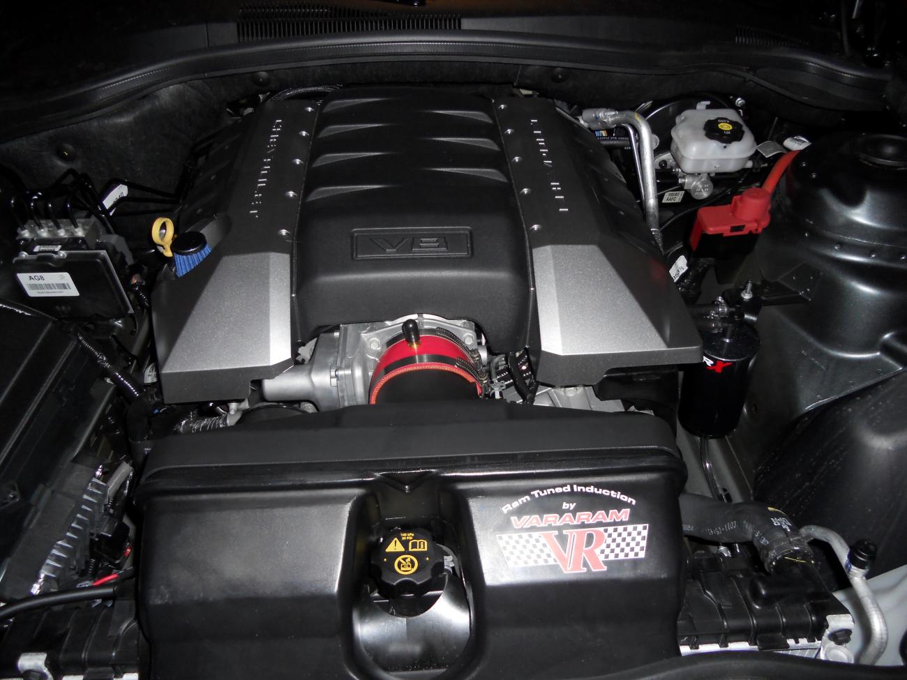

RX! Comes custom painted too! PM SC2150!
2011 1SS/LS3 M6--Vararam CAI-Corsa catback-Dynatech LTs-RX Catch Can-Vmax ported TB-Eibach Springs-Night Fury Camshaft- 486RWHP/458 TQ
