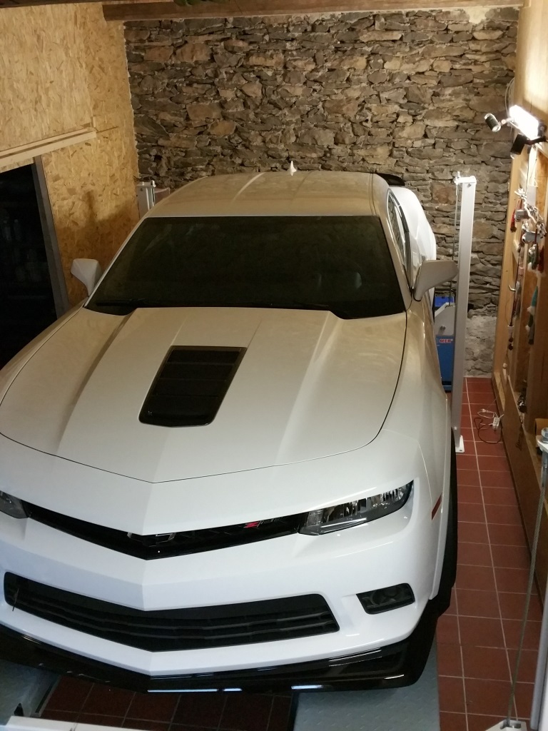

First of all I want to give you an impression of the Z/28 home.
I've got a new 4 post stand because the Z/28 has to share his home with my daily driver.

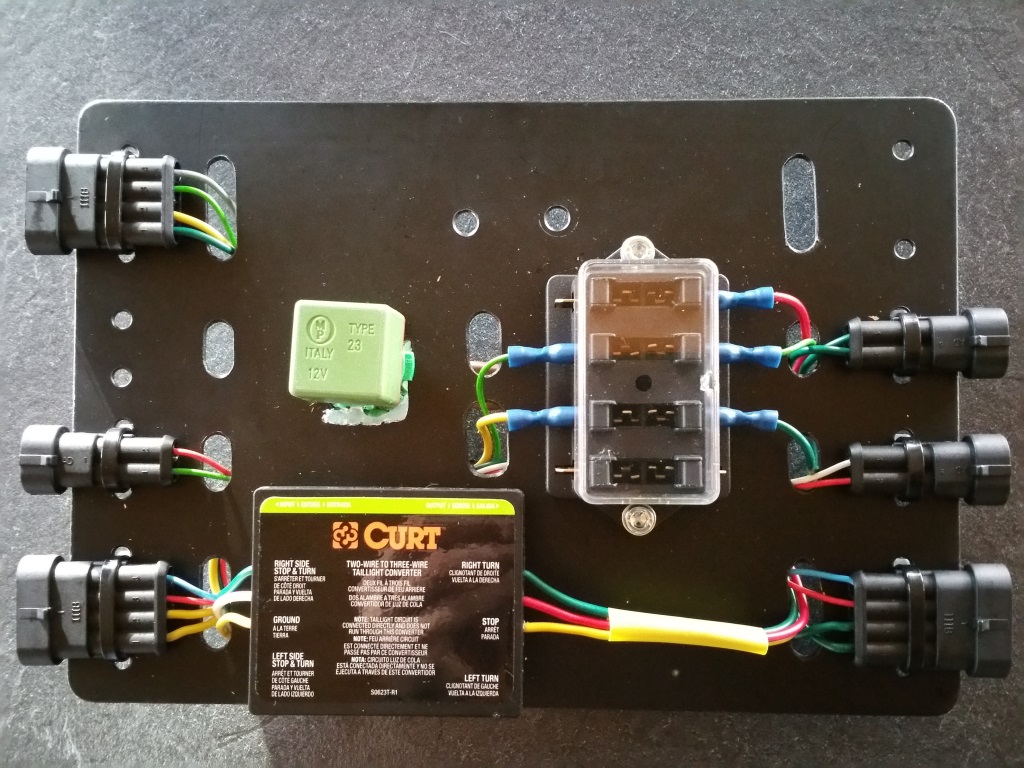

Elektric Adapter Board
My first aproach to divide the combined brake-turn-signal with the CURT module was unfortunately not targeting
The module is unable for a correct hazard flasher.
The logic behind the module is:
- signal on one side -> turn signal
- signal on both sides -> brake signal
So the hazard flasher is resulting in flashing brake lights.
Unfortunately I've found the info about this behaviour too late on the
CURT FAQ's and on the German Camaro forum.
So it was time for a rework of the board...

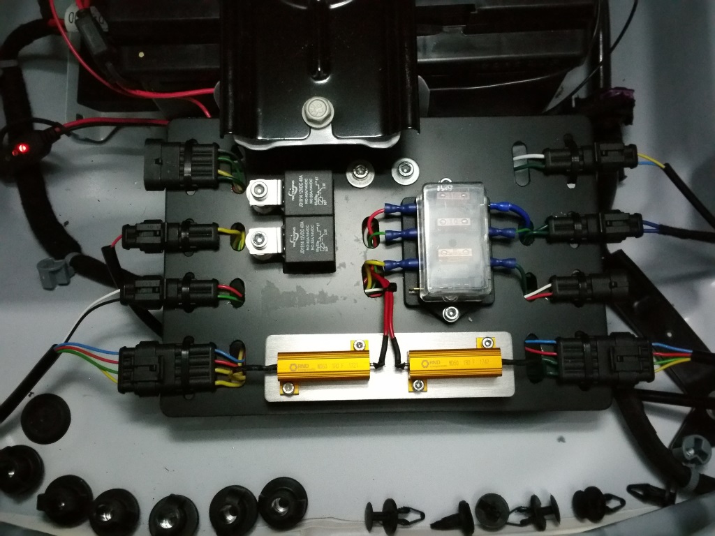

Reworked Board
My target with the CURT module was to avoid a long routing of cables.
But for the rework I've got to do it.
The turn signal I've took from the front.
I've used some switchback LED's for the DRL.
In parallel I've connected the front side markers and the rear turn signal.
In Germany the side markers are not street legal.
With the parallel connected turn signals to the front DRL I need no resistor
to avoid the error message because of the missing bulb.
In the rear I've cut the original brake-turn-signal
and used a 2Ohm 50W resistor to avoid the error message.
The signal for the brake light I've took from the 3rd brake light in the trunk lid
and draw the voltage over a relay directly from the battery.
The board is placed next the battery.
The second relay on the board is for the rear fog lights.
So from lights point of view the Z/28 is now street legal

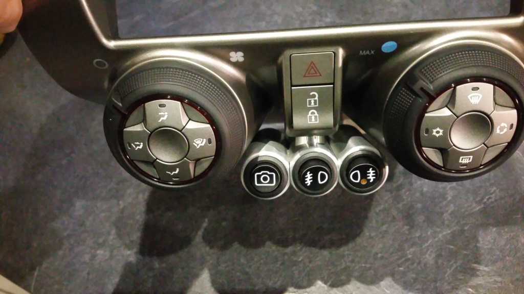

Additional Switches
For homologation rear fog lamps are required.
But where to find a lovely place for the additional switches
After some evenings I've found this solution:

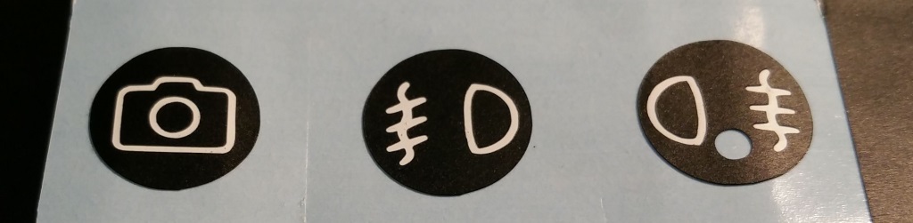

- 3 aluminium tubes
- 3 simple switches
- plottered labels for the switches
I'm happy with the appearance

looks great! What's the camera button for?
Have you driven it yet?
pat_t is offline   Reply With Quote
Old 02-02-2018, 04:22 PM   #38
1erMQP
1erMQP's Avatar
Drives: 15 Z/28 #605
Join Date: Aug 2017
Location: Germany
Posts: 47
Not driven yet.
My season license plate will be from april till october.
So 8 weeks hibernation time left.
Because of the poor view when parking in small slots
I've installed a front and rear cam in combination with a PAC dash kit
and a KENWOOD DMX7017DABS.
The KENWOOD has only one video input.
With the camera button I can switch between front and rear cam.
