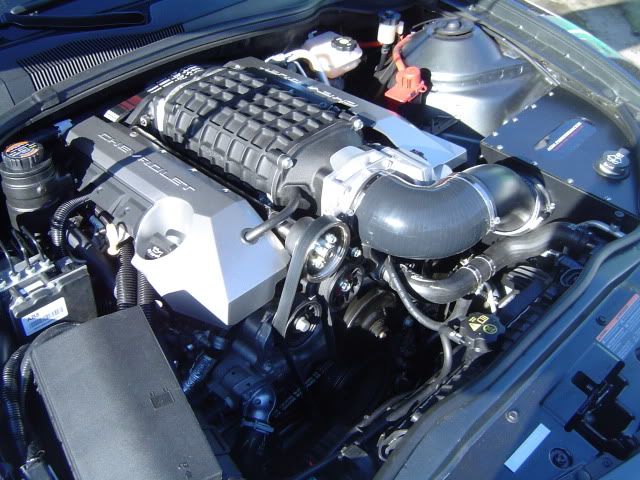

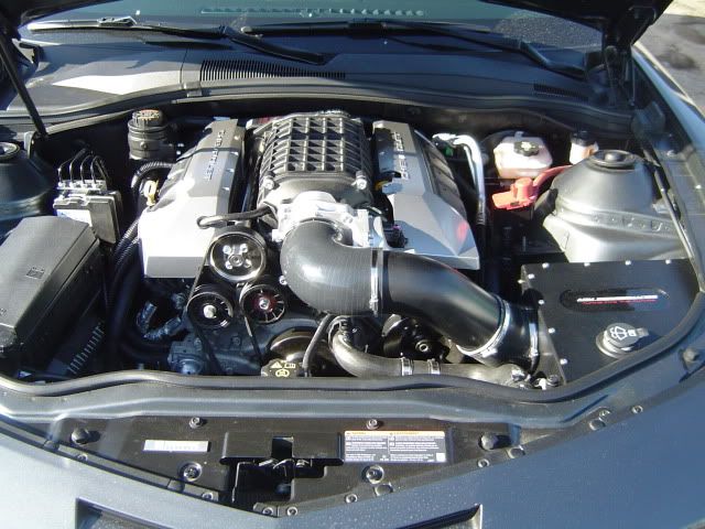

[QUOTE=ADM PERFORMANCE;1004059]Excellent pictures guys.
I want to make a couple changes to both your Installs.
The N/A car(car with no supercharger) needs to loosen all the hose clamps ans rotate the 45 degree hose more straight up and down not more toward the radiator hose like the pic shows.You will notice the 4" powder coated pipe will want to find its way into the 90 and 45 degree slightly more.
Also on this car I will have to agree with the s/c owners reply on running the maf wires on the backside of the power steering pump as it is a better idea.
(you will need to remove the tye wrap)
Also I like to see the 3/8 valve cover vent hose tyed to the Throttlebody Wiring just aft of the connector by .1-.2 inches.This will hold that hose better away from the pulleys and what not.
The valve cover is not a ground(it is completely rubber isolated).Here is were we like to put the ground stud.
ON THE S/C CAR
I would also rotate the 4" powder coated pipe and 45 elbow a bit more aft away from the upper radiator hose.
All these items will be added to our instructions as they are very helpful.
Andit looks like the ac line down by the bottom of the box neds to be bent inward a little more for mor clearence on the box

here my install it looks like i got the 4 inch intake pipe on backwards does it make a difference ?
