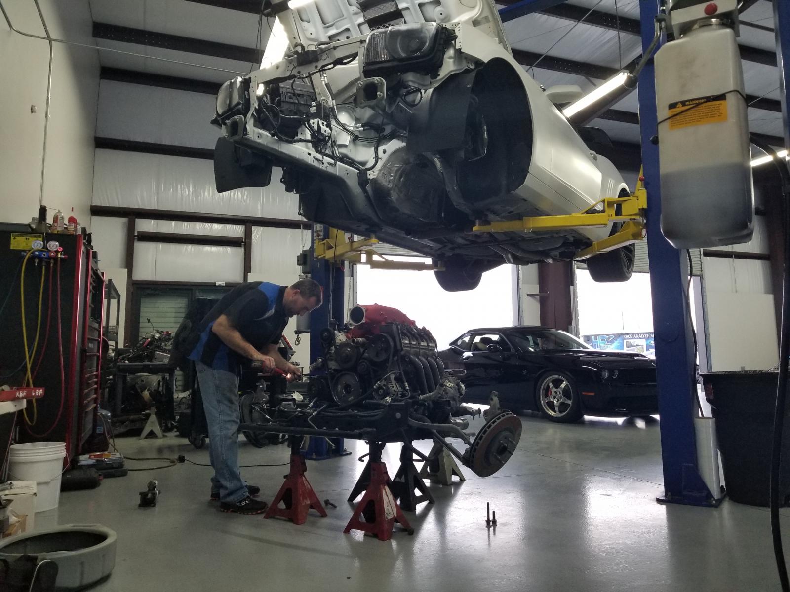

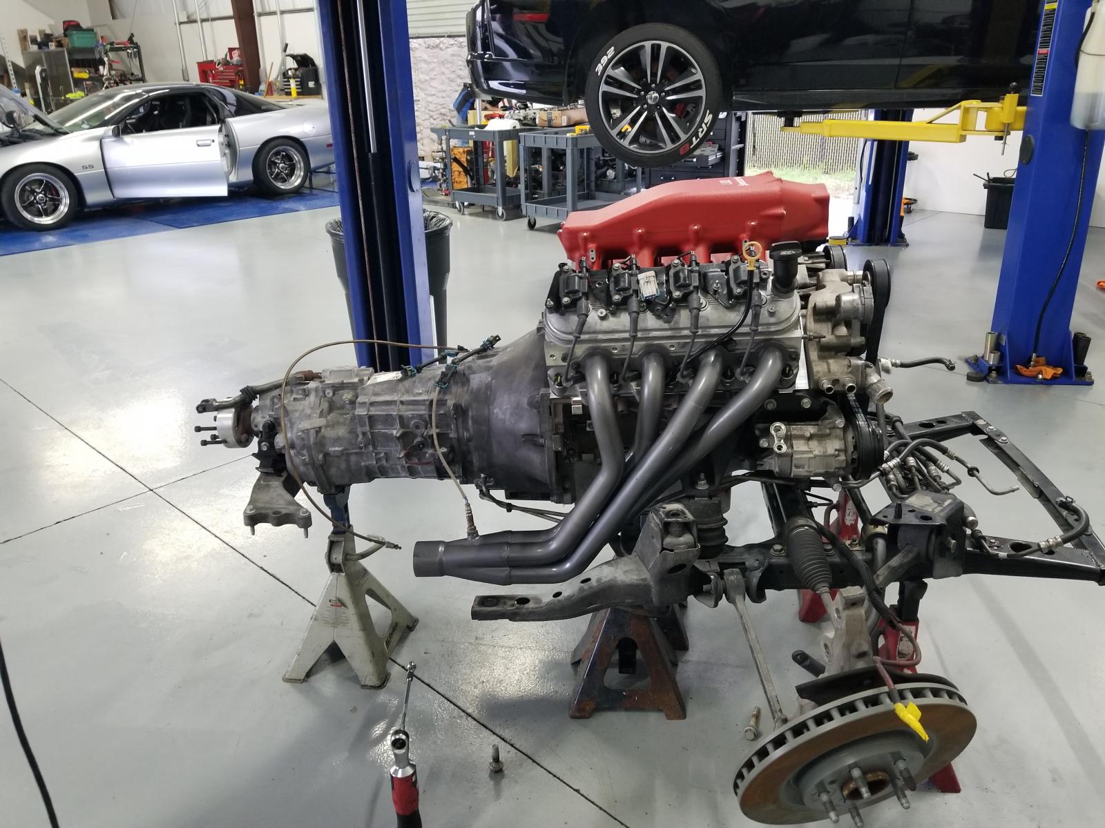

Glad to hear that you're happy with you X1 manifold Clark. The wrinkle black looks great on a summit white car. For everyone wondering what it's capable of above 7k perhaps we can help. This is our shop 5th gen, we're finishing up the install of the new engine just in time for TX2K down here in houston at peitz performance tuning. Once everything is broken in it'll safely turn 7500+

Ask and you shall recive. This motor going in is a 5.3 sleeved to a 4.185 bore with a 4 inch stroke. Dart pro 1 heads ported by SPS in Washington state. X1 intake (of course) and 2 inch primaries to a 3 inch x pipe on spintech mufflers.

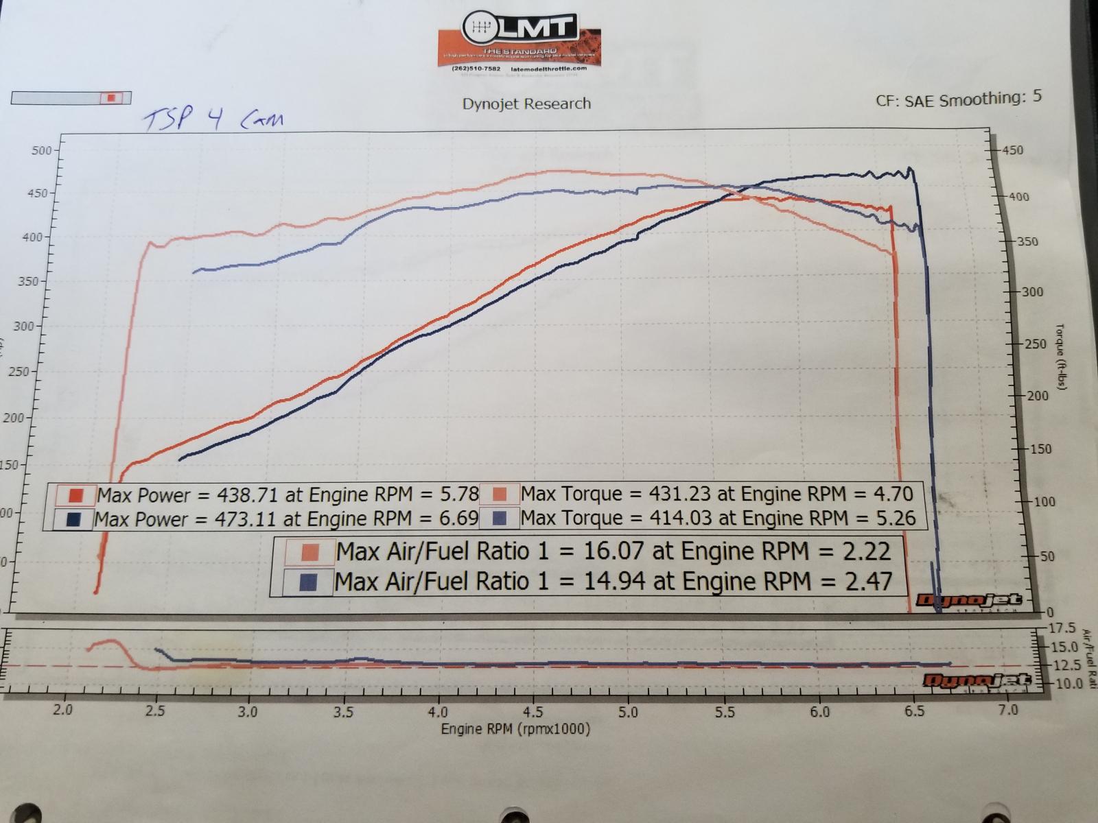

I don't know why everyone keeps talking about the Runner length on his new intake. His torque numbers were the same with the stock LS3 intake. I had never seen a torque # that low with that TSP Cam and the stock intake. That's what I was trying to come up with an answer for. I think everyone understands short runners = more HP less tq. and long runners = less HP and more to. That is why I put the MSD intake on mine instead of the LS7. The MSD has a 1" shorter and moved my power back about 4-500 rpm's

I agree it was strange... tuner said it was the gears. Maybe it was something in the tune? Not sure... but it's irrelevant at this point....

This is the graph from the cam tune...

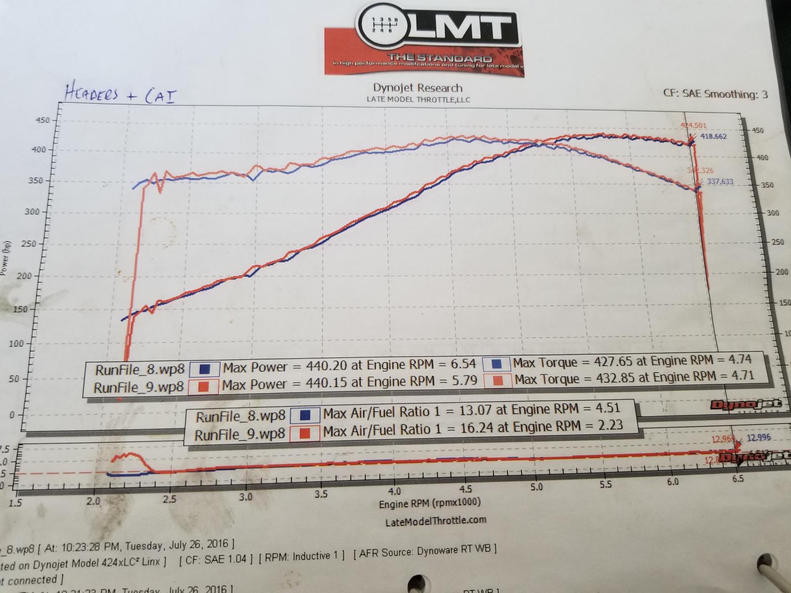

This one's is from the headers and z28 cai...
