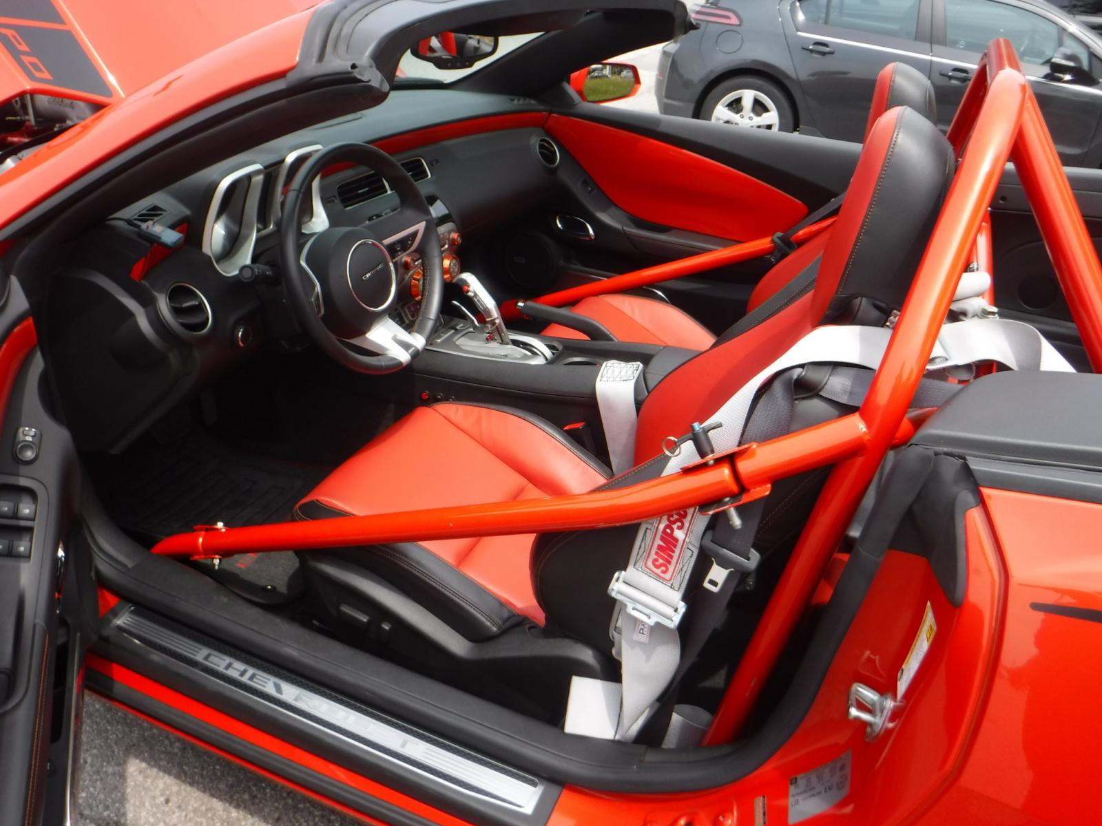

get a fairly easy bolt in RPM 6 point roll bar, if you move further then sub frame connectors. all not alot of money compared to the mods.

How much weight was added to the car with that roll bar

That roll bar was chrome moly so very light less than 100 my guess.
Also dynoed at 1007 RWHP.
Attachment 875123
I've been looking for something like this for my car. Do you know what company makes that or where I can purchase a 6 point roll bar like that?
