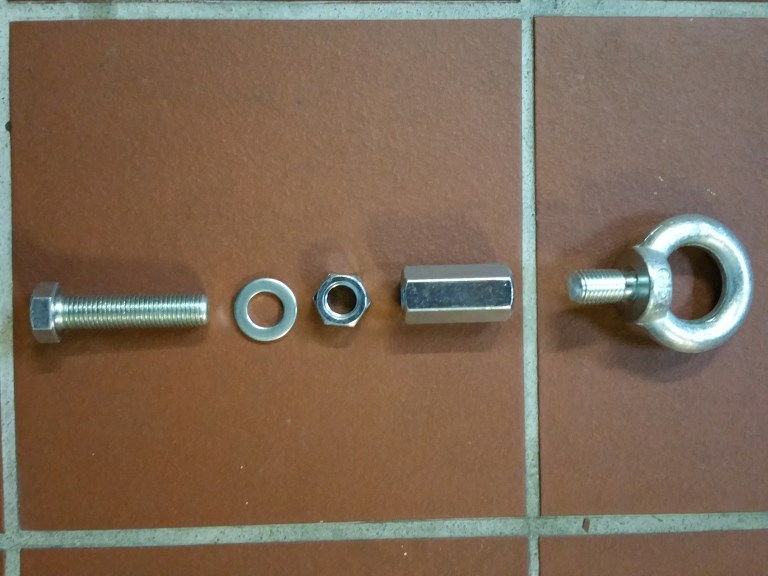

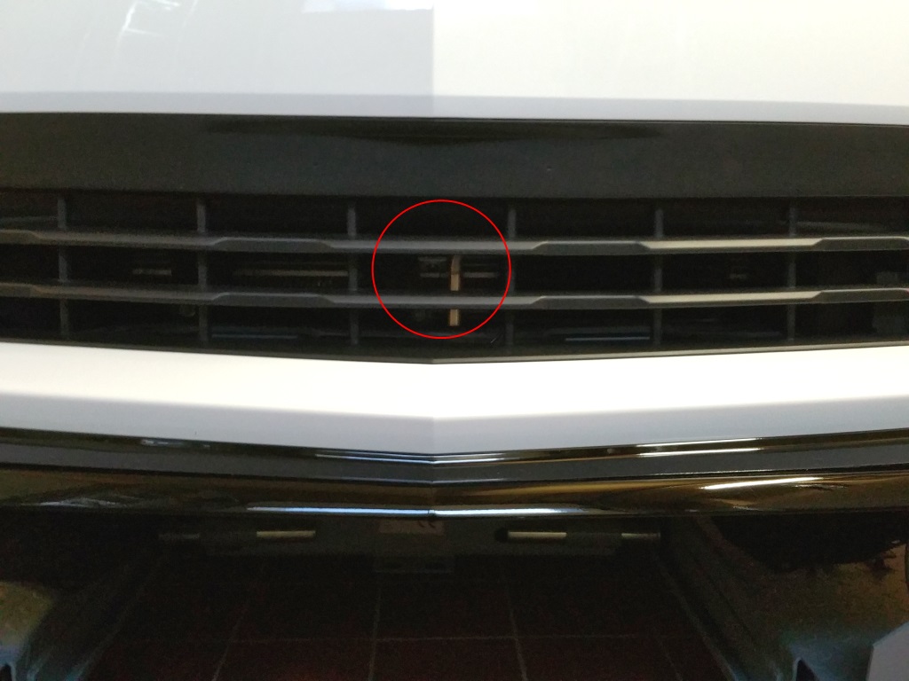

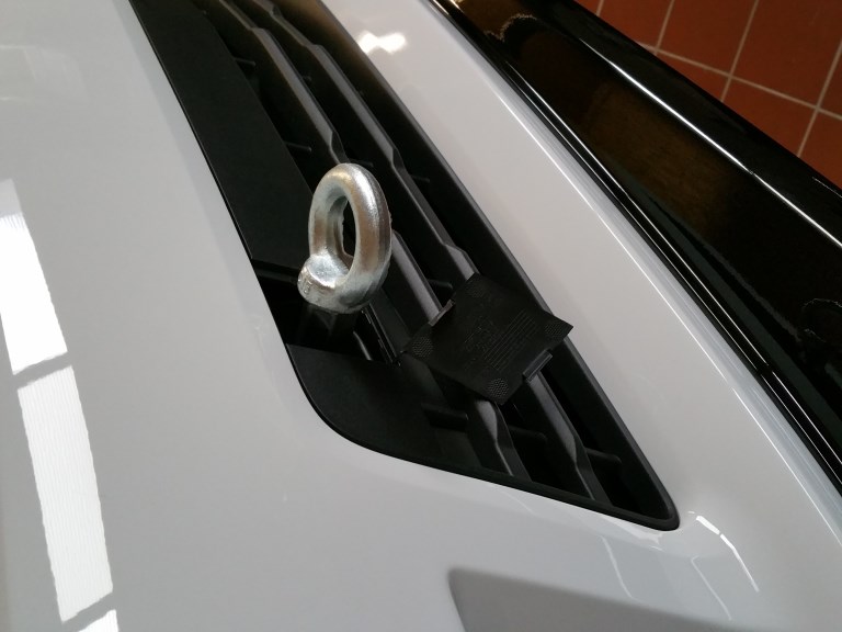

For homologation I need only a front tow hook.
Therefore I've used some standard parts with thread M16.
After drilling a whole I want to put the screw from the backside through the front bumper.
But not so easy to find the whole from the backside.
I used a tow wire for fishing the screw.
The screw head is fixed so tightening from the front is no problem.

Interesting approach. You are using a lifting eye. A lifting eye only has structural
intergreity when lifting vertically. The grade of hardware you are using is not
suuicient for the load that will be encountered.

Should be no propblem, is more solid than other OEM tow hook solutions.

As you think. Trust you will not find out the hard way.

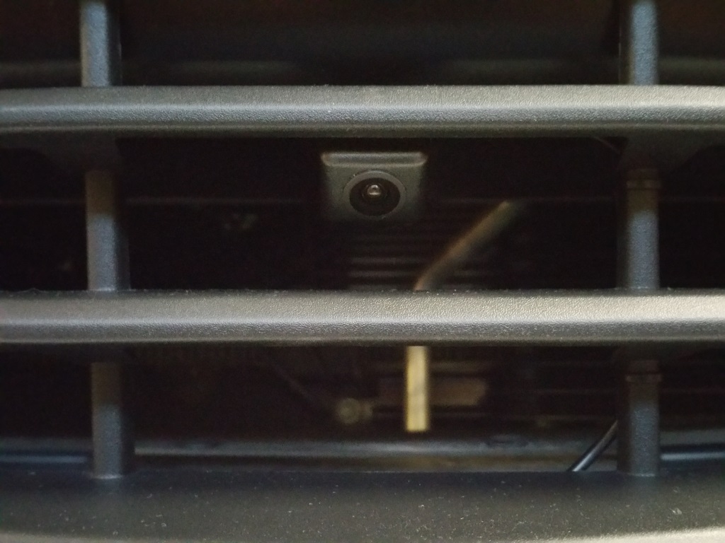

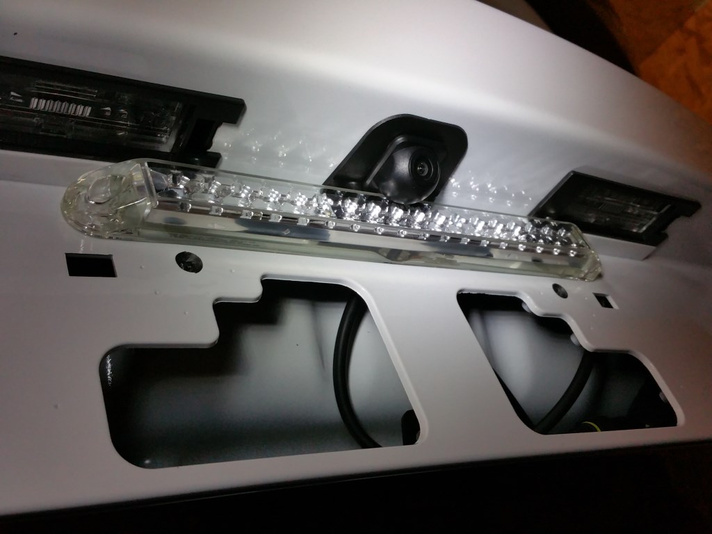

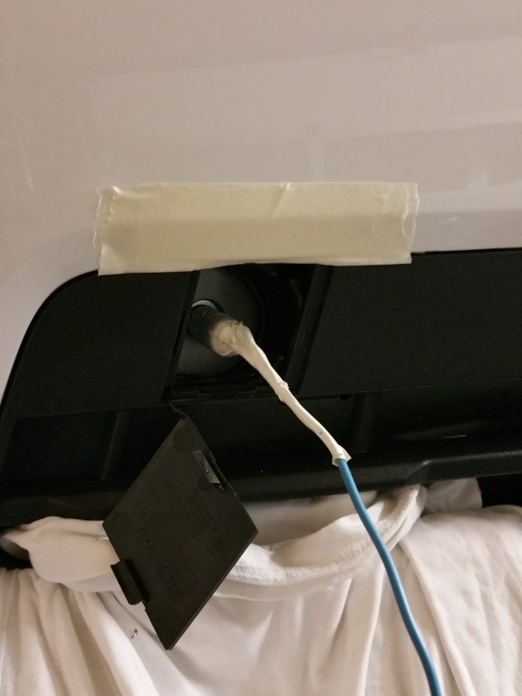

Originally Posted by 1erMQP View Post
Not driven yet.
My season license plate will be from april till october.
So 8 weeks hibernation time left.
Because of the poor view when parking in small slots
I've installed a front and rear cam in combination with a PAC dash kit
and a KENWOOD DMX7017DABS.
The KENWOOD has only one video input.
With the camera button I can switch between front and rear cam.
Here's a short update on the cameras.
The front one is nearly unnoticeable.
For the rear I've modified the cover of the original camera module.
Hopefully the the cameras will prevent the Z/28 from contacts when parking.
1erMQP is offline   Reply With Quote

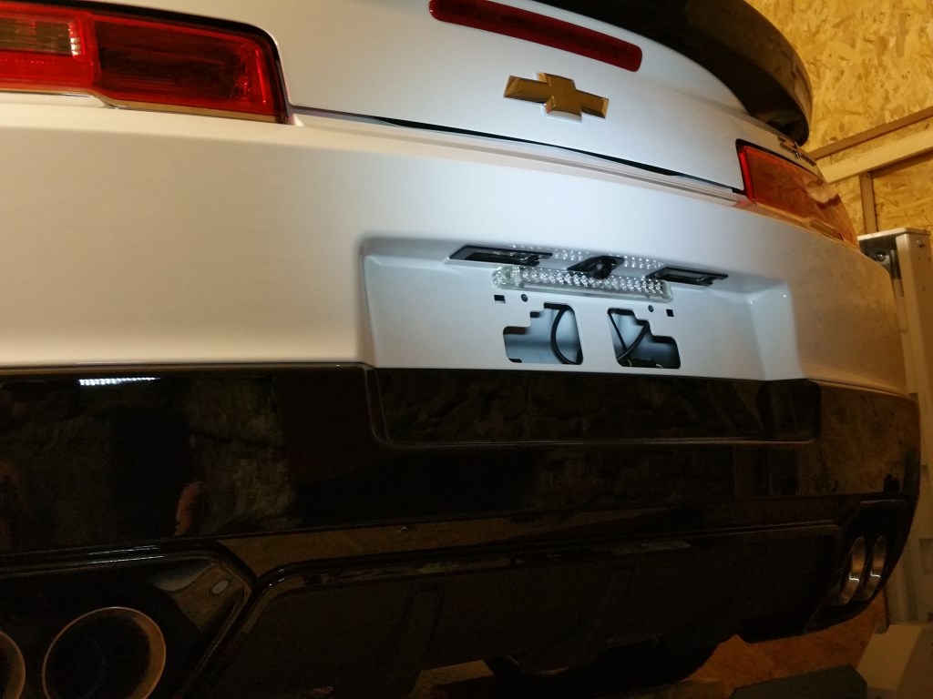

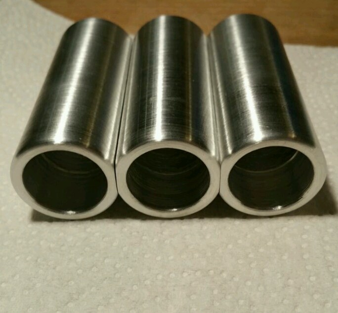

For homologation rear fog lamps are required.
But where to find a lovely place for the additional switches
After some evenings I've found this solution:
- 3 aluminium tubes
- 3 simple switches
- plottered labels for the switches
I'm happy with the appearance
More info on how you made these and the parts used..looks very good!!

Sweet! I'm totally stealing this idea!!! Thank you!!! Parking with the front lip parking is a pain!
Which camera model/brand did you end up using?
What you need is a lathe and a milling machine to do the mechanical work on the aluminium parts. 3 Tubes are the base for the projekt.
Sorry that I can't provide more infos on that
Next project will be documented better.

Used some very cheap models.
Front cam:
https://www.ebay.de/itm/Mini-170-AUT...item33ea27ae1a
Rear cam:
https://www.ebay.de/itm/0-3LUX-MINI-...QAAOSwH~laqQS0
