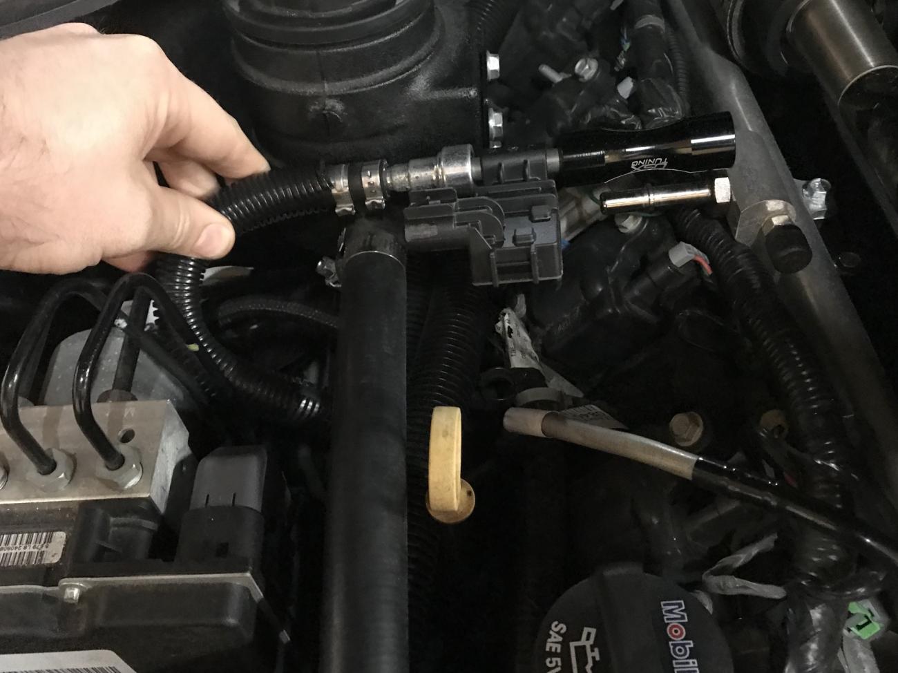

Trying to put on the DSX flex fuel kit and the fuel line that came with TVS2300 kinks if I try connecting sensor to fuel rail then TVS fuel line into it.
Any suggestions or pictures of what you did? Also now I can’t get the tool in to release the fuel line from sensor...not enough gap for it to fit.

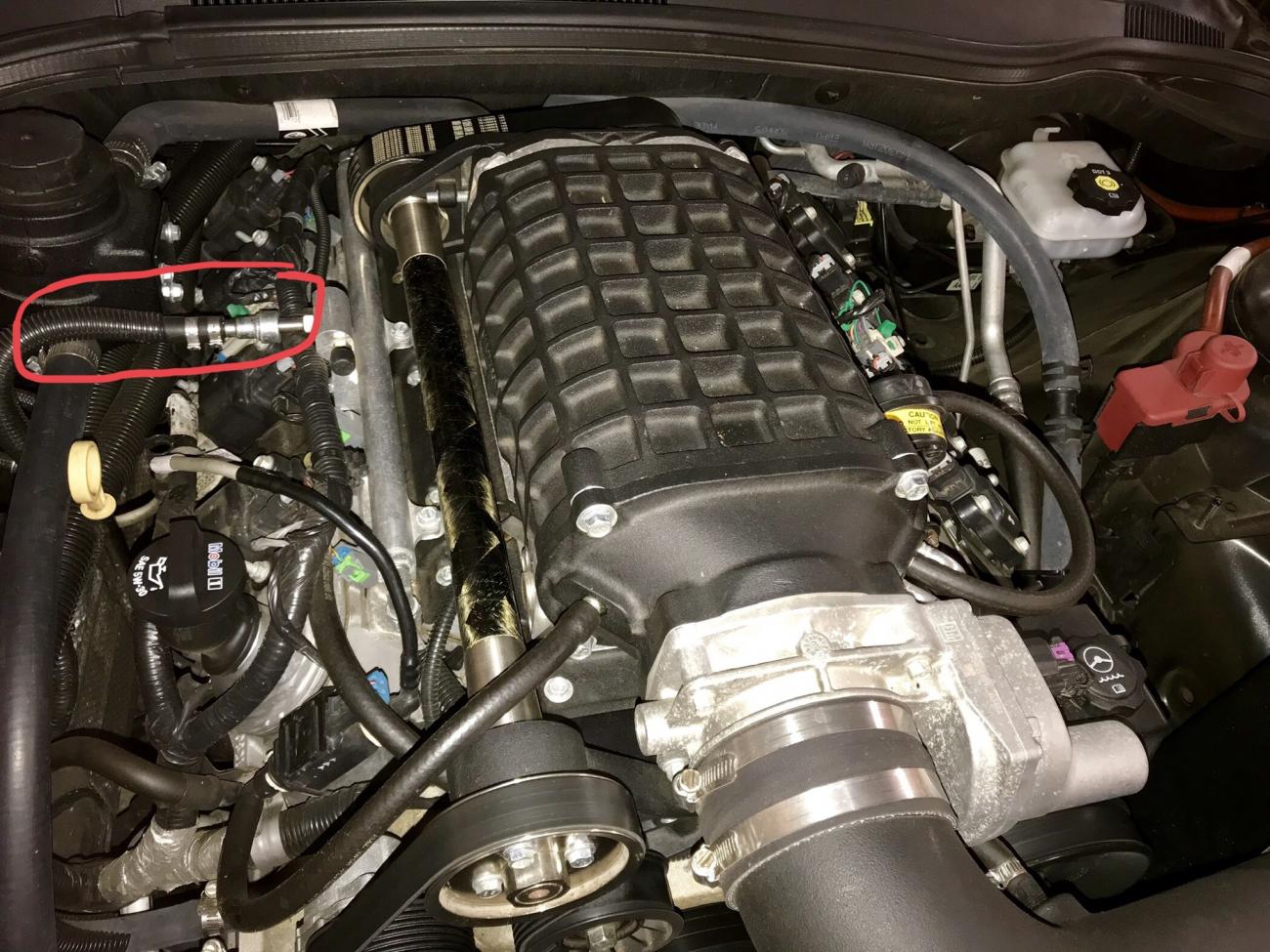

This is fuel line that I attached flex fuel. So the line kinks to the left side. I’ll try to get picture later of the setup with kink.

I didn’t put the sensor back on rail because it was a pain to get off but should be able to see where the line will link or the left side. Also see not enough space to get tool to remove sensor from fuel line.
Any suggestions?

Break off the pieces of the disconnect tool that actually need to get in there, and use a screwdriver or two to push them in and release the clips. That's how I unhook them.
The bummer is that the connection point is so damn close and their hose is so short that there aren't a lot of options. You may be better off with a custom hose.

Do you recommend putting sensor on rail or line coming up to engine bay? Does the direction of flow matter?
Thinking either longer hose or one with a 90*...any suggestions best/easiest place to find hose already made or items to make custom hose?
