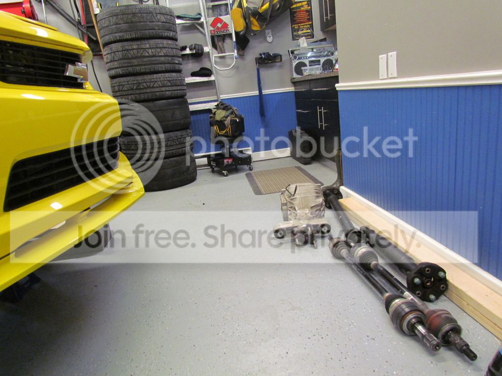

Vegas Bound
Drives: 2013 Sparkly Red One
Join Date: Dec 2018
Location: Hospitality State
Posts: 2,558
Originally Posted by Moto-Mojo View Post
Based on my ‘extensive’ reading here, (ha) ZL1 half shafts will be a must. But be prepared, you’ll pretty much be building a ZL1 around that crate!
That's basically what I did. But I swapped out the parts before they broke. My garage is full of stock SS parts including the LS3 with 651 miles on it.

Posts: 4,265
You must be hangin’ onto them to possibly use. I’m sure there’s some wrenches here who’d buy that stock stuff. But yeah, many pages of threads here. Sometimes, if you can afford it, it’s better to just buy it. But I know people like to build it too. I applaud those who do. Beyond my skill and patience!

Vegas Bound
Join Date: Dec 2018
Posts: 2,558
I took out the stock stuff as to not break it so I can put it back in some day.
I built it the way I wanted it for now. So you can kiss my ass with your buy it vs build comment.
