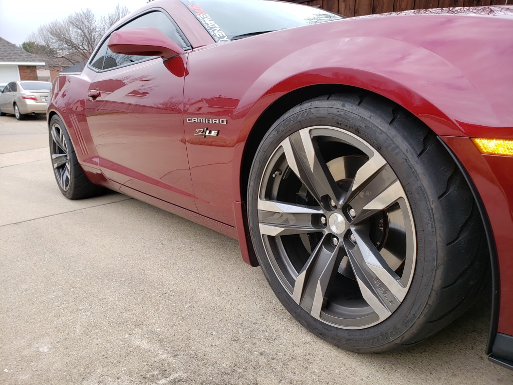

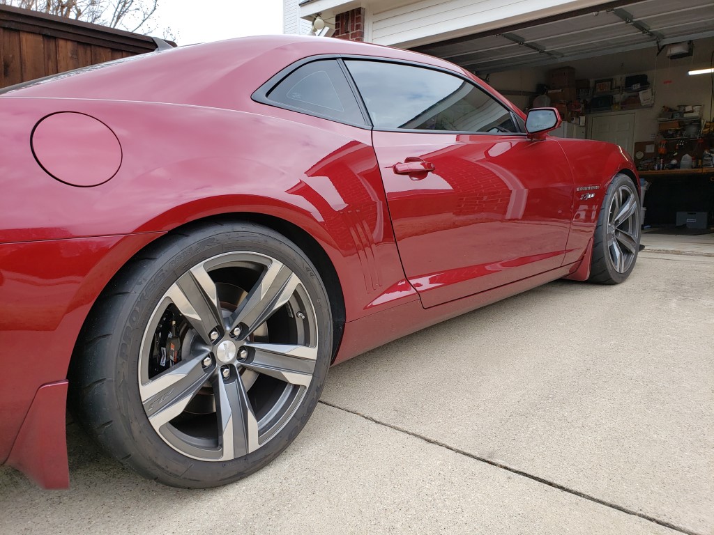

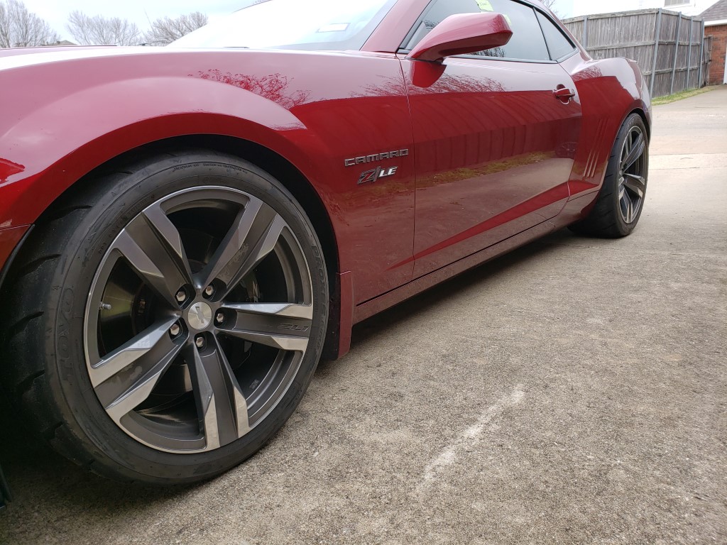

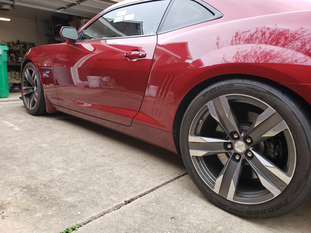

Final ride height adjustments completed!
Set all 4 corners to 647MM -- looks nice -- all dampers set to 14:
Next will be the alignment then track prep!

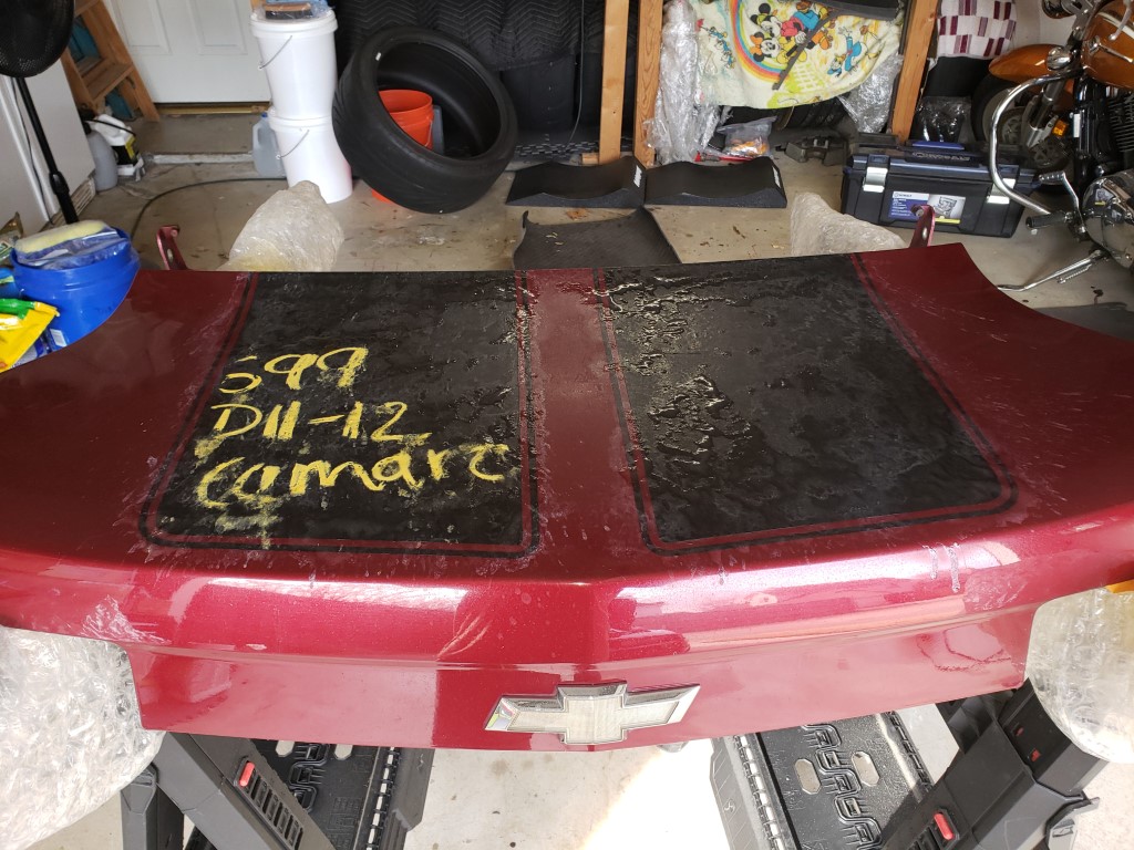

Wing Prep! (Cont.)

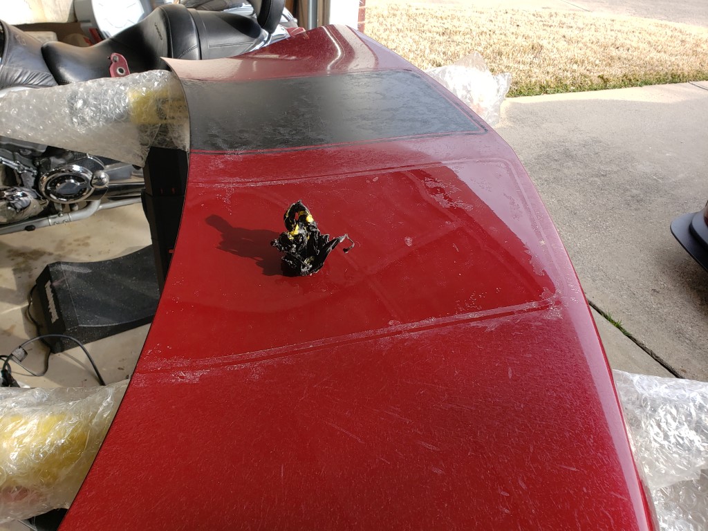

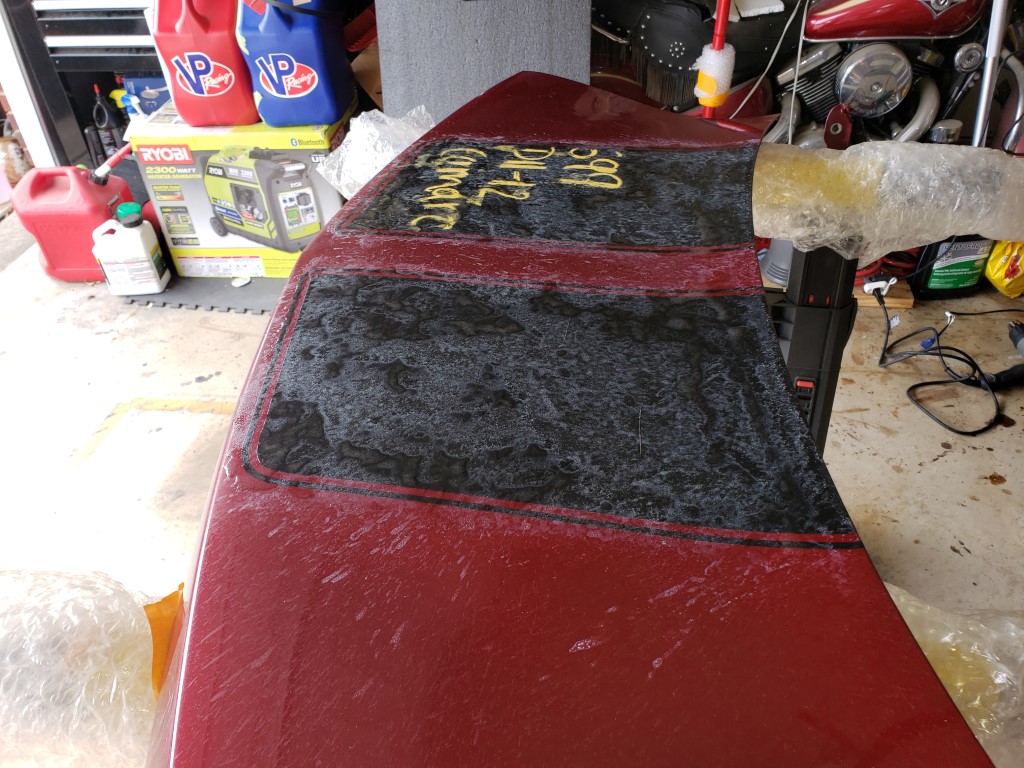

Today, started removing the rally stripes using this:
Spray it on let it sit for 15 minutes:
Using some heat (heat gun) start pulling it up:

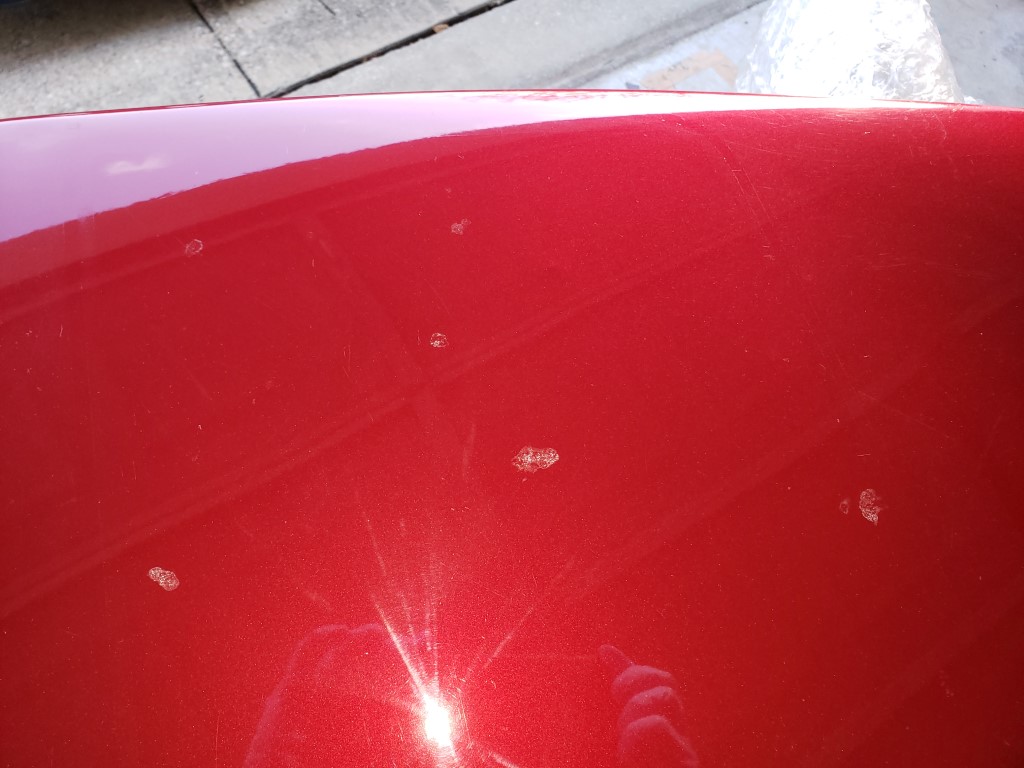

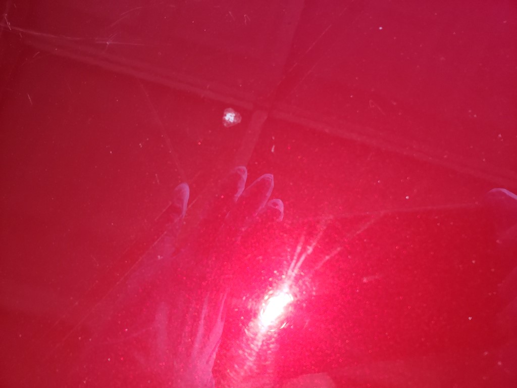

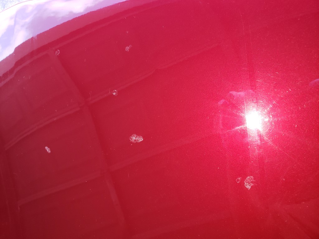

After removing the residue, clay barred the trunk lid, guess what I found 'under' the stripes:
Checked the paint and sure enough, pitted -- was a CRAP paint job @ the factory for sure. The stripes were put on with this bad paint...
So, looks like I'll need to have the top repainted -- went ahead and removed the bowtie. Tried using 2000 grit wet to sand a bit but its badly pitted.
I'll have it painted 'after' the wing is setup so I do it just once...
Figures I'd get a hidden 'crap' GM paint job -- but at least I have all the hardware already and it won't be a bad thing to have it fixed right...

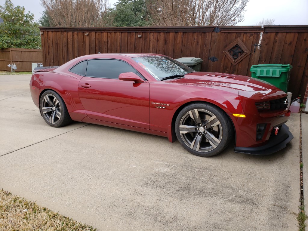

Alignment is done! Folks at 5th Gear did it. Had a hiccup but they took care of it — stand up group of folks there — good people for sure!
Now doing track prep for TMS! After TMS, going to GPI for trans rebuild...
Waiting on wing — gonna get the trunk lid painted fresh... should be sweet when the wing comes in...

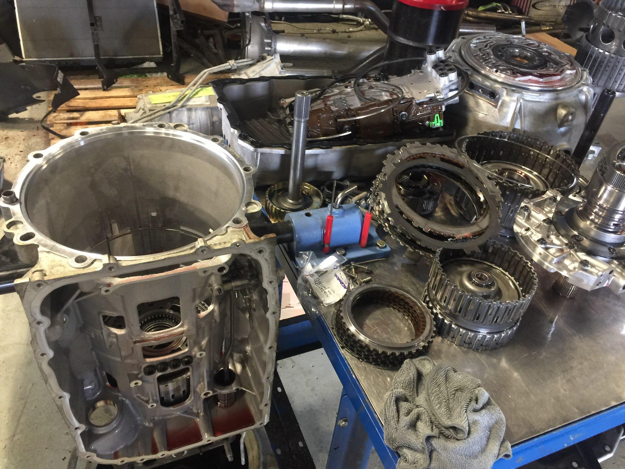

Dropped the car off Monday, On Tuesday, Mike @ GPI had her torn down:
The good news, 4-5-6 showed a bit of heat but NOTHING BROKEN! This 6L80 is a lot tougher than folks believe. 67k miles on her and still in great shape. Changing the oil often has helped for sure. Probably should have put the cooler on sooner but, lesson learned.
So with that, I went with the PATC rebuild kit (with the GPI upgrades), the PATC Billet upgrades, and a ZL1 6L90 torque converter with a TCI 399853 SFI 29.2 certified Flex Plate:
TCI:
About the Flex Plate -- I initially bought the one for the 6L80 (399757) with the multiple torque convert configurations but, did NOT fit the 6L90 torque converter!
GPI order what we 'thought' was the correct one but, it too didn't fit. A call to Circle-D -- they sent us the right one (Circle-D no longer does their billet flex plates so they sent us the TCI).
So that was a 2 day delay - which was my fault as I wanted all 6 bolts and not '3' for the torque converter. GPI worked though that and got it done for me!
So with the PATC/GPI/TCI upgrades, the ZL1 Torque Converter, Ryan set out to tune things up.
And boy, I can tell the difference.
Ryan had to 'test' the setup so while driving around, a nice GT 500 came up -- yea, Ryan said it didn't last long ;o). Ryan said everything just 'works' and is very tight -- really responsive.
Anyway, why the ZL1 Torque converter?
I road race -- not drag -- so stall converter was not in the plans.
The ZL1 Converter is Dual Disk, 300 mm and, stalls around 1800-2000 RPM vs the 6L80 which is 1300-1500 RPM. Now, torque produced moves this stall RPM around but, the ZL1 is built tougher, is a direct fit for the 6L80, was built for supercharged engines, cost effective and, built to race!
Not a bad upgrade and GPI gave me a 'smokin' deal on it!
So after a 300 + mile trip home, trans was so much more responsive, tighter/crisp shifts and just worked!
Considering all the trans work GPI does plus what they've learned from racing, this was an unbelievable upgrade!
I will say, the weather was a bit cold on the way back (high 30's). Trans temps max were 105° and when I got into Dallas, 96° -- I know but, I normally don't drive it when its below 40°.
I don't see any transmission 'heat' issues though when I race this mother! She's built tough!
