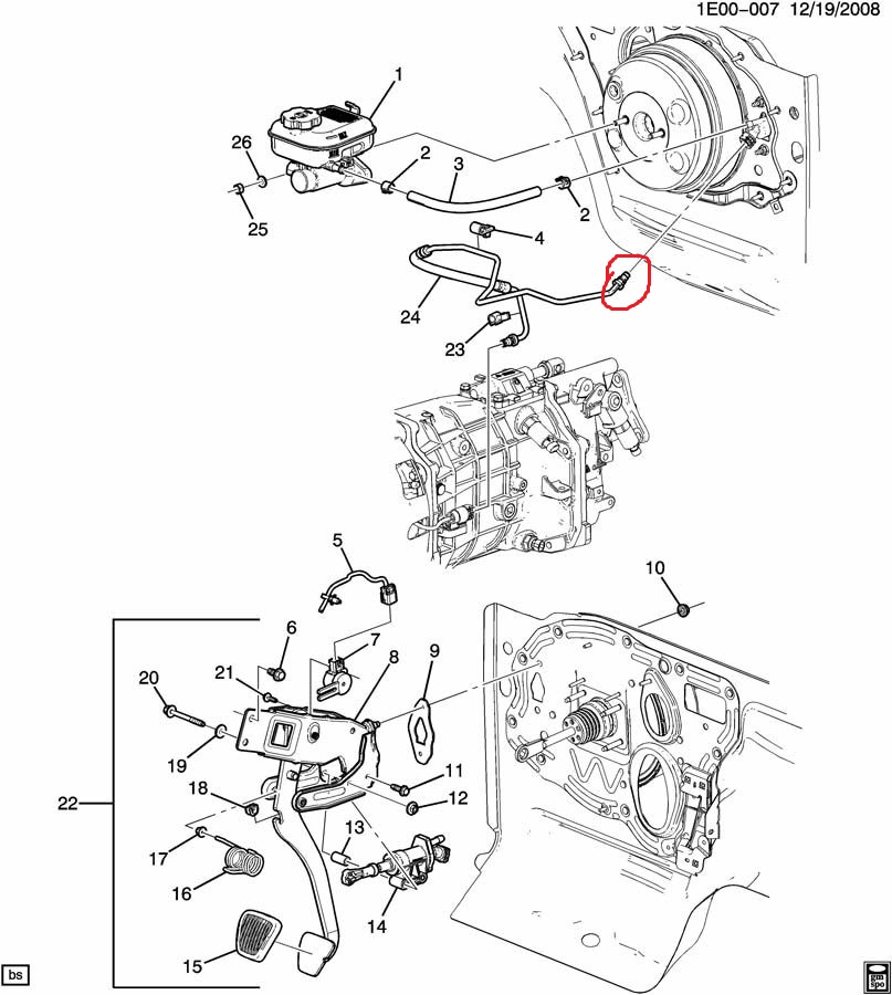

The hard line is not part of the slave cyl...when I did my clutch I replaced the stock line with a braided off of ebay(Tick). I then contacted Tick and had them send me the larger fitting so I could connect the braided line directly to the slave. combined with the speed bleeder and billet bearing support my trans shifts better than ever. did not see the need for a separate reservoir and so far do not see a need to change my mind.

Rubber O-Ring
This part correct?

Very close. The o-ring is installed on the piece that you circled.

That’s exactly where it’s leaking from
