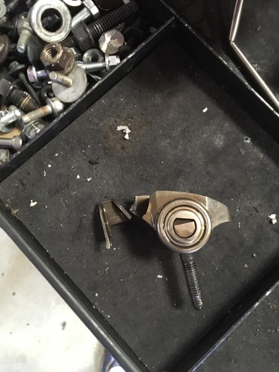

A tale of a broken rocker arm...
Heres a tale for you, Andrew. When I brought my car to GPI last week, I had been experiencing a misfire. I thought it was a spark plug, which, when I swapped them out, that was true. That spark plug was toast and drenched in unburnt fuel. I drove it 6 hours to GPI. When they got the valvecover off to start the trunnion upgrade, they found an oem rocker arm had broken right off on the valve side! The rocker, at that point, looked more like a set of fangs that were literally chewing up the valve retainer.
Here's the rocker.

This is a titanium valve retainer. It miraculously held onto the valve under heavy pummeling from the evil, broken rocker. If it failed and its valve were to drop, we knew that catastrophic failure could have ensued. Imagine a valve falling into a cylinder and meeting up with a piston which then punches it straight back up into the combustion chamber..
My shop said that I was unbelievably lucky that the valve didn't drop, and that the odds of this situation happening are slim to none. They said if it hadn't been a titanium retainer it undoubtedly would have failed. To be fair, I have a pretty loud car, making it a bit more difficult to hear abnormalities, but I didn't hear it. I definitely had a lot of power loss though, since I was running on 7 cylinders.

Wow - that's EXTREMELY lucky. That's incredible it held together and didn't cost you a motor. Every time I see something like this posted I wanna go rip the valve covers off and just have a look at things to be sure! I'm really glad you didn't get burned by this - go buy a lotto ticket (and share with your friends )
Haha yeah that woulda been a disaster. At least it didnt take the needle bearings out along with it, too. It could have been ridiculous.
