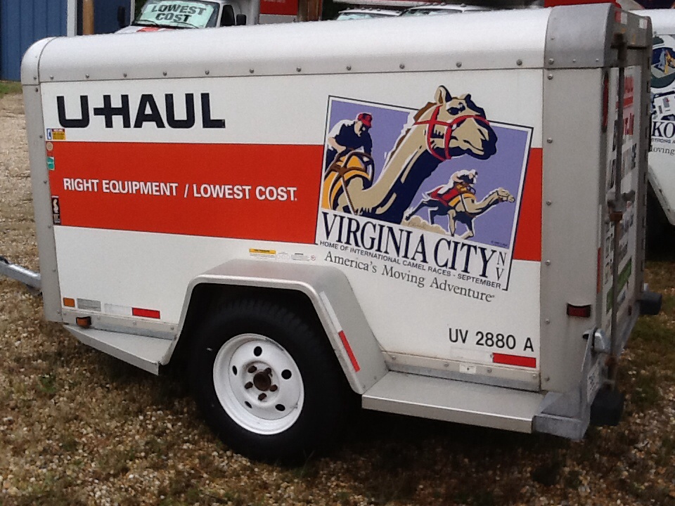

Something like this?
I was thinking it could totally tow a Uhaul trailer, it has the weight and power.

The manual states tow capacity is 1,000 lbs, and remember that includes the trailer. A small u-haul enclosed trailer (4x8) weighs 850 lbs, leaving you with 150 lbs for cargo. Probably less than if you'd just put something in the trunk.
