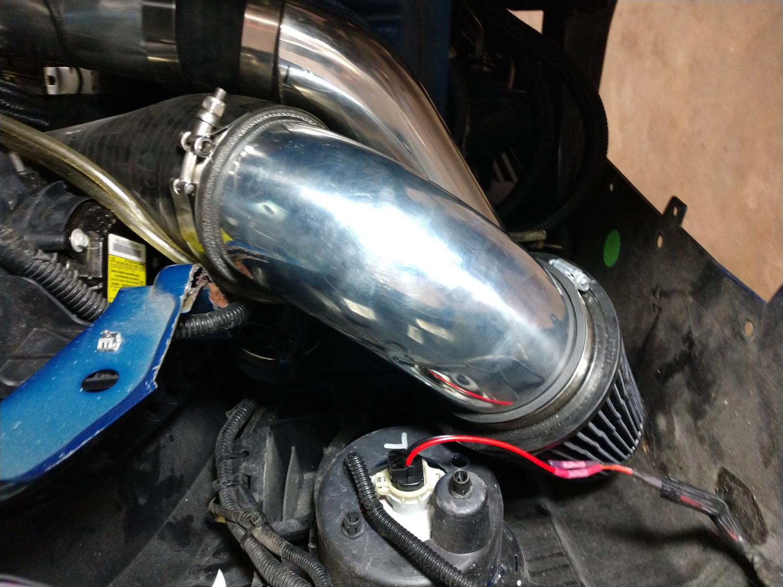

This pic shows how I installed an air filter. I used a Cobra head on the turbo, then a four inch 90 degree aluminum elbow to an eight inch K&N cone filter.

I ran mine the same way to the same KN filter. I used the elbow off my old CAI. That is one mighty tight spot to route some cold air my friend. Hope you enjoy yours.

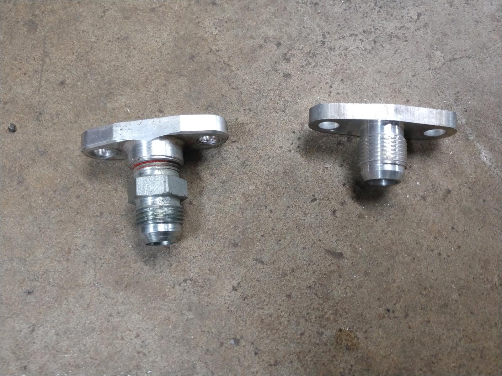

I had to change the turbo drain fitting to the extended one. With the short one piece fitting, you couldn't tighten the drain hose A/N line end. It hit the turbo housing. Extending it a bit was the cure.

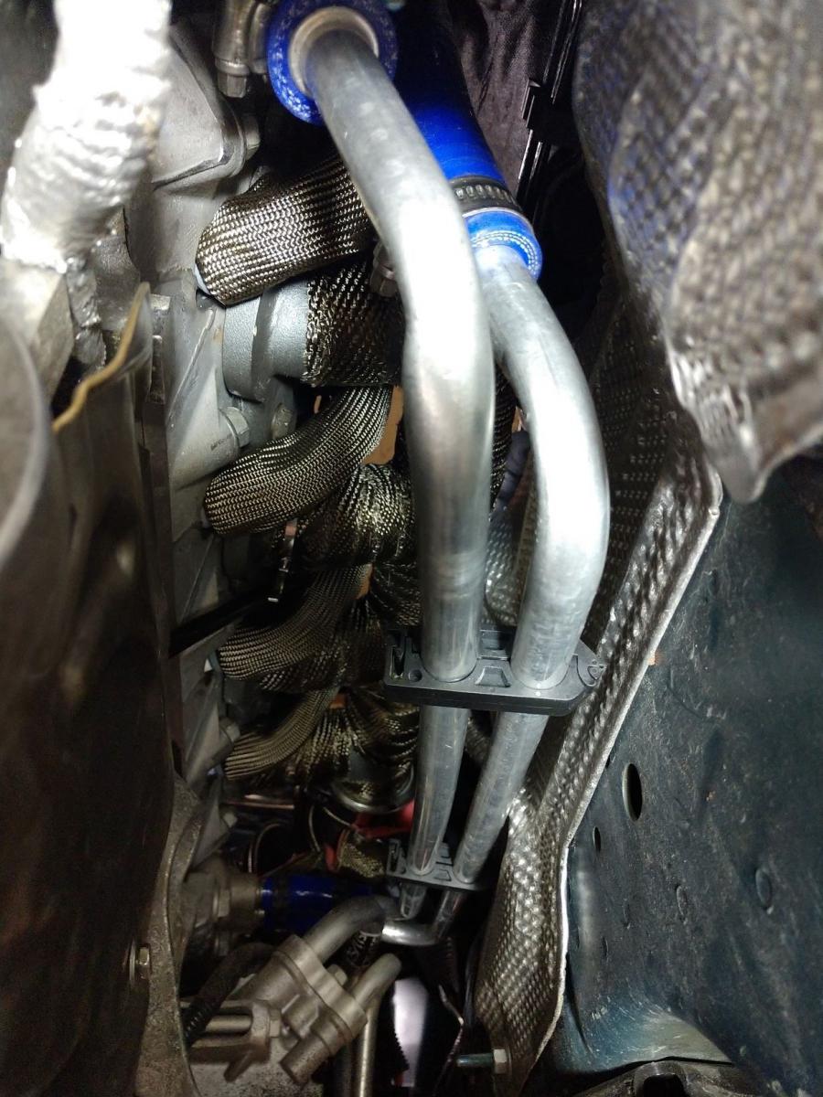

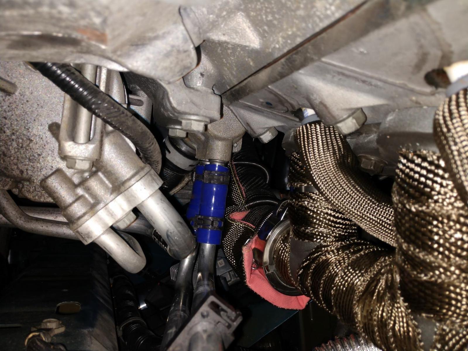

Connecting the heater hoses was a little different since I had changed the stock ones years ago. I clocked (or twisted) the aluminum pipes about 75 degrees, and used some silicone hoses I got from DO88, the same place I got the Cobra head from.
