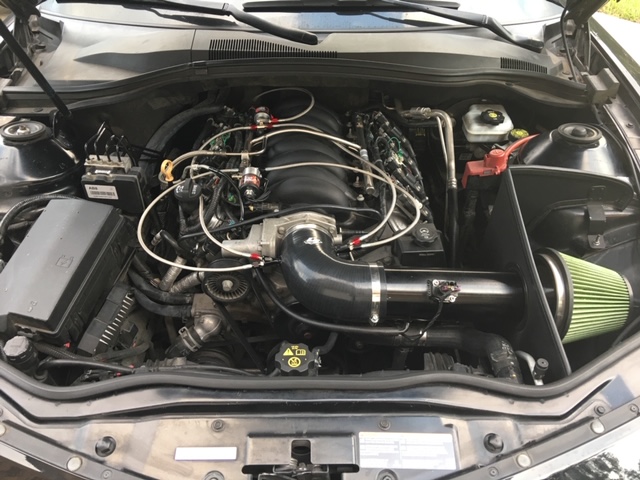

Of course some back history on this cars previous setups before we get into the ongoing project.
Setup #1
England Green Meyhem II cam kit
TSP 1 7/8 headers
GCR Cold Air
474/440 to the tire
Setup #2
Cam Motion 236/246 .640/.630 113+3 solid roller cam
Stock heads
TSP 1 7/8 intake
LG Velocity Intake
Nitrous Outlet Dual Nozzle kit
17" welds
500rwhp on motor sprayed a 150 shot.
Setup #3
Same as above but swapped nitrous kit for an LSA kit
2.45 upper stock lower
id850's zl1 pump
All LPE cooling mods w/ DMS brick mod
697rwhp
Setup #4 is after I wounded the motor with a shifter error and spun a rod bearing at 11k rpms. This is the current stage of the build and where the rabbit hole began... (new build starts in next post)

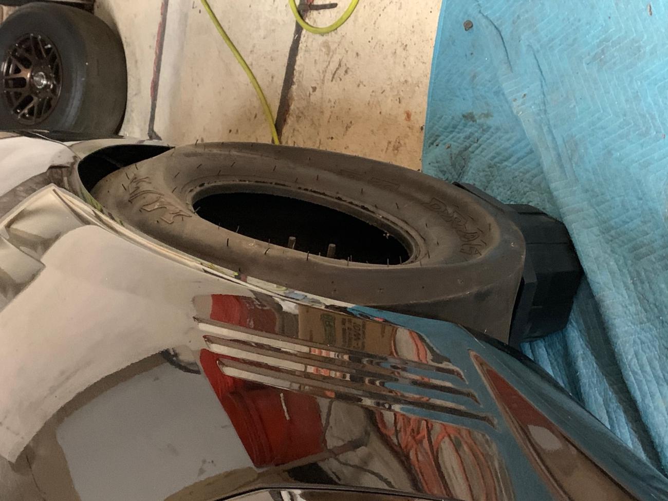

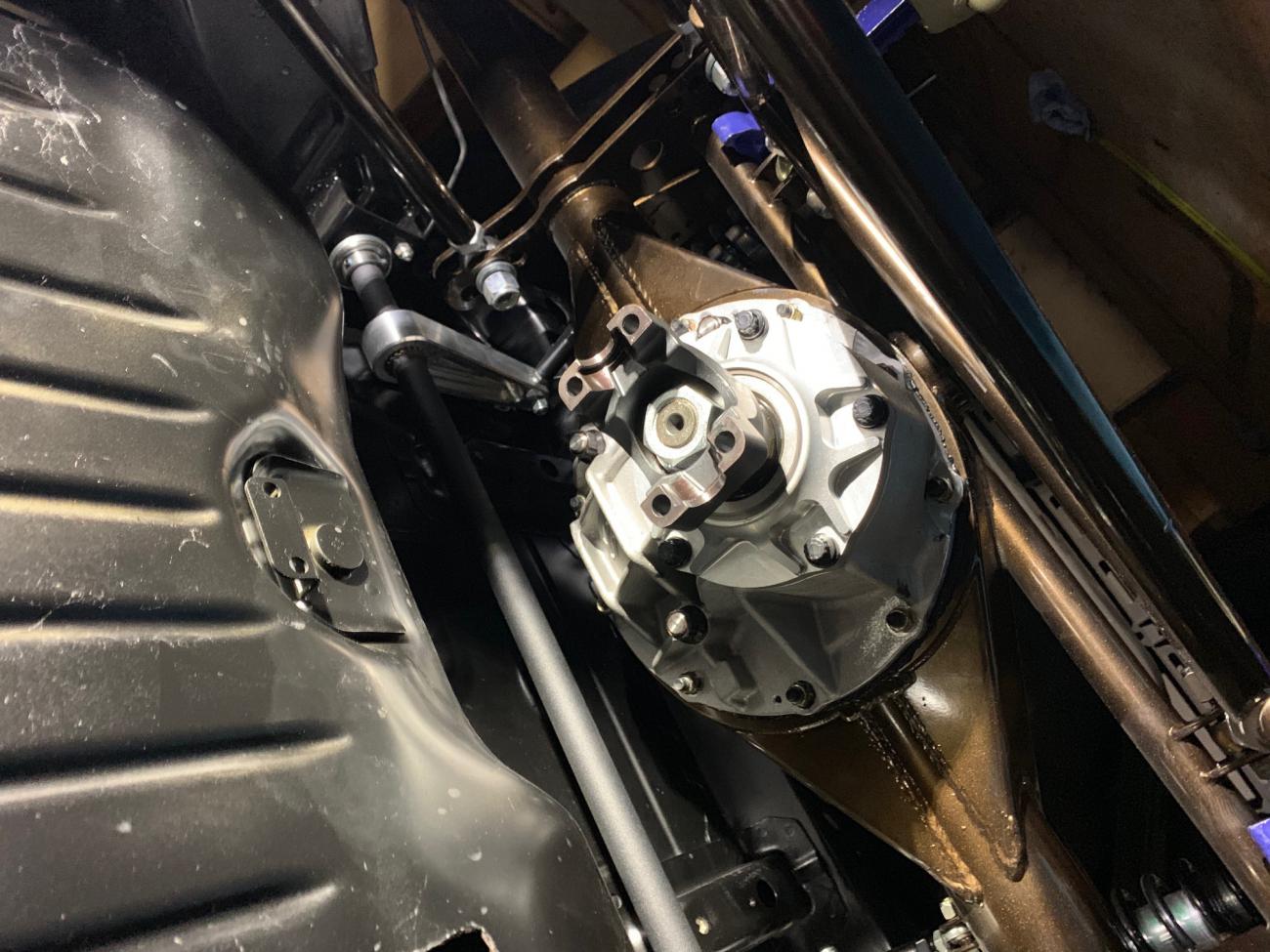

Now to the Expensive stuff
The car took a vacation with Nick Eggers @ PTS Fab in Forney, TX to get rid of its IRS problems. Out with the ZL1 diff combo 15" conversion and coilovers in with the only way to race noprep.
QP Fab 9" housing braced and gusseted for 1500+hp
40 Spline Axles from Moser/QP
Strange PRO HD 3rd member 3.89 gears
Aerospace Brakes
QA1 Double Adjustables valved for no-prep
PTSFab 4 link setup all chromoly with a bolt in cradle 100% stock replacement no cutting of stock chassis.
Punisher_ATX is offline   Reply With Quote

That rear suspension setup is bad ass! I want one for my PPV so bad! All you had to do was get rid of the fuel tank? Do they sell that as a kit?

Nick will be making this as a bolt in kit in the near future. Till then im sure if you contact him he can build you one on your car. But again not going into full production till my car is done and we can test it and make changes if needed.

How does the 4 link crossmember mount? I see that it attaches to the front cradle mounting points, but that can't be it. Does it tie into the cage, too?

2 mounts to cradle points and the other 2 bolt on where the fuel tank straps used to be.
