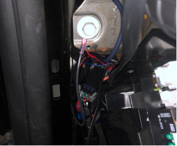

Step 1:
Decide where you are going to mount your Wot Box (I chose the driver side kick panel for ease of access to the serial port when I want to use the computer to change parameters).
**This step is just so you know how much of the wiring harness needs to be left in the car to make the connection. Since the kick panel needs to be removed anyway I did not mount the WOT Box until all of the wiring was done.**
Step 2:
Run the wiring harness for the Wot Box through the firewall at any place you desire (I used the spot on the top left drivers side where the main power feed comes through the firewall. There are other places you can route it as well.)
Since I am going to be tapping my Accelerator Pedal Position Input (BLUE), Clutch Wire Input (GREEN) and RPM Input (YELLOW) signals from the sensor harnesses I decided to mount the Wot Box on the drivers side kick panel for ease of installation and access.

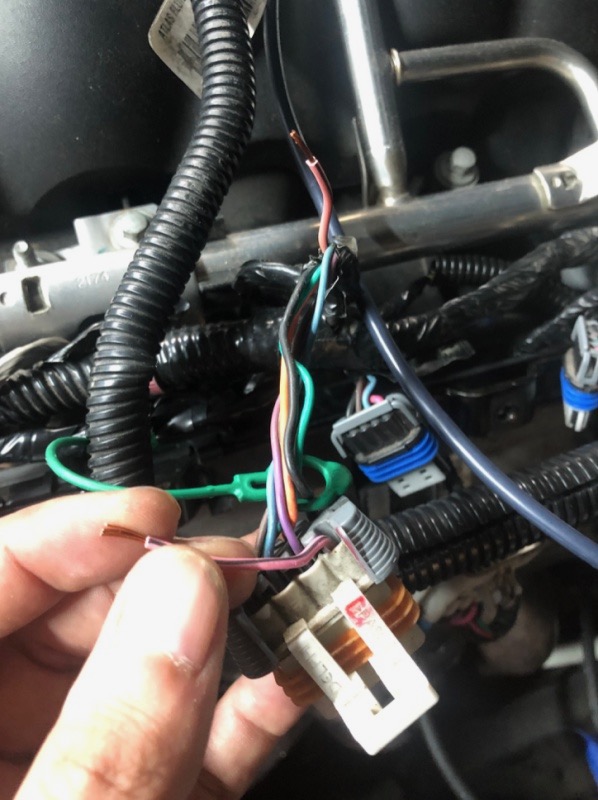

First we are going to run the YELLOW Wire (RPM Input) to the first ignition coil. You will be getting your signal from the Purple Wire (Pin C shown in diagram below- IC1 Control). I recommend cutting the electrical tape back before you splice into the wire to make it easier to hide. Solder and heat shrink or use heat shrink crimp connects to join wires and then re-tape harness.
Name:  WOT Box 2 - 1.jpeg

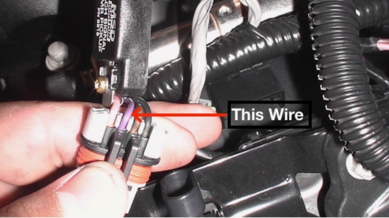

I could not get a good picture of the harness in my car due to a shift light that was installed on the same coil previously and the wiring was not up to par so I removed it to install at a later date and used a new coil harness so the wire is a different color. To save the confusion here is a picture of Ignition Coil 1 thanks to Moly1983 from the Camaro 5 forums:
Name:  WOT Box 3 - 1.jpeg
***[If you are pinning the Yellow RPM Input wire to the ECU you will use pin X2-70 ]***

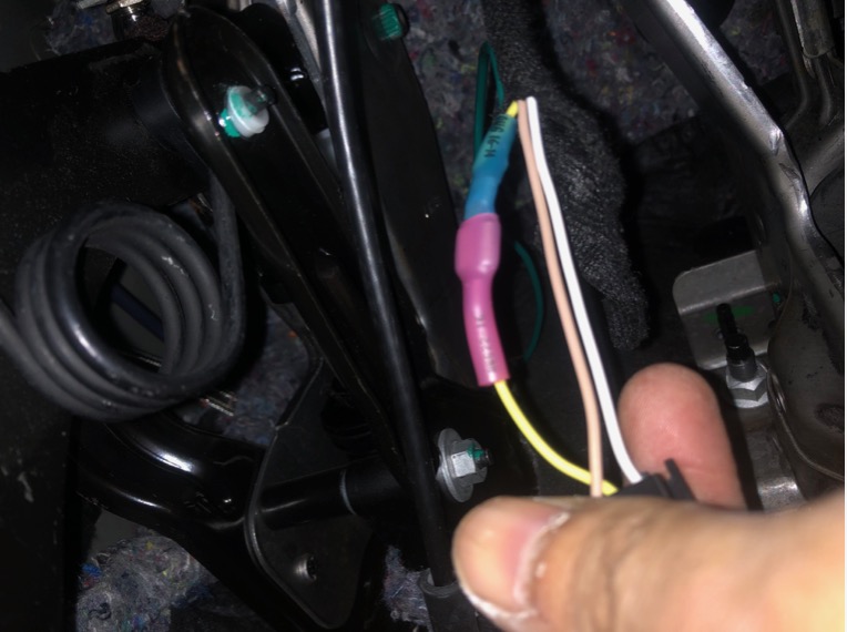

Now comes the fun part. We are ready to tap into the wires for the Clutch and Accelerator Pedal sensors. To access the wires we are going to want to remove the connections from each sensor. You have to depress the grey tab in the middle while pulling up at the same time to get the grey piece off. Once you do that you just push down in the middle and pull up and the connector should come right out. Practice on the Accelerator Pedal first because the clutch switch is a lot harder.
Name:  WOT Box 8 - 1.jpeg
Name:  WOT Box 9 - 1.jpeg
**Picture of the Clutch Switch Harness. Accelerator Pedal Harness is on top of the gas pedal, you can’t miss it.**
Once you get both connector harnesses removed you are now ready to run the BLUE and GREEN wires from your WOT Box. Determine how you are going to run the wires and cut them to length, then remove some of the protective wrap from the harness to make your splice. You are going to tap into the Yellow wire from the Clutch Switch Harness with the GREEN wire and the Light Blue wire from the Accelerator Pedal Harness with the BLUE wire from the WOT Box. When you are done: re-wrap the harness, connect the sensors and secure your wiring.

**Picture showing GREEN wire from WOT Box connected to yellow wire from clutch harness**
**[If you are pinning these wires to the ECU the GREEN wire from the WOT Box goes to the Yellow Cutch Switch wire pin X1-26 and the BLUE wire from the WOT Box goes to the Light Blue APP Sensor wire pin X1-32.]**
