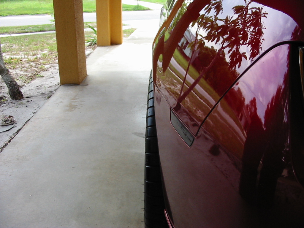

Here is the 315 on the 11 inch wheel from the back.
Attachment 1024512
These two pictures of his car are why I went with the sizes. Don’t regret it at all
Attachment 1024512
Just realized looking at the tread pattern that this pic is of the 335 MPSS's I had on there, still the 11 inch wheel though.
Thanks sir, Yea I love the new look. They get lots of compliments at the shows. Now I just need to take some new pics of the new tires on there I installed...275/35/20 front, 315/35/20 rear. They look really aggressive now... Car looks lower, and is in the front..
