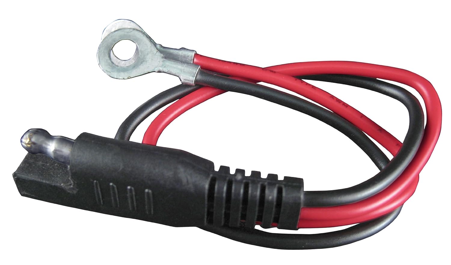

You should always charge right on the battery terminals. The engine compartment
post is a jump-start post. Trickle charger needs to be right on the battery posts
as well. You can install a connector that will hang out the RH side tail light cover,
for plugging the trickle charger into.
Make the wires longer, and run them out from under the RH tail light cover. I ran my
external rear LEDs that way.
When that pig-tail is not in use, then you put it under the cover. Then next winter,
pull it back out. Those covers will flex more than needed for that.
