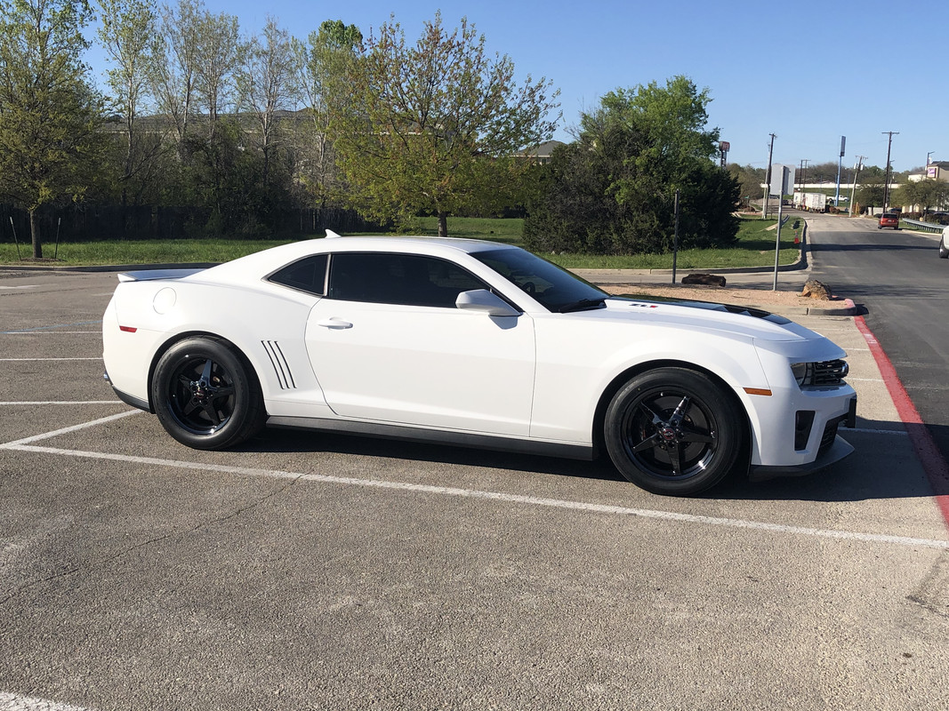

Edit: I just ordered 305/45 R18 on the rear and 245/50 R18 for the front based on user mlee's setup on page 7, hopefully there will be no issues.
I could never find this setup on a White ZL1 so here is the final result for anyone who is interested!
I just ordered some Dark Star 18x8.5 and 18x10.5 wheels, my ZL1 is stock ride height and I plan on ordering a NT555RII 305/45 R18 for the rear but I am totally stumped on what to get for the front without setting off all the alerts for height differences.
Was hoping to be able to order a NT555 G2 for the front for a more daily driver setup.
Anyone have any idea what size to get for the front? Or if I have to change the rear size to make it work?

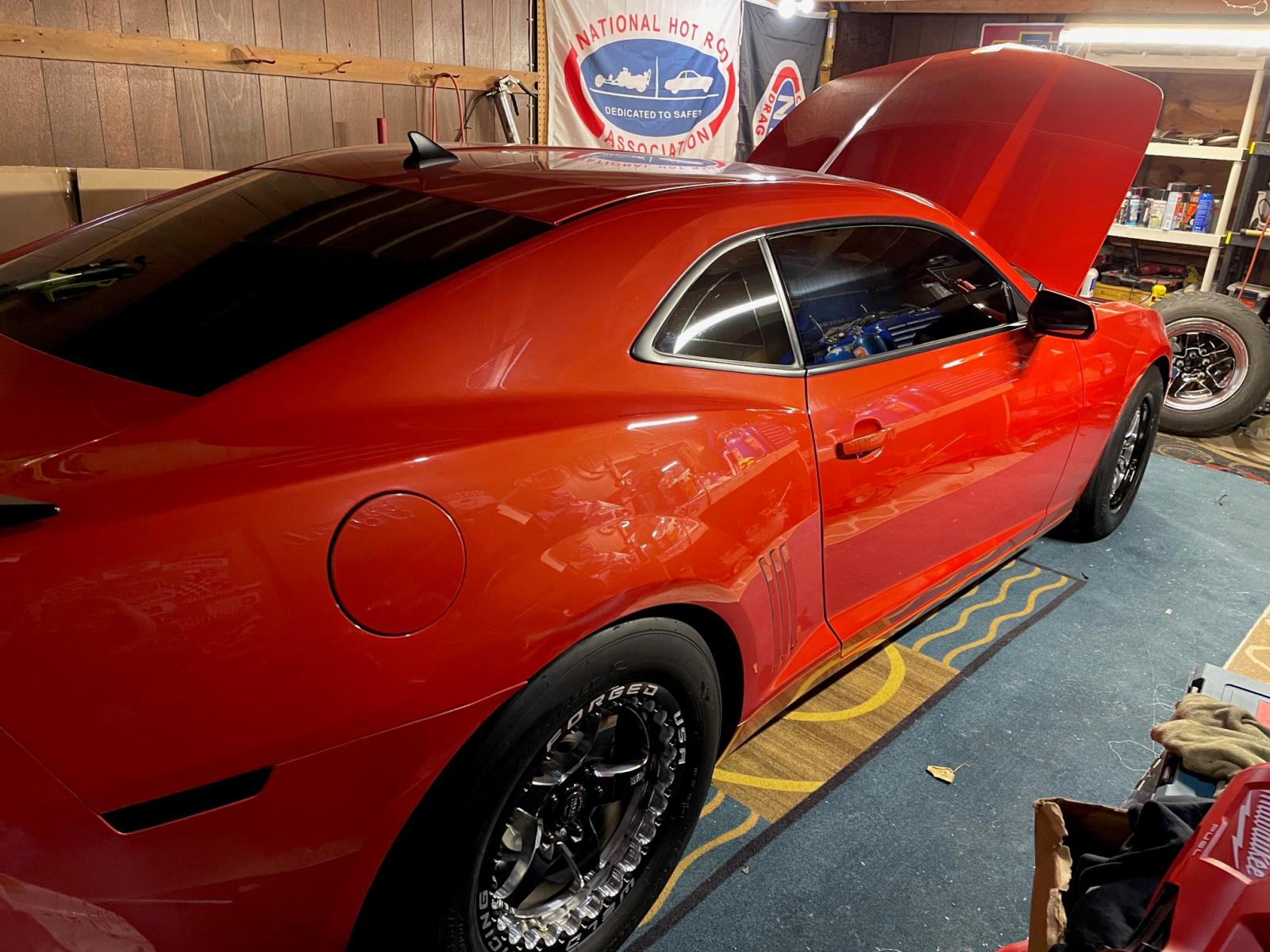

RC Comp exile -s fronts
Just did RC Comp Exile-s to the front and weld s71 bead locks rear. Fronts require longer studs and a 3/4 cnc spacer. [ATTACH][ATTACH]Name:  car 3.jpg
Size:  245.0 KB[/ATTACH][/ATTACH]

Whats rear back spacing? Thanks
Originally Posted by shock69 View Post
Just did RC Comp Exile-s to the front and weld s71 bead locks rear. Fronts require longer studs and a 3/4 cnc spacer. [ATTACH][ATTACH]Attachment 1089267[/ATTACH][/ATTACH]
